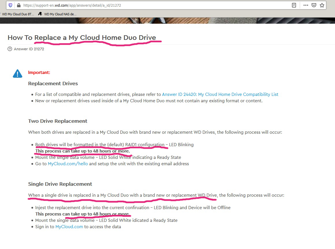

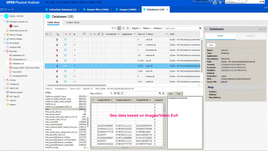

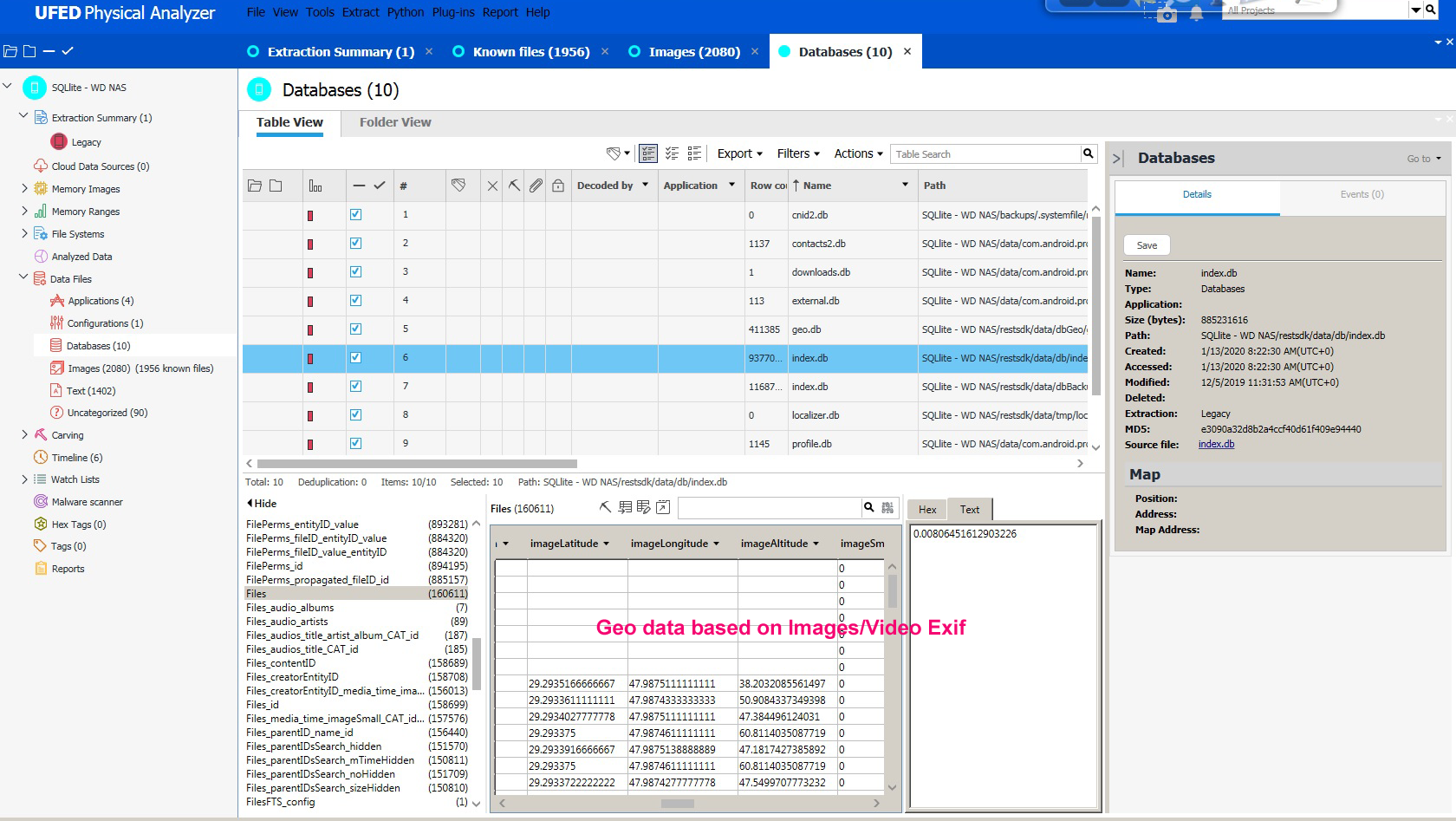

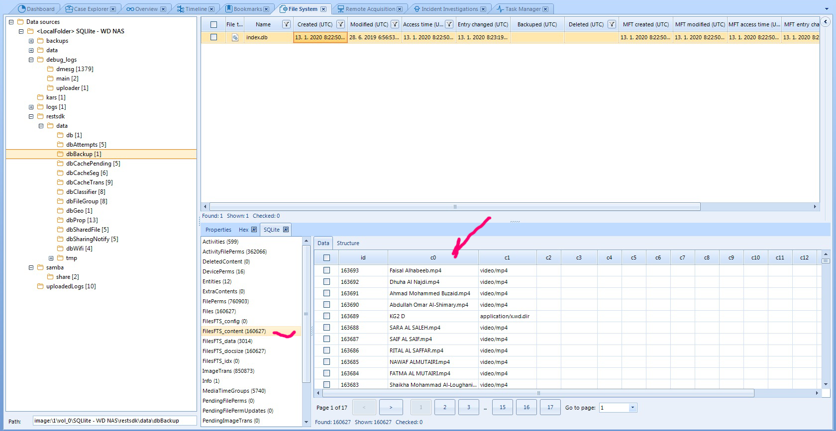

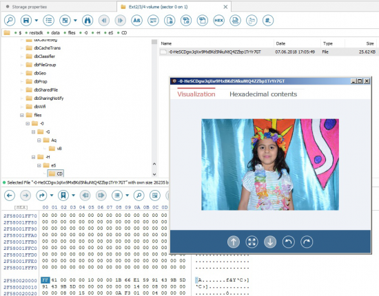

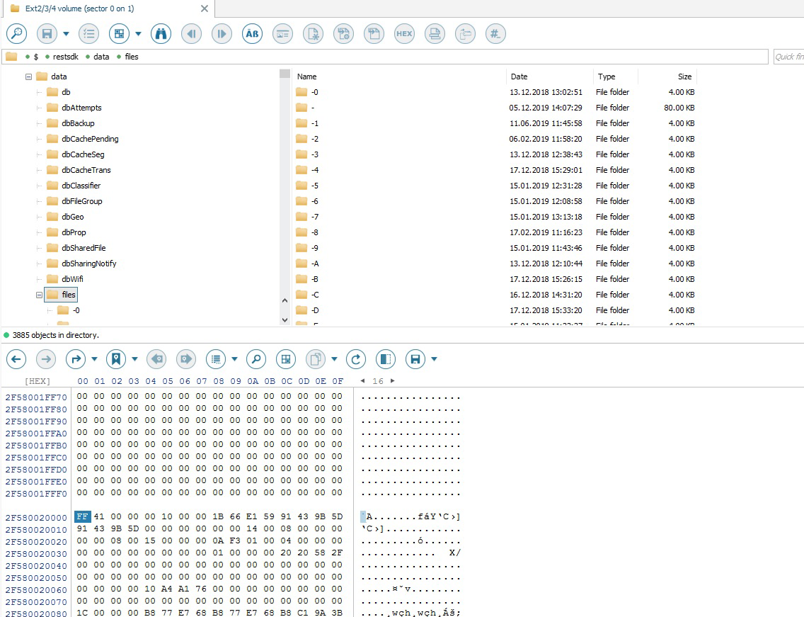

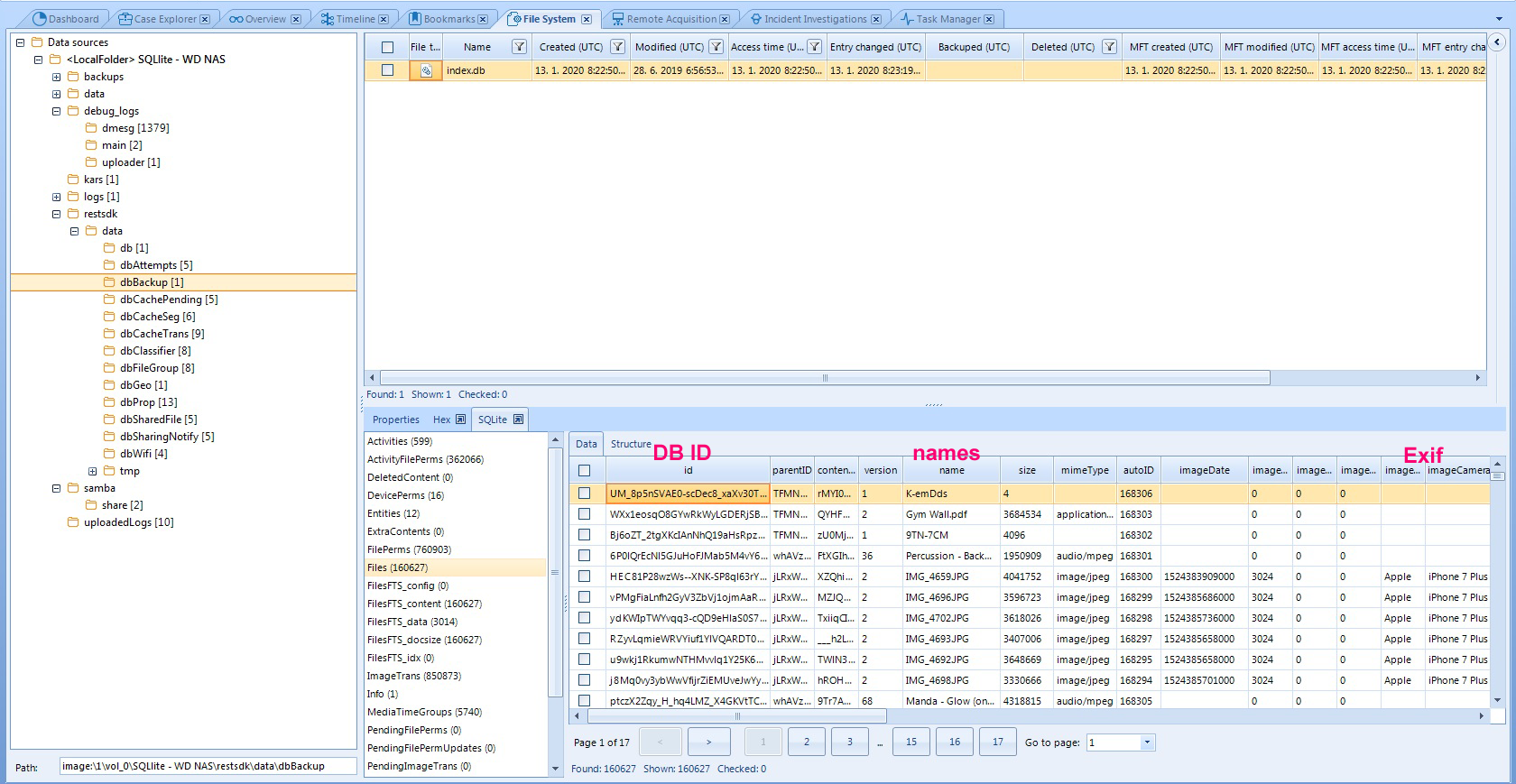

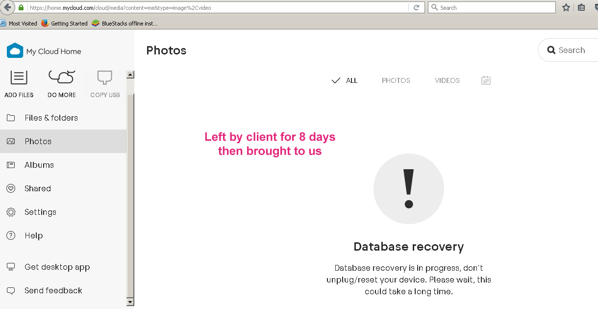

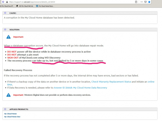

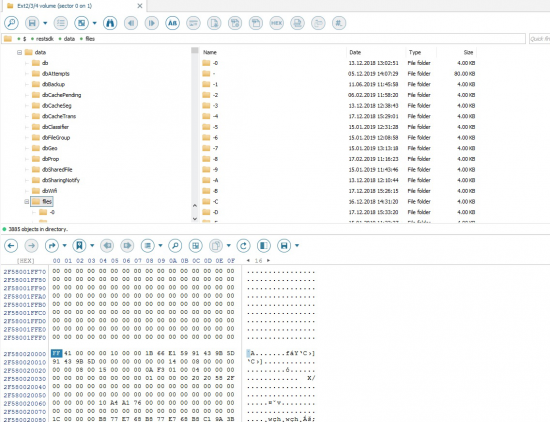

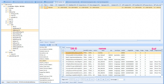

Well, i guess most of you know know this storage and in order to use it you must:
1- Be Online
2- Register your product @WD
3- Activate & MAP your unit to the network
(probably whoever came with this silly idea been kicked out by now)

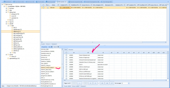

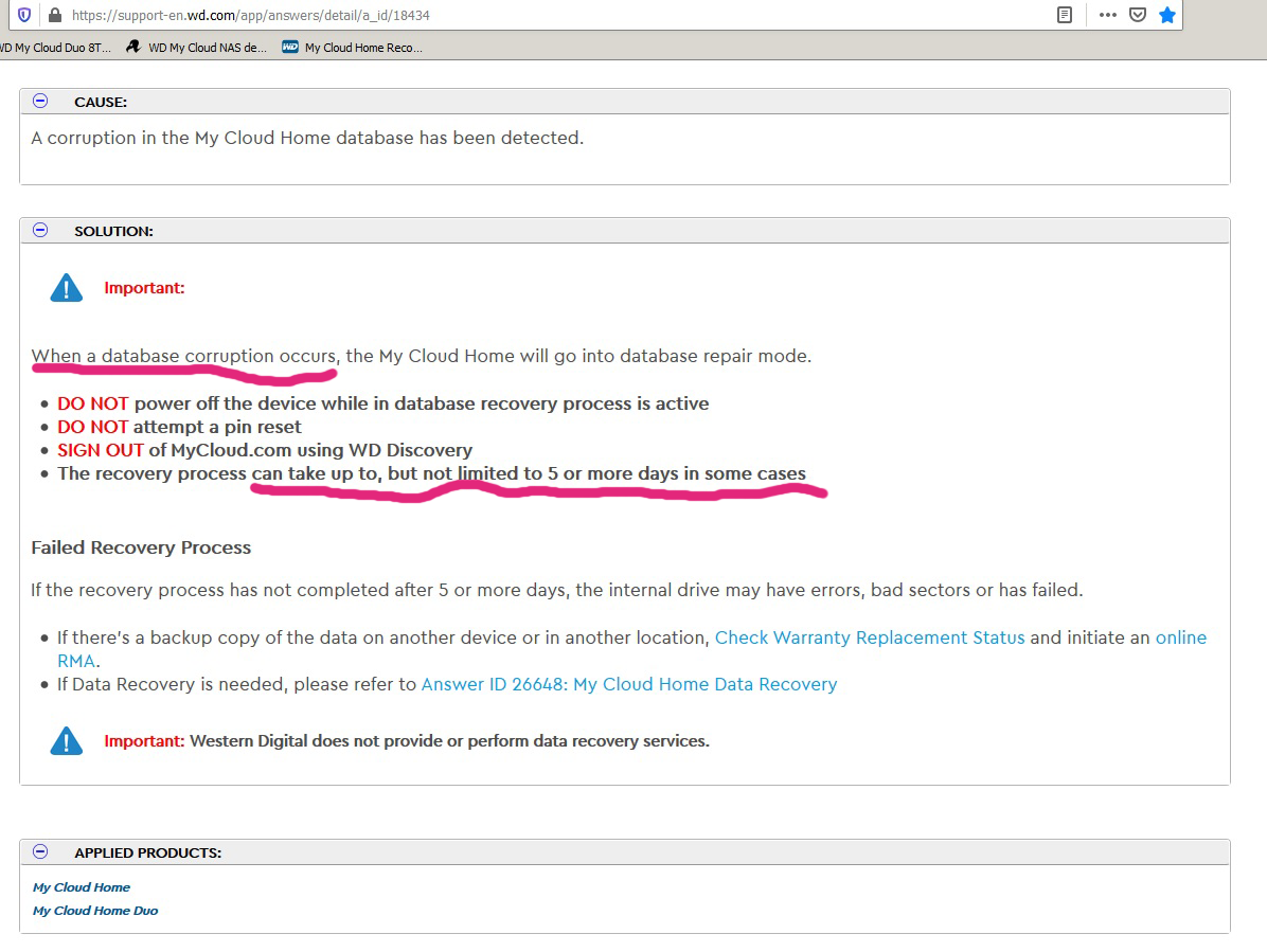

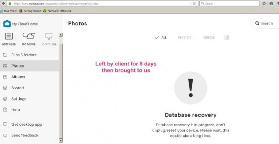

The problem is when you have a bad DB (SQLlite) file which stores all of those info/data
thats why this storage is too damn slow in transfer

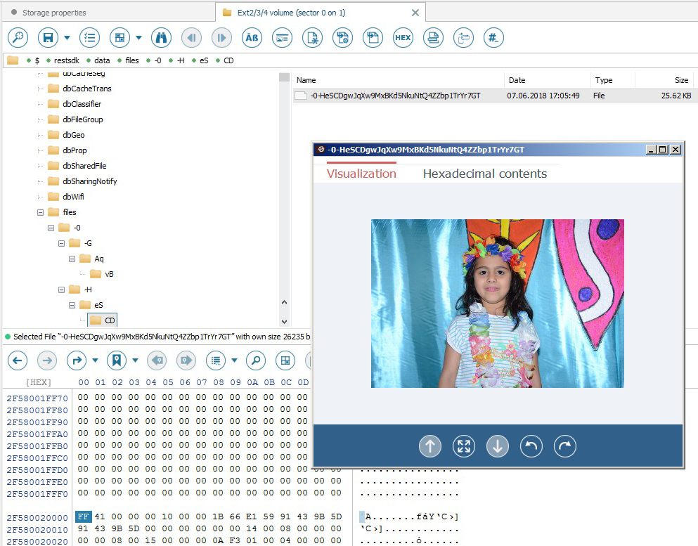

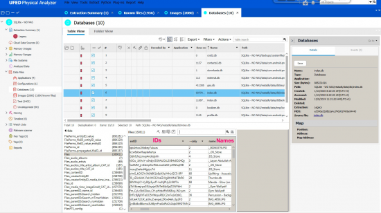

i wrote a small prog to recover user folder tree from the db of the mycloud...
tell me if you are interested...

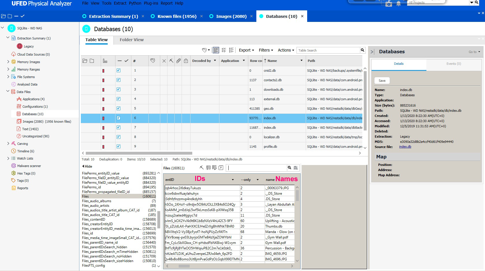

Thank you pepe,,, problem solved already
The reason why i posted it here is only to Explain why this My Cloud is so slow,, coz its collecting INFO about your data (for no reason) and sorting it on a DB file
with very LOW profile processor to handle.

I am having the same issue here it shows like this
https://forum.hddguru.com/download/file.php?id=19490&mode=view
is there any way to recover the user folder tree?
 Post subject: Re: WD My Cloud Home Due - The ugly storage
PostPosted: December 1st, 2020, 12:02
If you are running a relatively new version of UFS Explorer Professional, there should be a context menu to handle it.
