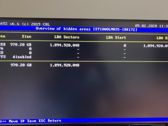

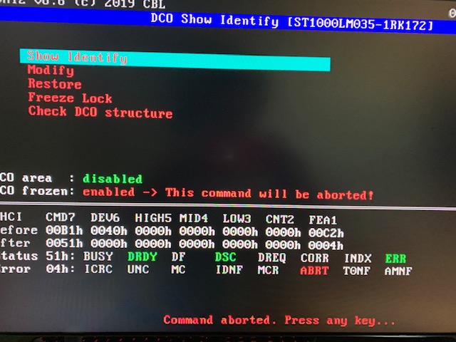

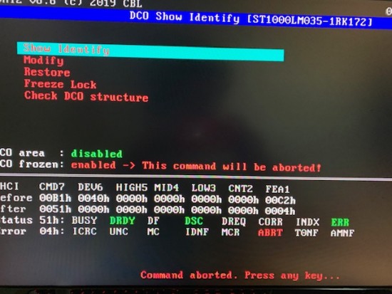

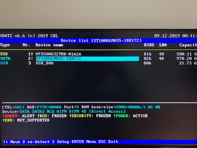

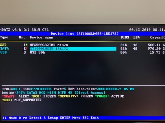

Thank yor for the reply. I tried hdat2 and victoria but both of them did not show the right capacity of the hard drive.
I have some screenshots of hdat2, could you see anything wrong with these parameters?

Q2: How to bypass a Security and/or DCO frozen state?
https://www.hdat2.com/hdat2_faq.html#q2

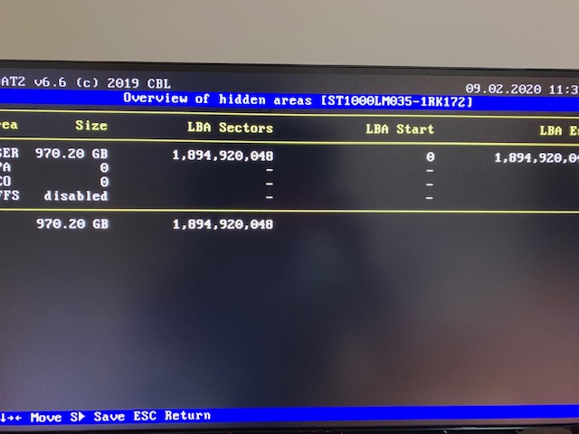

I bypased the frozen. But hdat did not detect a dco hidden area.
