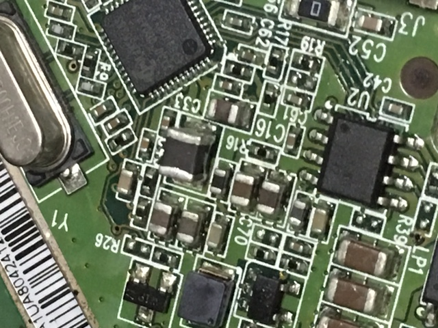

It's the HDD (My book essential) I used, but it's hard to turn on the power, and finally I can't turn on the power.
According to the investigation, it seems that 5V, 2.6V and 1.0V power is not supplied before U3 (IC).
The LED flashes if the power is not turned on for a while, but the power is not required.
Do you have any good advice?
Thanks for reading.
I hope it will give advice to other people in need.
Q2 (0v, 2.7v, 0v)
R90 (5.17V, 5.17V)

See …
http://www.hddoracle.com/viewtopic.php?f=112&t=1032

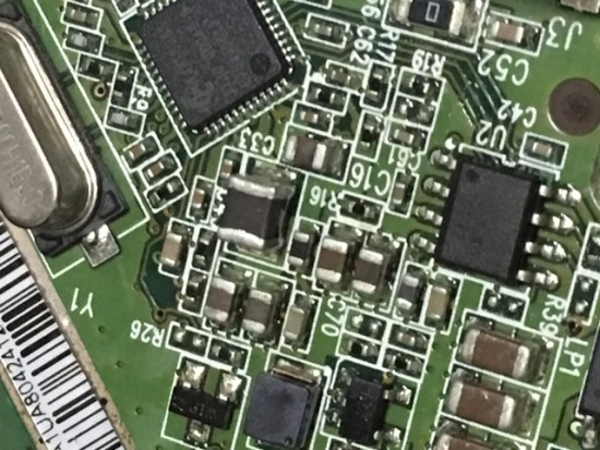

Looking at the U3 (RT8060) data sheet, I feel that the resistance value from LX to FB is low.
LX-FB: 76KΩ (Good: 81k)
LX-GND: 26KΩ (Good: 34.4k)
I'll investigate a little more.

The 5V supply is OK. This supply then powers up the Vio regulator which generates the Vio supply for the bridge IC. The bridge IC has an internal PWM controller which then generates the Vcore supply from Vio.
So measure the voltages at the two smaller inductors. They will correspond to Vio and Vcore.
