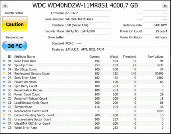

Here is a WD40NDZW that has racked up 50,392 reallocations (= 6299 physical sectors):
The normalised value has dropped from 200 to 182, so this suggests that the drive is spec'ed for 20,000 reallocated physical sectors.
    50392 / 8 / (200 - 182) x (200 -140) = 20997
    50392 / 8 / (200 - 181) x (200 -140) = 19892
Seagate has been doing this for many years, but I hadn't noticed that WD's drives had also gone down this path.
Is that how this works with 4k sectors? I didn't know this.
I assumed so, but now I see that the pending sector count is 10 which is not a multiple of 8. :-?
The drive in the following thread does seem to fit my assumption, though:
https://forum.hddguru.com/viewtopic.php?f=1&t=41771
This WD40NDZW SMART report suggests that attributes #5 and #196 count logical sectors whereas #197 counts physical sectors:
https://bbs.archlinux.org/viewtopic.php?id=260538
Device Model:     WDC WD40NDZW-11MR8S1
  5 Reallocated_Sector_Ct   0x0033   198   198   140    Pre-fail  Always       -       304
196 Reallocated_Event_Count 0x0032   001   001   000    Old_age   Always       -       304
197 Current_Pending_Sector  0x0032   199   199   000    Old_age   Always       -       883
