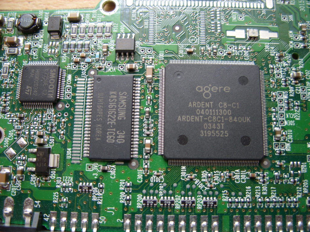

If any one can help me it would be greatly appreaciate, i am looking for a pcb for a Maxtor Diamond Plus 9 80GB ATA HDD.
The board is a CALYPSO III, the numbers of the HDD is 6Y080L042201 anyone know the whereabouts of finding one please let me know, email me dp@sowah@yahoo.co.uk.

tell me the number on the cpu like Ardent c5-c1

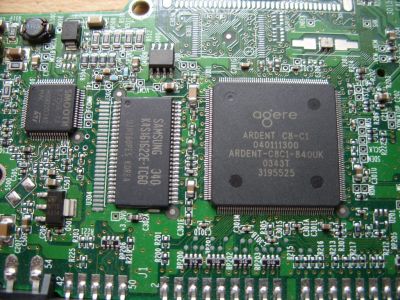

Hello the number on the CPU ARDENT C8-C1 04111300, ARDENT-C8C1-840UK
0343T 3195525.
DP

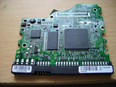

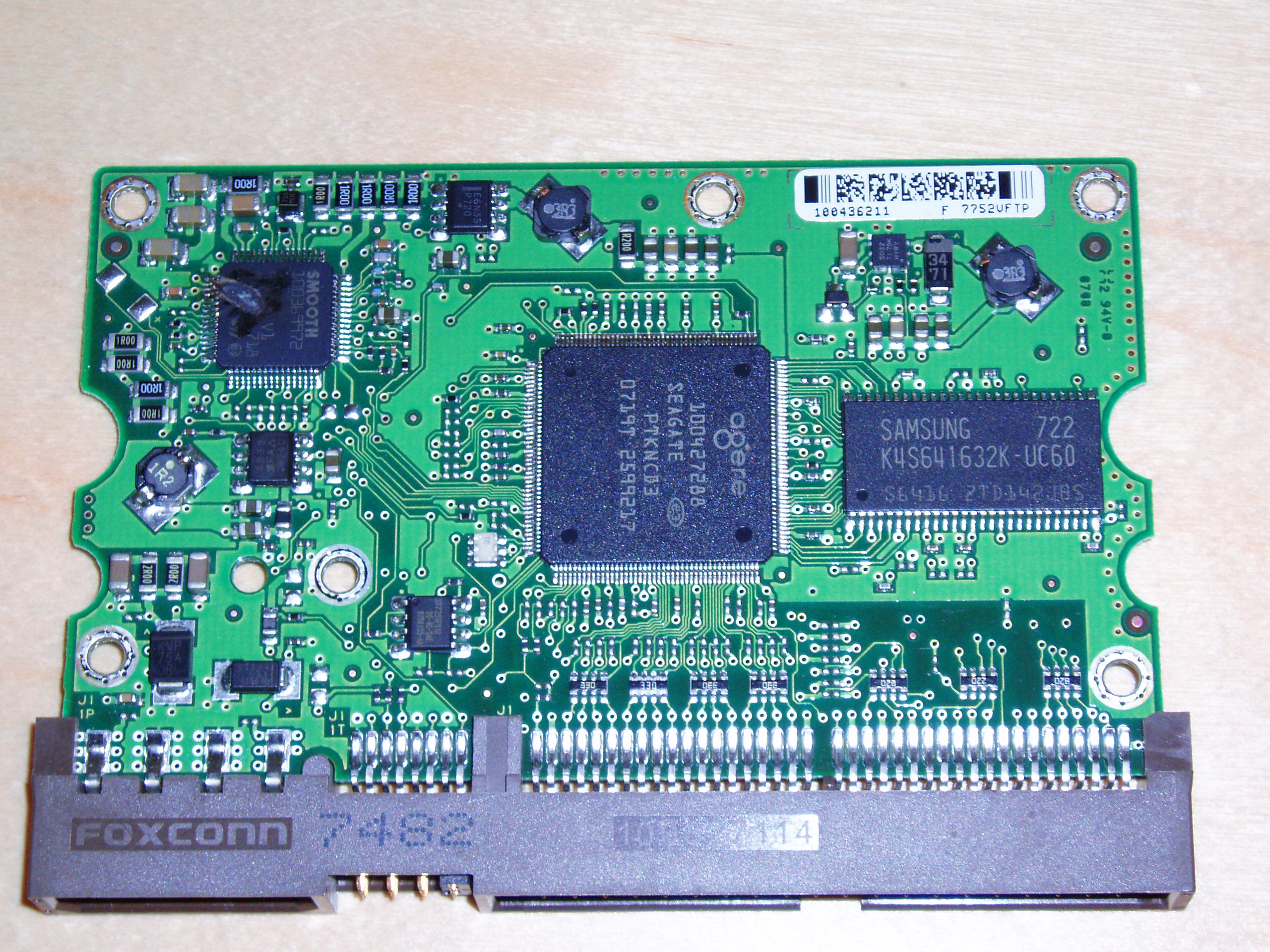

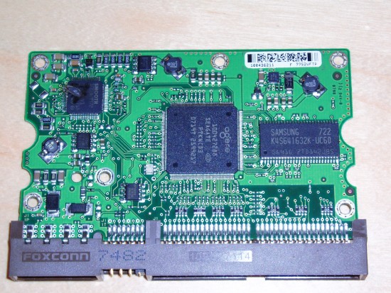

hi mine looks different says foxcom 7482 on it ,can anyone help?its just a rectangular board with the smooth chip on the left then the big square one agere then the samsung one on the left .
 Post subject: Re: replacement PCB for Maxtor HDD
PostPosted: November 18th, 2008, 11:07
Posts: 2984
Simply match F4FYA from PCB label

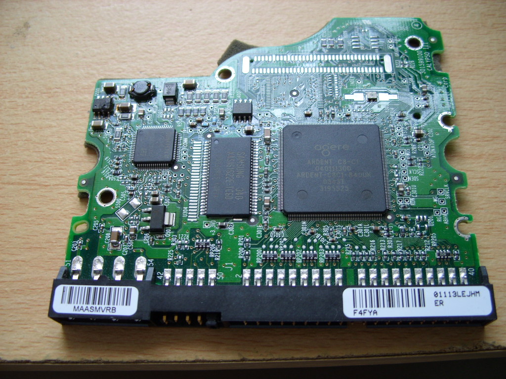

this is a picture of mine
PostPosted: November 23rd, 2008, 7:30
Joined: May 5th, 2004, 20:06
Posts: 2782
Aha is one of those 1/2 Seagate 1/2 Maxtor drives :O)

the model number of the drive is STM3250820A
this is a maxtor diamondmax 21 , 250gb drive ,

this is a Seagate drive.

i have found a used hard drive number of the drive is STM3250820AS ,can anyone tell me what the S on the end means?as this is the only difference ,ok thanks

S = Sata drive

hi thanks ,would the pcb from this fit into mine? as mine doesnt have the s on the end,ok thankyou
