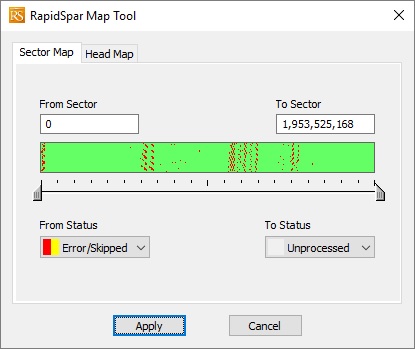

Here is a neat Mini Image of the Sector Map from a single pass (skip bads) cloned drive.

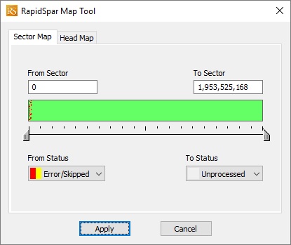

Here is an updated map after a balanced setting cleanup.

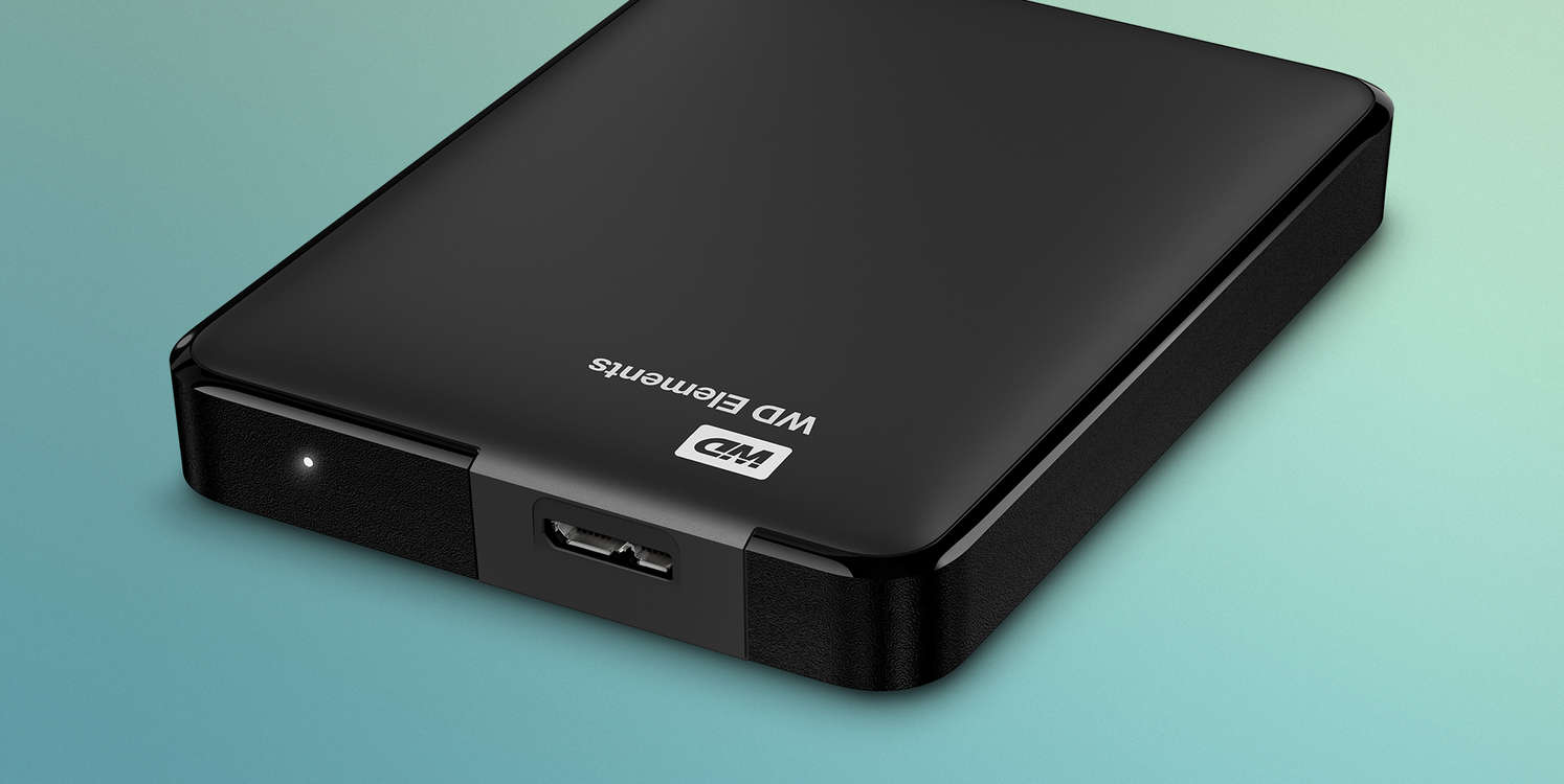

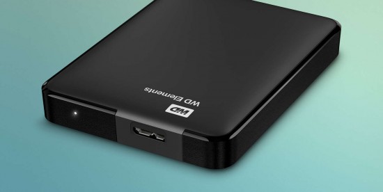

WDElementsPort_05_EnvironmentalTile_1920x964.jpg.imgw.1920.750.jpg [ 45.07 KiB | Viewed 27817 times ]
Hey Guys,
Just wanted to know if the RapidSpar has a USB adapter that will work with WD USB Drives?
See attached Image
 Post subject: Re: RapidSpar Update
PostPosted: August 16th, 2017, 10:50
datahero wrote:
Hey Guys,
See attached Image
No, you would need it's big brother, DeepSpar Disk Imager, with the USB add-on. Or, you could convert the drive to SATA and work with RapidSpar with different methods, depending on built-in encryption.

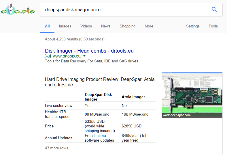

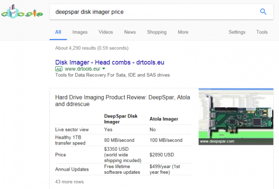

LMGTFY
