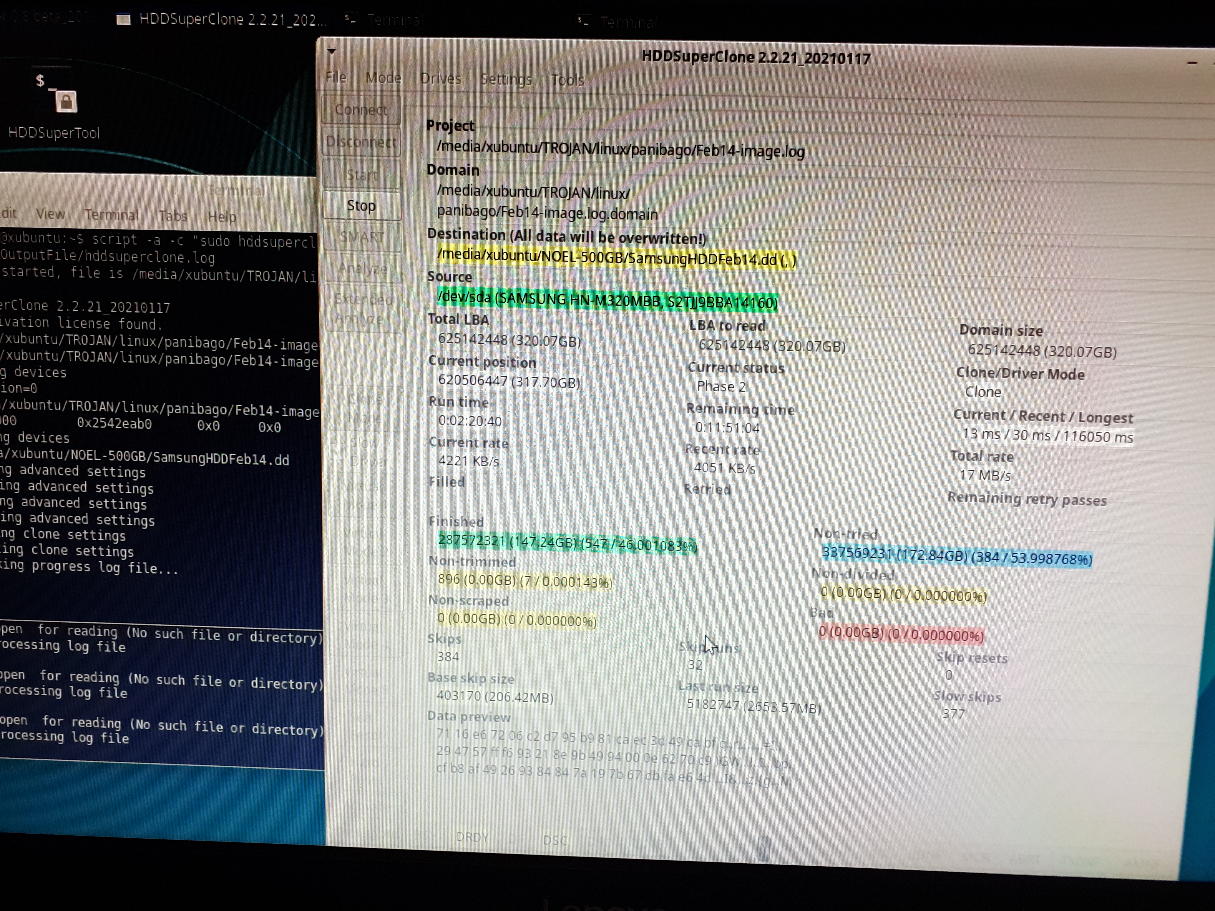

Hey guys, I'm currently using hddsuperclone, and all these are for recovering (slightly really) important files + learning value for me.
My current destination drive seems to be slowing down my 20% completed cloning process because I had it connected via USB instead of SATA.
or maybe I also suspect my current destination drive is just by itself slow or maybe failing now. (It's inside an enclosure I cant seem to open easily which I cant connect via SATA)
Will it be a better option if I get a new destination drive and continue cloning the remaining 80% for me to be able
to connect it via SATA? Will the data still be intact even if the destination has changed?
Can I also switch modes if I think the cloning is too slow?
When do you decide to switch to a different mode?
Here are some pictures that may help as honestly I don't know how to interpret these data
https://imgur.com/a/ZF6AShy
^ SMART
https://imgur.com/a/BZqbZkZ
^ Clone Settings for 1st Pass, I increased cluster size and Skip Size to 16384 because the manual says so for Samsung drives.
^ I used the Analyze function but I forgot to select the destination as null, is there any chance that will mess up my drive analysis?
From the analyze results it looks like the source is the cause of any slowness (possible slow responding issue, but it ran out of time to perform a significant test so I can't be sure). Plus I see you are using the reverse option, which usually slows the reading down by about a factor of 10. Maybe there is something else I can't see about the destination that you can see that is causing it to be even slower.
You would either need to clone the first destination to the new destination before continuing, or start over.
Yes, you can switch modes. But unless you have the paid version, you are limited in your modes, and the default auto passthrough mode will pick ata passthrough if the drive is connected via SATA, which is the best free mode.
No, you can use the normal destination when performing the analyze function. The only reason you would use the null destination is if you did not yet have a destination, and were just performing the analyze to assess the drive, and were going to start over with a new progress log for the actual recovery.
It would help more if you included a screenshot of the actual recovery, or better yet attached the progress log.

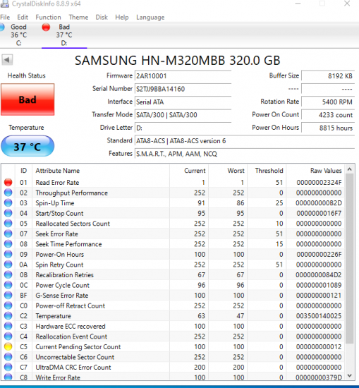

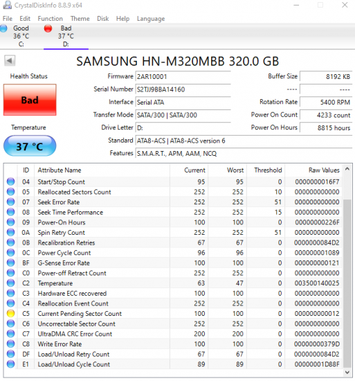

Wait, I forgot to add. I suddenly remembered these.
Maybe these will provide some useful information.
This was the smart CrystalDiskInfo from Windows of the Samsung Source drive back when I haven't heard of hddsuperclone yet.

The SMART status just indicates that the drive is failing. But you already know that. There is nothing else useful about it, as it is not capable of providing any info on what the failure actually is.

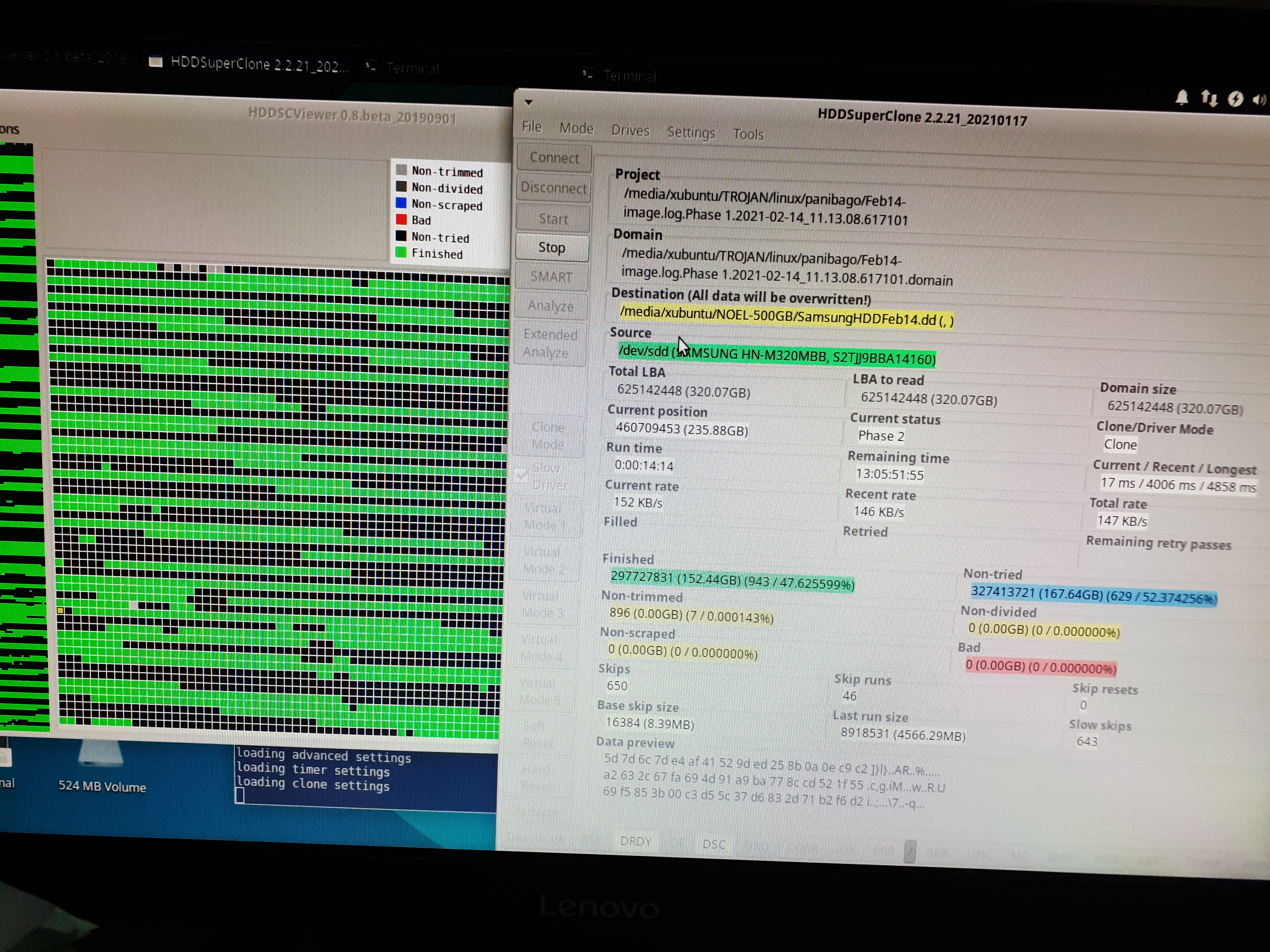

Here's what Ive done so far after so many hours of reading forum posts
Screen display of 1st run (2 hrs in)
so....after a couple of hours cloning, a power outage shut my computer off and I'm not quite sure to what position it stopped after the sudden shutdown. But it seems the drives are still functional after the incident

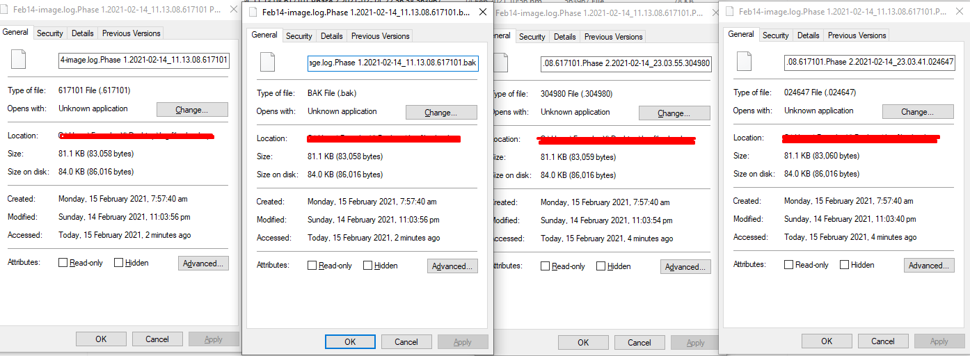

Here appears the new weird progress log filenames after repairing them via hddsc.
This is where I got confused, how do you differentiate which is which?
For the 2nd run (the run after power outage), I picked the only remaining ".bak" log file
"Feb14-image.log.Phase 1.2021-02-14_11.13.08.617101.bak" because it seems the most recent among the four.
What's the difference of this with the ".617101" log file anyway?
Screen display, 14 mins after the power outage (2nd run)
Screen display, 5 hours after the power outage (2nd run)

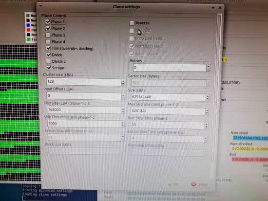

The skip size has also increased even though I didn't change it, how did this happen?

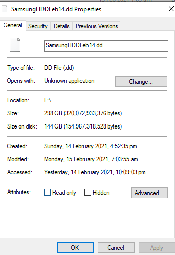

Why is the "size on disk" smaller than the actual file size, is this normal?
I stopped doing the whole process because it's current rate now slowly transfers at only 50-600 KB/s.
Is there any way to speed up this process?

TL;DR
Head - looks weak rather then completely dead though, you may get lucky if you just wait it out. Untick the scrape/divide/trim, Id bump the skip threshold to 5000 and fully complete phase #2 if you haven't yet. Phase 3 even with the default settings will show if the head is dead or not if none of the black area gets filled in the first 20%. If you start getting data in the skipped areas we can tweak the settings to balance performance / recovery, 50-600K is far better than nothing and a lot cheaper than a head swap.
 Post subject: Re: Samsung and HDDSuperClone concern
PostPosted: February 15th, 2021, 10:08
Posts: 992
If you look closely, the phase log file name tells you what phase it was at the end of (or currently in if the program was stopped), and the rest is a date-time stamp, so you can tell exactly what time it was written (down to the microsecond). And if you had to use one for recovery because the original was lost, you should have made a copy of it and then renamed the copy to the original name. You are making a mess of file names that is hard to understand. And when you lost the .bak file, what about the original file “Feb14-image.log”, did you loose that too?
The skipping algorithm changed the skip size. The original size is still remembered in the settings in the log, as the min skip size.
The size on disk is smaller because of how the writes are done. The file is “sparse”, meaning the 52% that has not been written. If you were to read an area of the file that has not been written, it would read as zeros. If you make a copy of the file, the copy will inflate to full size.
You need to uncheck Trim, Divide, and Scrape. When I said to only do phases 1-2, I meant uncheck ALL of the other phases. If it has got into trimming, you need to stop. If not, then uncheck everything except phase 1-2 and continue until phase 2 completes. Phase 2 is a compliment to phase 1 to get the most data out of the good head.
More in another post after I look at the log.
http://www.hddsuperclone.com
Home of HDDSuperClone
PostPosted: February 15th, 2021, 11:45
Posts: 992
Lardman wrote:
TL;DR
I don't agree with bumping up the skip threshold, that will stop skipping and defeat getting the most good data first, and make the rest of phase 2 take much longer.
Once phase 2 is complete, then you should uncheck phases 1-2 and check phases 3-4. It may then also be time to test whether or not increasing the clustersize helps or not. Run it for a few minutes and watch the speed and read times, then jump the clustersize up. Try doubling it at first, and if it helps keep doubling it until it either doesn't help or you hit the maximum. You want the read speed to increase significantly, but the read times should not go up much. If it doesn't help (or makes it worse), then you probably should turn it back down.
If it does help, you may get a decent read speed. The very beginning of the drive is the worst, but after about the 7GB mark it gets better and seems fairly consistent. Keep that in mind when adjusting the cluster size. Once the position is past 7GB you should be able to see any difference when adjusting.
PostPosted: February 15th, 2021, 12:01
Posts: 992
When changing the clone settings (unchecking and checking things), a side effect will be that the min skip size will be overwritten with the current skip size. So before you start phase 3, you will need to change the skip size back to original.
I think I need to figure out how to fix that so it only changes the min skip size when the skip size is changed by the user, instead of when any of the clone settings are updated.
