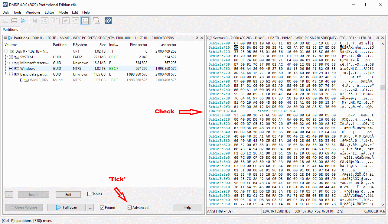

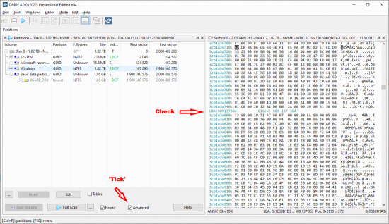

Can you check with DMDE, just select drive (or image file), does it detect any partitions (without scanning it)?
If not, tick advanced checkbox, now in hex view scroll down, does it see any data at all?
