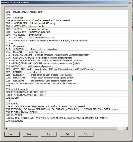

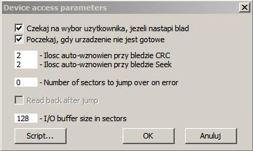

The new power supply controller is already in beta testing. Work in progress on the program manager for DOS. Tile is a Polish production. It is much more extensive and secure.
DMDE is able to handle the PWRCTRL. Already in beta DMDE is able to set scripts on how to read the disk.
