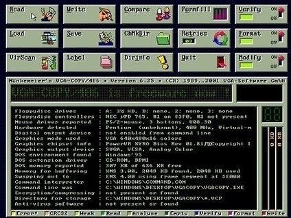

The best software to recover / copy floppies I know is VGAcopy/386, you can download it here (freeware):
https://moenk.de/index.php?serendipity[subpage]=downloadmanager&thiscat=2&file=1
