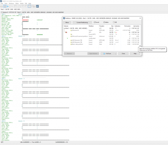

Can you show us the Partitions window in DMDE?

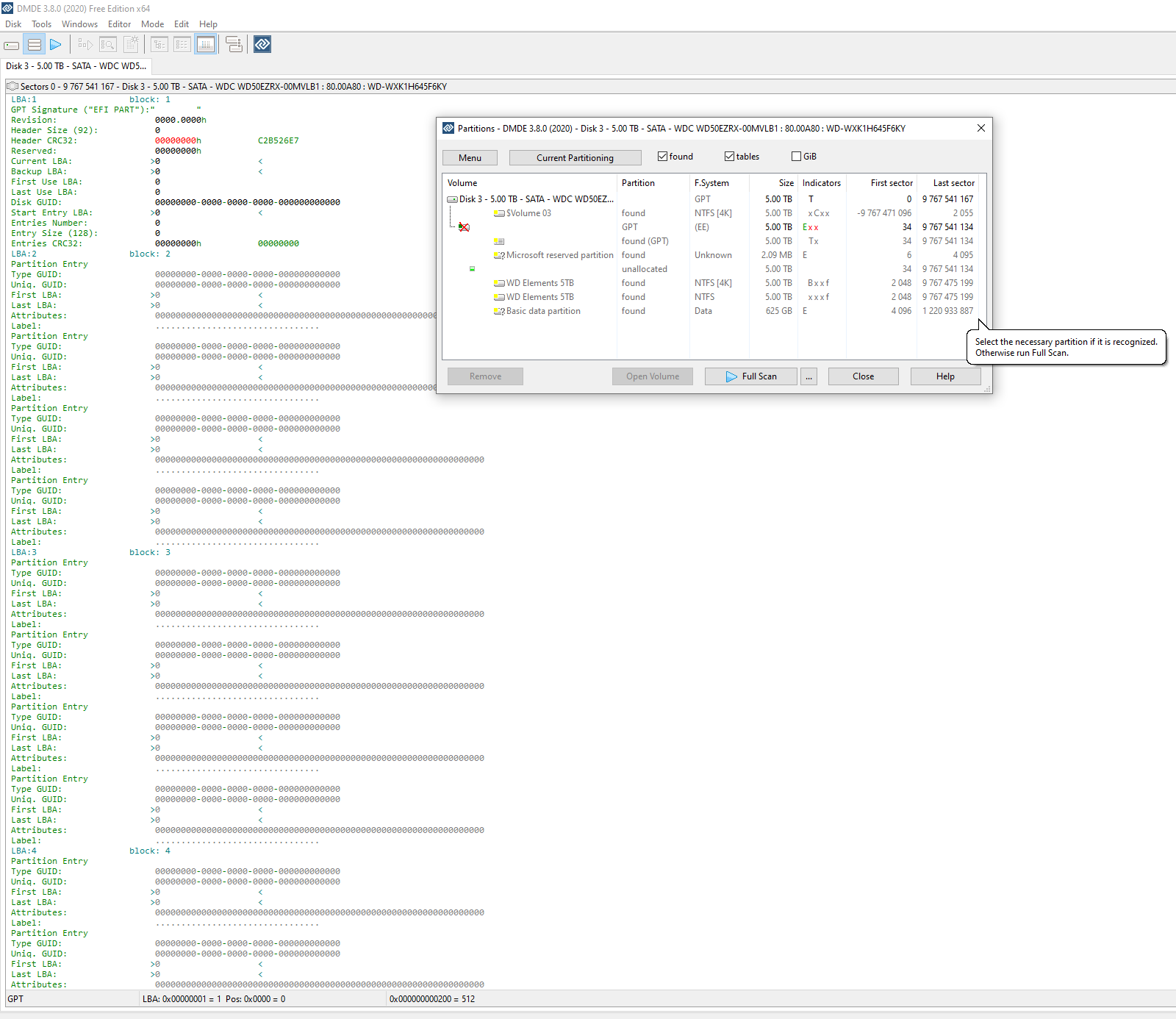

I do not know the program you mentioned is this corrent screenshot?
Thanks.
File comment: dmde screenshot
 Post subject: Re: HDD partition is gone need help recover the partition
PostPosted: January 20th, 2022, 12:18
Posts: 17137
Your Elements enclosure is configured with a sector size of 4KB. Your new enclosure is 512B. You need to return the drive to its Elements enclosure and show us the DMDE Partitions window again.

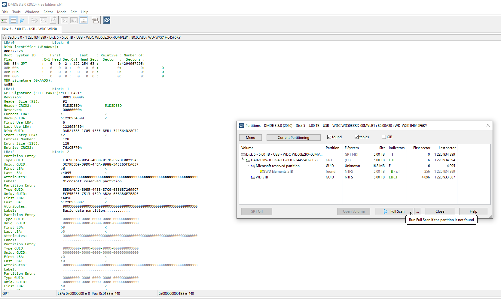

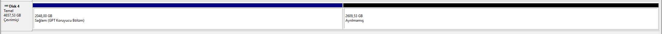

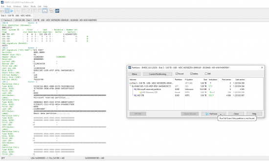

I do not understand it was on the same enclosure that the whole partition was raw without filesystem and now i put it back it looks like it works...
The partition is back.
Why it went raw i do not know but why it did not run as directly connected sata is it possible for you to explain it to me?
What should i do so this never happens again?

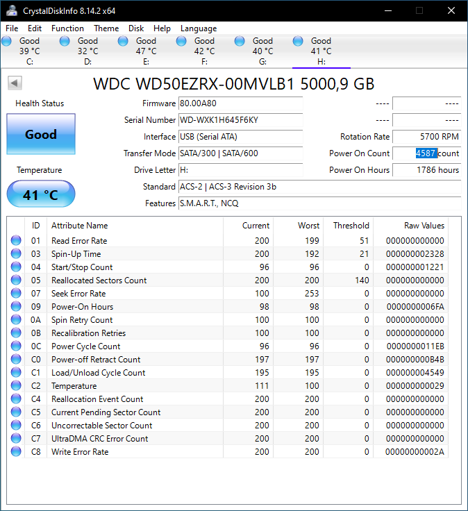

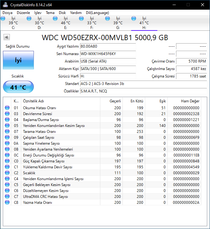

You need to examine the drive's SMART report with a tool such as CrystalDiskInfo. I expect that you will find reallocated, pending or uncorrectable sectors.
Your Elements enclosure has been configured with a sector size of 4096 bytes. The hard drive, on the other hand, has a logical sector size of 512 bytes. When the HDD is inside the enclosure, there is a USB-SATA bridge PCB which translates the sector size from 4KB to 512B. When you remove the HDD from its enclosure and connect it directly to a SATA port on your computer's motherboard, you expose the drive's 512e sector size and render your data inaccessible. Essentially you now have a 4Kn file system on a 512e drive.

The screenshot is attached it looks look doesnt it? Is there any reason to not trust this drive with data anymore ?
Can i set a drive 4k as sata 512 ? I want drive to work on both this is weird for mebut thanks to you I understand it now.

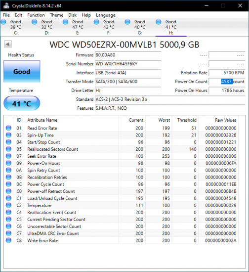

I just realized different language.

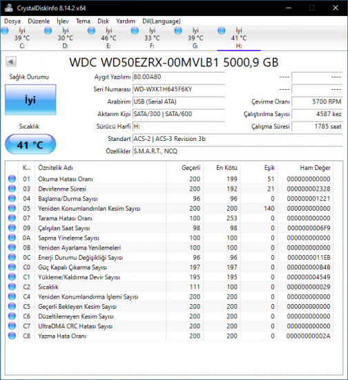

Sorry. Added the english crystaldiskinfo. Does it look problematic?

SMART looks good.
WD has a "quick formatter tool" that can change the sector size of WD's enclosures. Backup your data before doing this, though.
