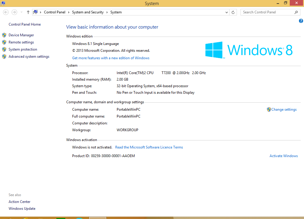

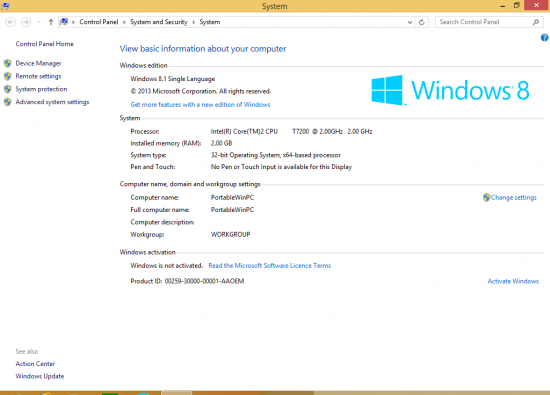

Following this tutorial, I am struggling with getting WDR to detect the patient HDD.
This is the PC I am using for WDR:
File comment: PC with x86 Windows OS

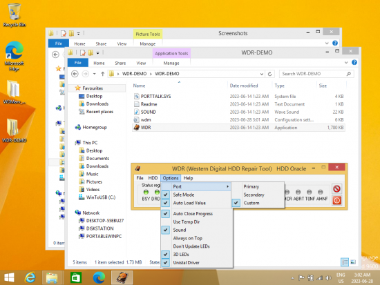

Here is what I see in WDR:
Main:
File comment: Main screen with illuminated indicators

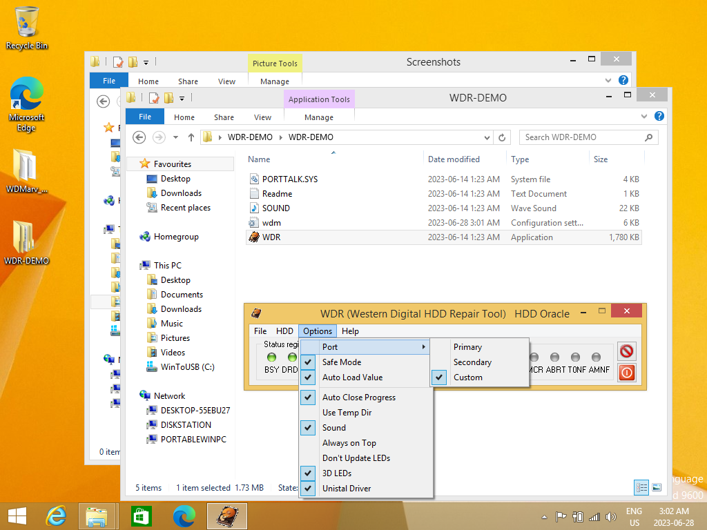

File comment: Main screen with Options menu shown
Custom Port:
File comment: Custom Port window with selected port
WDMarvel Demo has no problem detecting and reading the patient HDD. Is there a way how to get the patient HDD detected and read correctly in WDR?

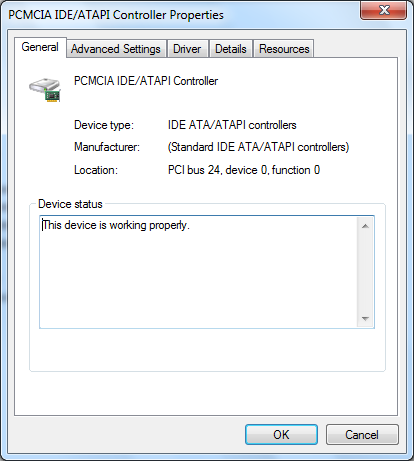

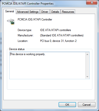

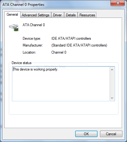

I forgot to mention these are the SATA drivers used:
File comment: PCMCIA IDE/ATAPI Controller
Location: PCI bus 24, device 0, function 0
Location: PCI bus 0, device 31, function 2
File comment: ATA Channel 0

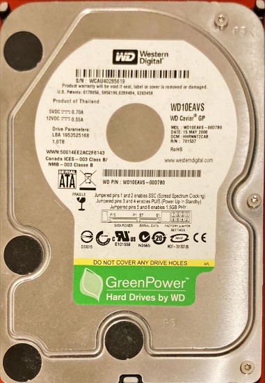

What is the disk model?
 Post subject: Re: WDR Demo unable to detect patient HDD
PostPosted: July 24th, 2023, 1:50
Posts: 17219
Spildit's tutorial expects that the target drive is able to respond to ATA commands. To this end, the easiest solution (in the absence of pro tools) would be to purchase a working donor drive and flash the donor's ROM with the patient's ROM image. You will sacrifice the donor HDD, but your patient drive should now work with the donor's PCB.
Of course you should backup the donor's resources. The demo version of WDMarvel can do this.
PostPosted: July 24th, 2023, 21:52
Joined: December 8th, 2020, 22:38
Posts: 30
Location: Canada

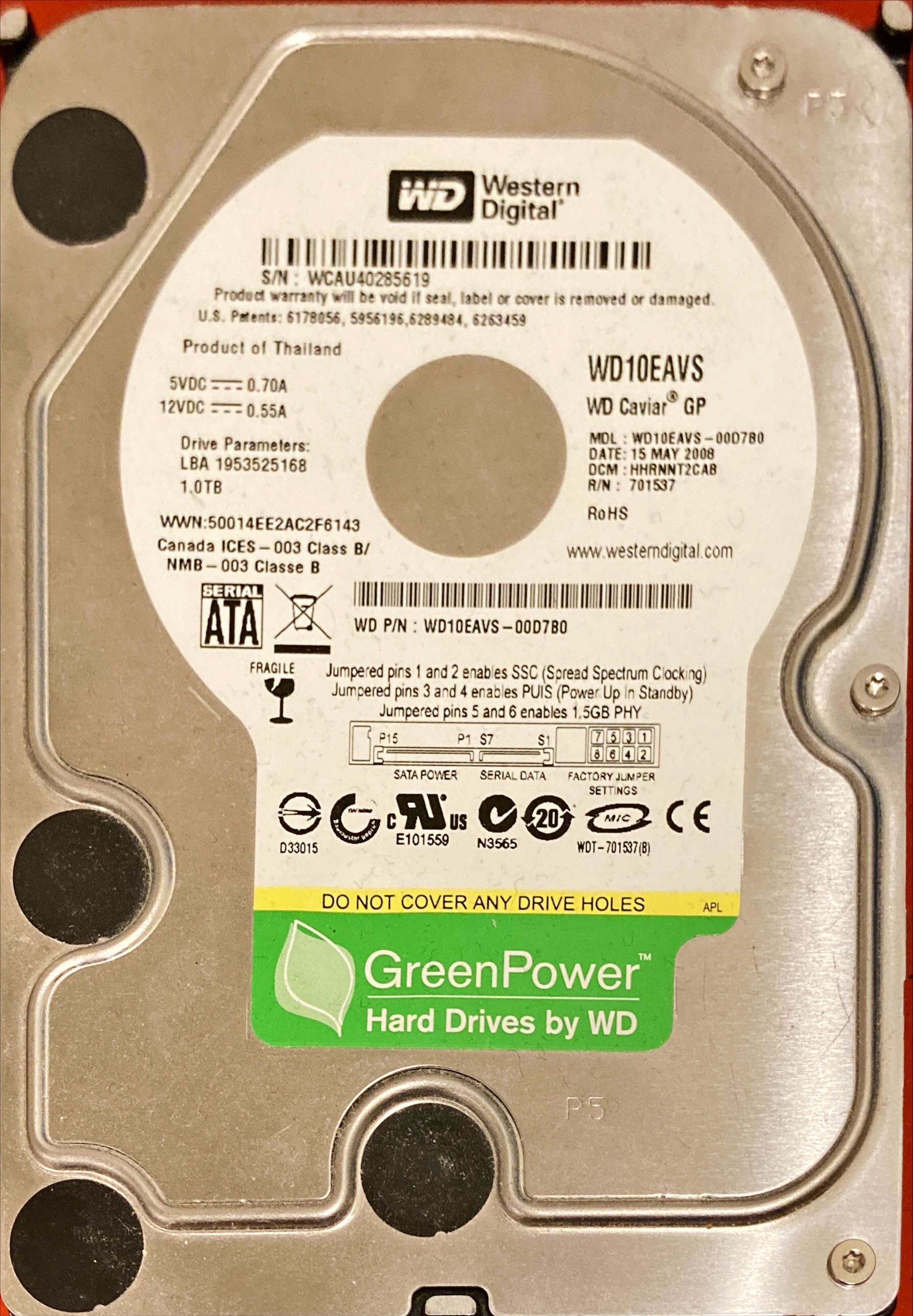

Patient HDD
File comment: Manufacturer: WD
S/N: WCAU40285619
MDL: WD10EAVS-00D7B0
DATE: 15 MAY 2008
DCM: HHRNNT2CAB
R/N: 701537
PCB 2060-701537-004 REV A
