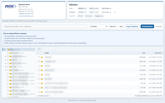

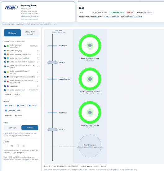

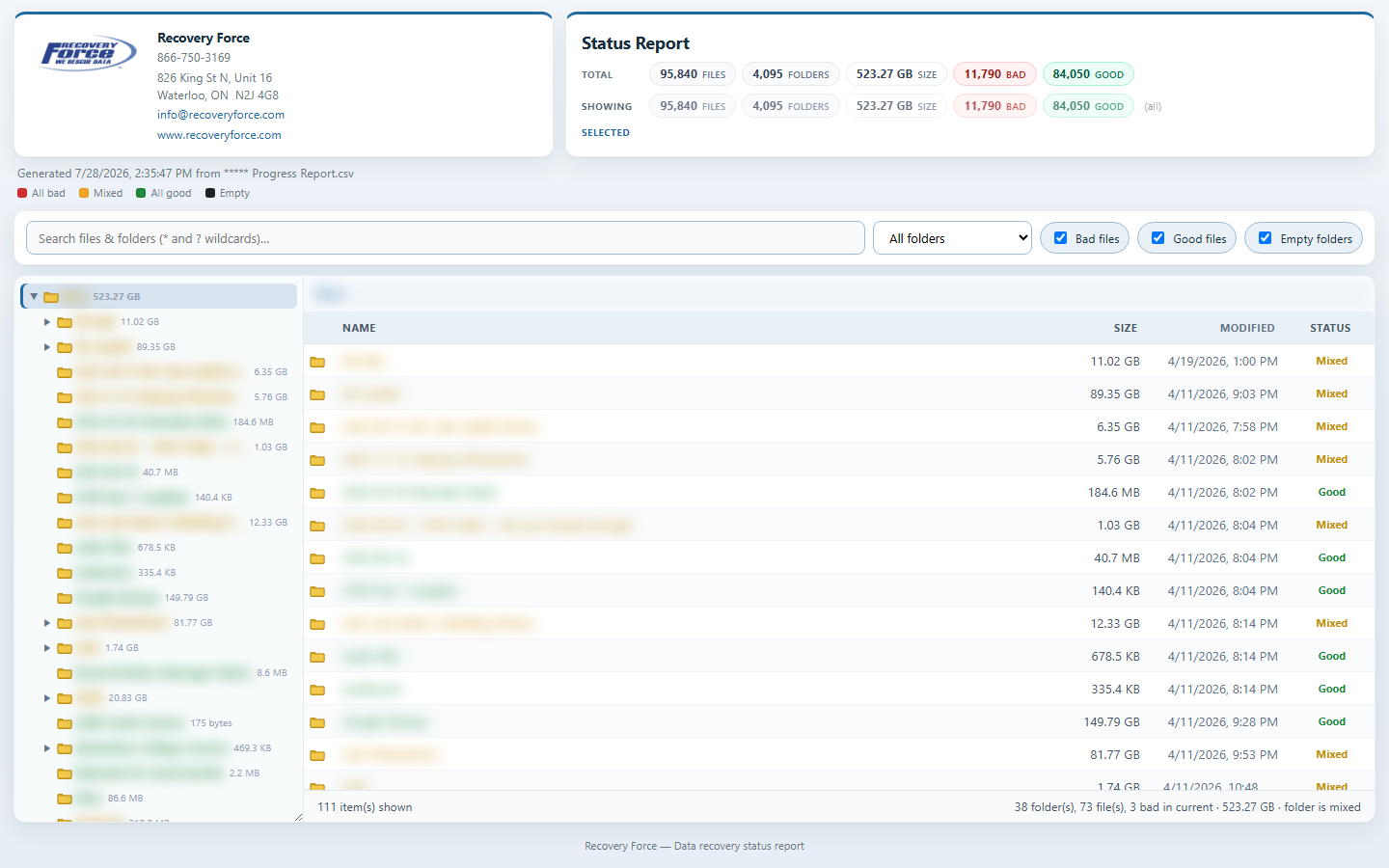

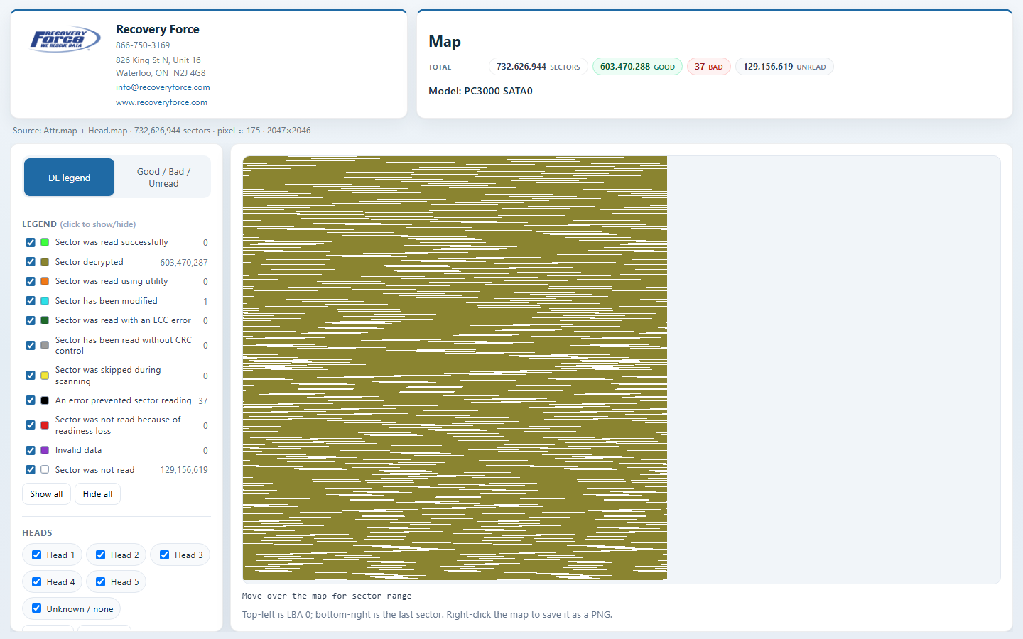

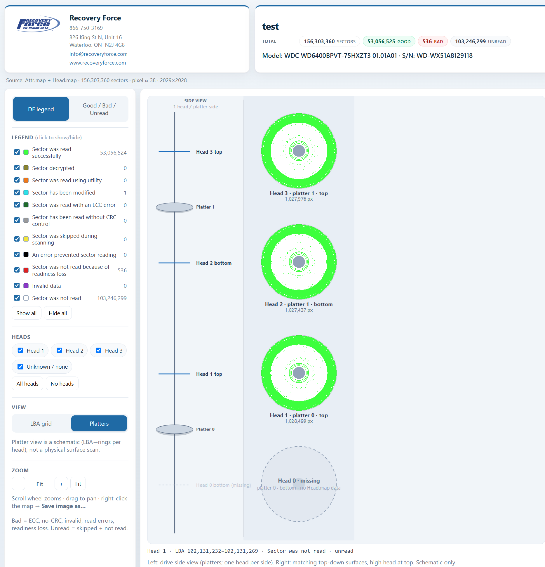

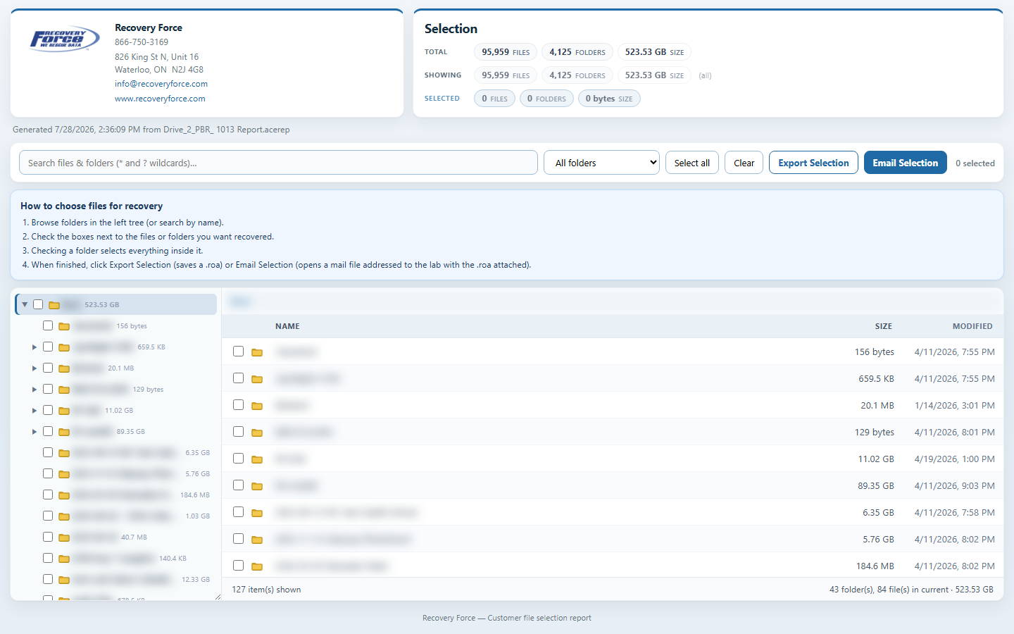

 Post subject: PC3000 DE exported CSV to html file report
PostPosted: July 21st, 2026, 11:56
Posts: 2585
I am aware that someone has been working on a windows app that is very similar in function. For those who, like me, are just looking for a fast simple way to provide a customer with an update of the recovery results mid progress or wish to provide them with a final report for client verification before saving the files to destination, I threw this together for all to use.
https://recoveryforce.com/pc3k-to-html/
If you have an issue with a particular file, please report it to the email on the site.
 Post subject: Re: PC3000 DE exported CSV to html file report
PostPosted: July 24th, 2026, 15:34
Posts: 2585
Newly added. You can now import the .acerep file to generate an html file where the customer makes the selection of target files and folders and saves them to a new .roa file that can then be imported back into DE.
This will help overcome the need for a customer to have windows so that they can run the Data Extractor Viewer.
 Post subject: Re: PC3000 DE exported CSV to html file report
PostPosted: July 27th, 2026, 14:54
Posts: 2585
There was a glitch with saving out the selection to the .roa file which I have fixed.
 Post subject: Re: PC3000 DE exported CSV to html file report
PostPosted: July 28th, 2026, 11:47
Posts: 2585
I just added the ability to convert the attr.map and head.map into a an html page with a full image representation of the image map. This is a great way to show customers a visual of the damage to the drive image.
 Post subject: Re: PC3000 DE exported CSV to html file report
PostPosted: July 28th, 2026, 15:09
Posts: 2585
Here are a few screenshots of the generated reports....obviously with the Recovery Force branding that you can change.
preview-selection.png [ 181.42 KiB | Viewed 1415 times ]
preview-status.png [ 238.38 KiB | Viewed 1415 times ]
preview-map.png [ 107.55 KiB | Viewed 1415 times ]
 Post subject: Re: PC3000 DE exported CSV to html file report
PostPosted: July 30th, 2026, 12:35
Posts: 2585
I had someone suggest this yesterday and I couldn't resist adding it. Now you can flip from a single grid of the map to a platter representation.
Screenshot 2026-07-30 162713.png
Screenshot 2026-07-30 162713.png [ 311.42 KiB | Viewed 931 times ]
 Post subject: Re: PC3000 DE exported CSV to html file report
PostPosted: July 31st, 2026, 6:18
Posts: 3549
This is awesome, Luke!
 Post subject: Re: PC3000 DE exported CSV to html file report
PostPosted: July 31st, 2026, 7:32
Posts: 2585
northwind wrote:
This is awesome, Luke!
 Post subject: Re: PC3000 DE exported CSV to html file report
PostPosted: Today, 8:57
Joined: May 29th, 2020, 19:08
Posts: 110
Location: Tunisia
Very interesting, Luke. I'm currently making my own DR job manager and features-wise I want to integrate a file listing with a case check like on the R-studio report. Well done.
Slim Farza
Arobas Uldry Tunis
I.T. support and data recovery.
http://tunis.ausarl.ch
