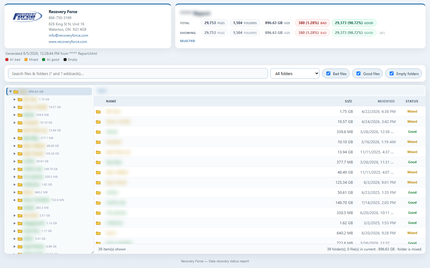

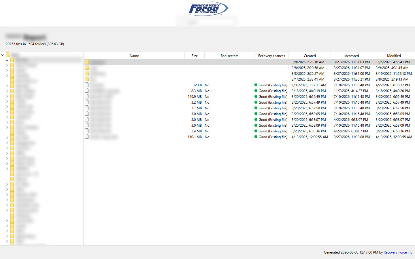

 Post subject: PC3000 DE exported CSV to html file report
PostPosted: July 21st, 2026, 11:56
Posts: 2587
I am aware that someone has been working on a windows app that is very similar in function. For those who, like me, are just looking for a fast simple way to provide a customer with an update of the recovery results mid progress or wish to provide them with a final report for client verification before saving the files to destination, I threw this together for all to use.
https://recoveryforce.com/pc3k-to-html/
If you have an issue with a particular file, please report it to the email on the site.
 Post subject: Re: PC3000 DE exported CSV to html file report
PostPosted: July 24th, 2026, 15:34
Posts: 2587
Newly added. You can now import the .acerep file to generate an html file where the customer makes the selection of target files and folders and saves them to a new .roa file that can then be imported back into DE.
This will help overcome the need for a customer to have windows so that they can run the Data Extractor Viewer.
 Post subject: Re: PC3000 DE exported CSV to html file report
PostPosted: July 27th, 2026, 14:54
Posts: 2587
There was a glitch with saving out the selection to the .roa file which I have fixed.
 Post subject: Re: PC3000 DE exported CSV to html file report
PostPosted: July 28th, 2026, 11:47
Posts: 2587
I just added the ability to convert the attr.map and head.map into a an html page with a full image representation of the image map. This is a great way to show customers a visual of the damage to the drive image.
 Post subject: Re: PC3000 DE exported CSV to html file report
PostPosted: July 28th, 2026, 15:09
Posts: 2587
Here are a few screenshots of the generated reports....obviously with the Recovery Force branding that you can change.
preview-selection.png [ 181.42 KiB | Viewed 2328 times ]
preview-status.png [ 238.38 KiB | Viewed 2328 times ]
preview-map.png [ 107.55 KiB | Viewed 2328 times ]
 Post subject: Re: PC3000 DE exported CSV to html file report
PostPosted: July 30th, 2026, 12:35
Posts: 2587
I had someone suggest this yesterday and I couldn't resist adding it. Now you can flip from a single grid of the map to a platter representation.
Screenshot 2026-07-30 162713.png
Screenshot 2026-07-30 162713.png [ 311.42 KiB | Viewed 1844 times ]
 Post subject: Re: PC3000 DE exported CSV to html file report
PostPosted: July 31st, 2026, 6:18
Posts: 3549
This is awesome, Luke!
 Post subject: Re: PC3000 DE exported CSV to html file report
PostPosted: July 31st, 2026, 7:32
Posts: 2587
northwind wrote:
This is awesome, Luke!
 Post subject: Re: PC3000 DE exported CSV to html file report
PostPosted: August 2nd, 2026, 8:57
Joined: May 29th, 2020, 19:08
Posts: 110
Location: Tunisia
Very interesting, Luke. I'm currently making my own DR job manager and features-wise I want to integrate a file listing with a case check like on the R-studio report. Well done.
Slim Farza
Arobas Uldry Tunis
I.T. support and data recovery.
http://tunis.ausarl.ch
 Post subject: Re: PC3000 DE exported CSV to html file report
PostPosted: August 3rd, 2026, 20:20
Posts: 2587
I have one in the works that already allows rstuduo, ufs and pc300 reports and tile selections directly within the client interface. When they save their selection, it immediately notifies the active tech.
 Post subject: Re: PC3000 DE exported CSV to html file report
PostPosted: Today, 13:36
Posts: 2587
For those using R-Studio for imaging, with or without DeepSpar Stabilizer/RapidSpar, I've added the ability to convert the R-Studio html report to my report format, with your own custom branding, so that your customer can quickly find where the damaged files are and know the number of good and bad files.
preview-rstudio-source.png [ 122.37 KiB | Viewed 147 times ]
preview-rstudio.png [ 210.03 KiB | Viewed 147 times ]
Users browsing this forum: No registered users and 90 guests
