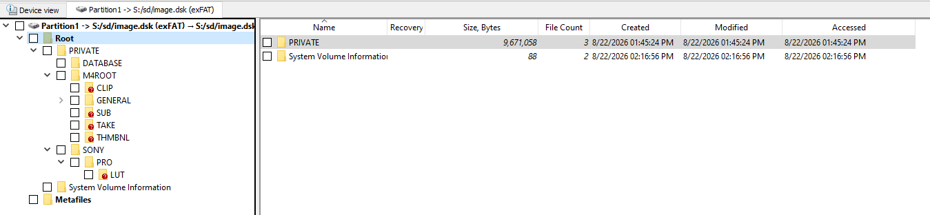

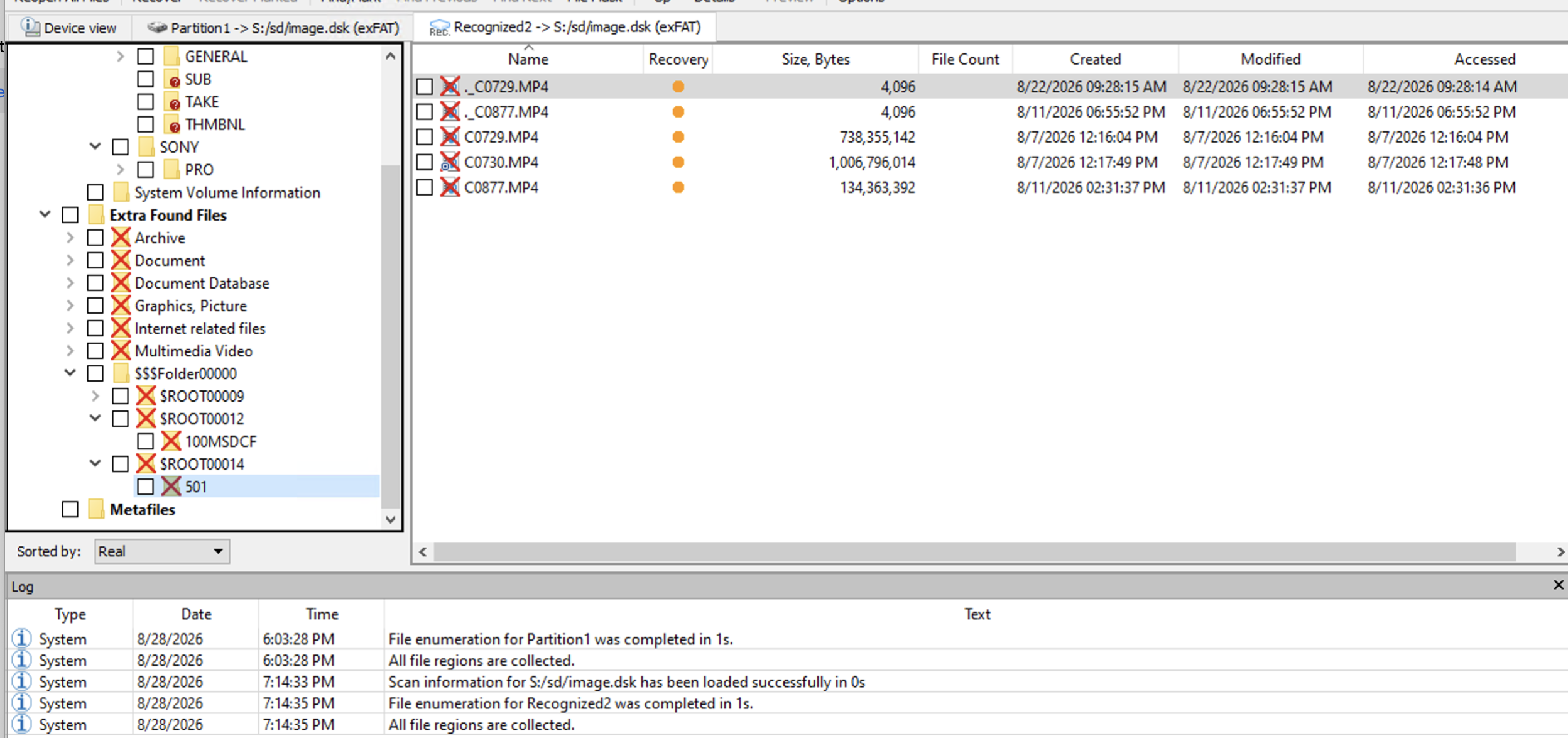

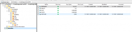

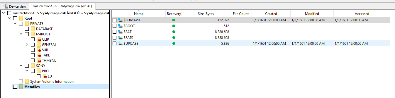

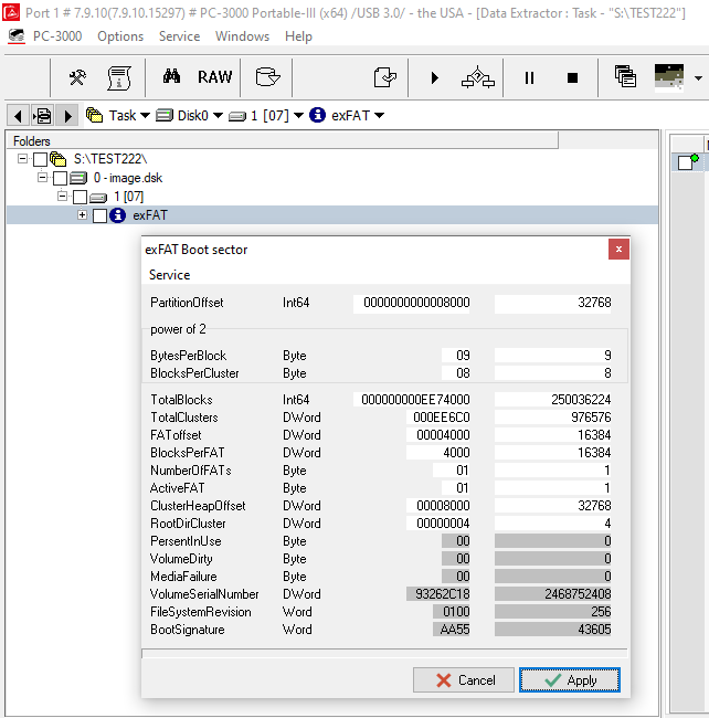

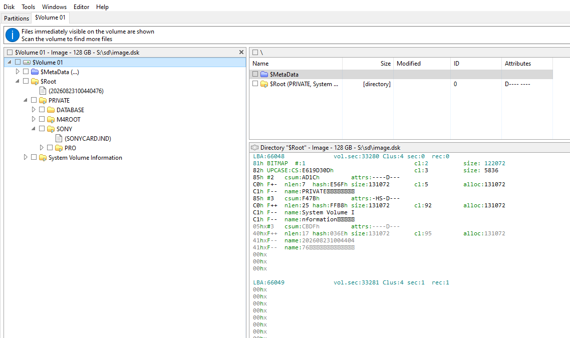

 Post subject: Sony AXAVC recovery tool
PostPosted: Yesterday, 14:39
Posts: 239
Location: Canada
We keep seeing a lot of these in our shop; figured we publish a free tool we created to recover data from them:
https://sonyvideorecovery.com/
 Post subject: Re: Sony AXAVC recovery tool
PostPosted: Yesterday, 15:50
Posts: 17151
Thanks!
 Post subject: Re: Sony AXAVC recovery tool
PostPosted: Yesterday, 19:46
Posts: 17151
I saw your post in another forum. I was reminded that Sony cameras low-level format the cards. I believe this results in physical erasure. In fact, you allude to this blog:
https://www.jeffgeerling.com/blog/2025/recovering-videos-my-sony-camera-i-stupidly-deleted/
And I know it's impossible to recover photos off SD cards on Sony cameras when the card has been formatted, due to the way Sony's cameras perform the formatting operation. Don't ask me how I know.
It's not a quick erase like I was used to on my Nikon cameras; it goes in and issues a direct erasure of the entire SD card filesystem in a way photorec can't recover it.
https://stackoverflow.com/questions/65772094/what-is-the-sd-card-erase-process
 Post subject: Re: Sony AXAVC recovery tool
PostPosted: Yesterday, 19:53
Posts: 239
Location: Canada
Agreed - it's an odd one.
The way I figure it is some Sony models don't use the CMD38; while others do.
Then, to complicate things worse, some SD cards (like some Lexar Pro series) don't appear to immediately execute the CMD38 request - making recovery possible while background operations complete.
Creation of such a "this card is not recoverable, vs. this is" not possible. However a review under HEX can quickly determine if there is any value to a software solution. However, I found this "check" problematic / could create a false positives and didn't want to add it to the software. Perhaps in the future...
I've updated the site w/your feedback:
https://sonyvideorecovery.com/#sd-erase
Bottom line, it's worked for us and hopefully it helps someone else.
 Post subject: Re: Sony AXAVC recovery tool
PostPosted: Yesterday, 20:11
Posts: 239
Location: Canada
Lexar card - formatted on the 22nd of Aug. All default structures are the same. Was a Sony ZV-E1. 100% recovery.
example4.png [ 19.28 KiB | Viewed 112 times ]
example3.png [ 29.97 KiB | Viewed 112 times ]
example2.png [ 17.96 KiB | Viewed 112 times ]
example1.png [ 20.57 KiB | Viewed 112 times ]
 Post subject: Re: Sony AXAVC recovery tool
PostPosted: Yesterday, 20:33
Posts: 17151
https://helpguide.sony.net/ilc/2310/v1/en/contents/0601_memory_format.html
MENU → (Shooting) → [Media] → [Format].
Select [Enter]. (Quick formatting)
If you press the (Delete) button, a message to perform full formatting will be displayed. You can launch full formatting by selecting [Enter].
 Post subject: Re: Sony AXAVC recovery tool
PostPosted: Yesterday, 20:39
Posts: 239
Location: Canada
I would conclude that Sony cameras can perform materially different formatting operations.
A normal quick format may leave recoverable media data intact, while full formatting and card-specific erase/TRIM behaviour may make recovery impossible.
It's all up the end user ;-) Shame there is not a static default.
 Post subject: Re: Sony AXAVC recovery tool
PostPosted: Yesterday, 21:04
Joined: May 13th, 2019, 7:50
Posts: 1170
Location: Nederland
WebClaw wrote:
Agreed - it's an odd one.
The way I figure it is some Sony models don't use the CMD38; while others do.
Then, to complicate things worse, some SD cards (like some Lexar Pro series) don't appear to immediately execute the CMD38 request - making recovery possible while background operations complete.
Creation of such a "this card is not recoverable, vs. this is" not possible. However a review under HEX can quickly determine if there is any value to a software solution. However, I found this "check" problematic / could create a false positives and didn't want to add it to the software. Perhaps in the future...
I've updated the site w/your feedback:
https://sonyvideorecovery.com/#sd-erase
Bottom line, it's worked for us and hopefully it helps someone else.
But files were deleted, or? It's a different scenario in that case.
 Post subject: Re: Sony AXAVC recovery tool
PostPosted: Yesterday, 21:06
Posts: 239
Location: Canada
Client states it was a quick format, not file deletion.
HEX supports that, as do PC-3000, R-Studio and DMDE.
If the files had simply been deleted, I would expect different filesystem evidence. The screenshots I posted are consistent with a format/recreated filesystem rather than individual file deletion. Full scan via RS shows 3 MP4 (that do not play). No other exFAT results.
So yes, different scenario. :-)
This is also not an isolated case. We would not have built a recovery engine around a single successful recovery. We developed it because we have encountered this pattern repeatedly and recovered data from multiple Sony-formatted cards.
Screenshot 2026-08-28 at 7.15.28 PM.png
Screenshot 2026-08-28 at 7.15.28 PM.png [ 986.79 KiB | Viewed 88 times ]
 Post subject: Re: Sony AXAVC recovery tool
PostPosted: Yesterday, 21:19
Joined: May 13th, 2019, 7:50
Posts: 1170
Location: Nederland
Oh, I was referring to this: https://www.jeffgeerling.com/blog/2025/ ... y-deleted/
 Post subject: Re: Sony AXAVC recovery tool
PostPosted: Yesterday, 21:28
Posts: 239
Location: Canada
I'm not sure, I've reached out to Jeff. If he replies I'll share his feedback. His blog description suggestions delete which is why he was able to still recover artifacts with PhotoRec.
