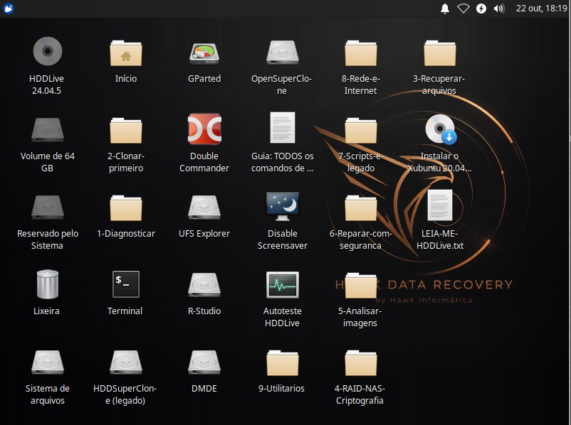

 Post subject: I built my own Linux live for data recovery: HDDLive
PostPosted: October 22nd, 2026, 18:00
Joined: March 23rd, 2022, 15:48
Posts: 17
Location: Brazil
I rebuilt everything from scratch using scripts: ISO remastering in a chroot environment, a kernel driver built through DKMS, Linux kernel 7.0, a hybrid BIOS + UEFI ISO, and automated boot tests.
HDDLive is a live Linux system that boots from a USB drive, runs in RAM, and leaves the client’s PC untouched.
Here’s what it includes and what each tool does:
- Cloning failing drives: OpenSuperClone clones in phases, accesses the controller directly, and creates a virtual disk that reads only the sectors requested by the recovery tool. ddrescue copies data while skipping read errors and saves a map so the process can resume later.
- Recovering files and partitions: TestDisk rebuilds lost partitions; PhotoRec recovers files by signature, even after formatting; DMDE, R-Studio, R-Linux, and UFS Explorer reconstruct file systems and RAID arrays.
- Diagnostics: smartmontools, nvme-cli, hdparm, and Hard Disk Sentinel reveal the drive’s actual health before any decisions are made.
- RAID and encryption: mdadm, LVM, cryptsetup (LUKS), and dislocker (BitLocker) open volumes in read-only mode.
- Forensics: Sleuth Kit and bulk_extractor scan entire disk images for deleted files, emails, and metadata.
The screenshot, shows pt-br interface, but dispiste the screen, the program is 100% english
Source: https://github.com/hawkinf/hddlive-osc
Download: https://sourceforge.net/projects/hawkinf/
WhatsApp Image 2026-10-22 at 15.20.34.jpeg
WhatsApp Image 2026-10-22 at 15.20.34.jpeg [ 90.84 KiB | Viewed 239 times ]
 Post subject: Re: I built my own Linux live for data recovery: HDDLive
PostPosted: Yesterday, 11:13
Joined: November 7th, 2008, 19:52
Posts: 23
thank you
 Post subject: Re: I built my own Linux live for data recovery: HDDLive
PostPosted: Yesterday, 15:43
Posts: 277
Location: Canada
That's a really good idea. Awesome.
Users browsing this forum: Google [Bot] and 65 guests
