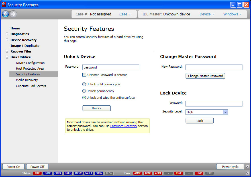

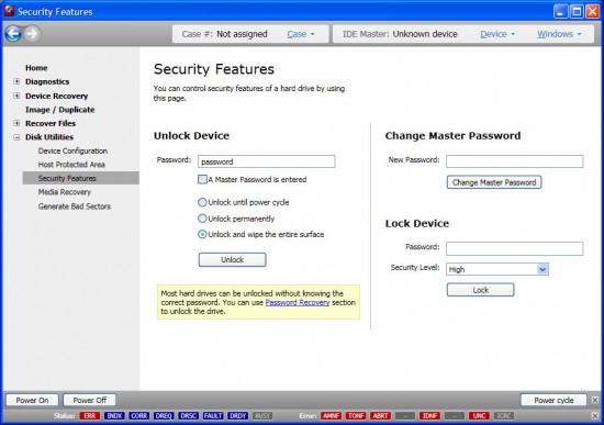

maysoft wrote:
MHDD can erase hard drives at full speed;
You can also use Security Erase function in any software (MHDD, Victoria, Insight, ...) - this one is the fastest since it is done by the hard drive itself
Or, there's this little thingy: http://hddguru.com/content/en/software/ ... Wipe-Tool/
I can't see this in Insight Dmitry, i looked and looked. am i crazy or you? or both?
 Post subject: Re: zero fill SW recomendations?
PostPosted: October 17th, 2008, 20:51
Posts: 765
Please see the attached picture :)
Dmitry
