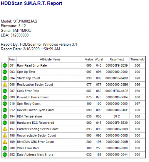

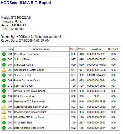

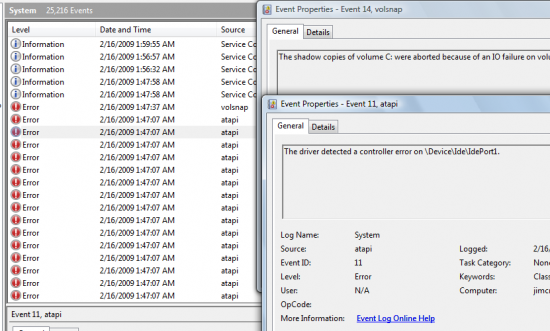

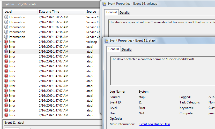

I'm having some problems: slow POST, errors in the Event Log (screenshot below). Sometimes the Hard Drive is not detected by the BIOS. Sometimes Windows Vista locks up and the computer restarts.
1. Can a bad motherboard cause false positive S.M.A.R.T. results in HDDScan?
2. Also, can a bad motherboard or power supply physically damage a hard drive, thus causing S.M.A.R.T. "bangs"
3. Or is this just a case of a bad Hard Drive causing typical problems?
In any case, is this Hard Drive dead, or what? If I buy a new one and stick it in the PC, will the new one get damaged as well?

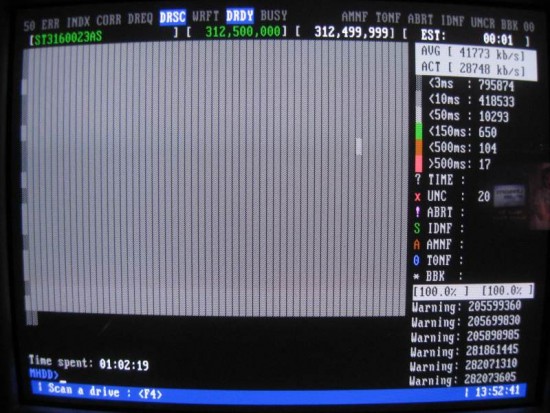

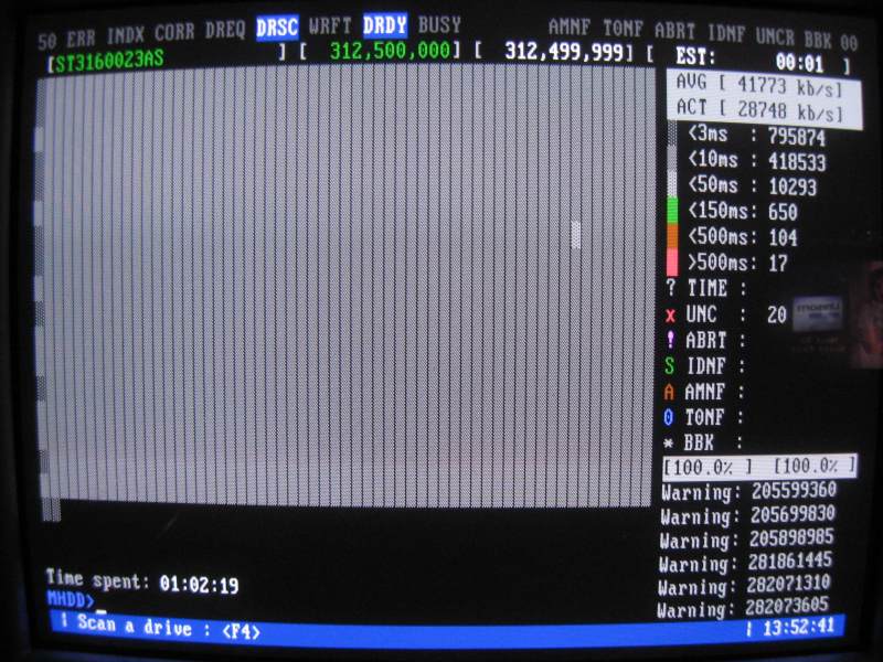

Is it time for a new drive or should I try this (from the FAQ)
Q: How can I fix delays on my HDD (red and brown blocks in MHDD)?
A: Use ERASE command in MHDD (it will erase the entire hard drive though :)), then run scan+erase delays ON, then scan+remap ON.

The Event Id 11s you are getting are having to do with ATAPI which is linked to your CD/DVD drives, and not your HDD.
A faulty motherboard cannot directly cause false SMART output. Technically it COULD indirectly cause SMART output to show a drive is failing if it is failing in the way of cutting power to the HDD suddenly causing possible damage to the drive, but if that was occuring, you would know (lots of blue screens, instability)
I believe your HDD is genuinly failing and you should back up any data on it immediatly and RMA the drive. It is still a ways away from reallocated sector count threshold so you should still have time, but don't count on that. SMART is not something to rely on, just a decent gauge.
