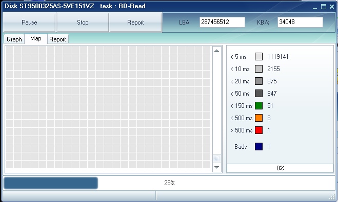

It would be great if there was possibility of at least manually set bad sectors. Currently HDDScan is scanning hdd for slow blocks. (pic attached)

As it turns out part of the problem was corrupter NTFS + bad sectors and the other part was Windows 7 "USB selective suspend". Can be found in control panel (pic attached).
