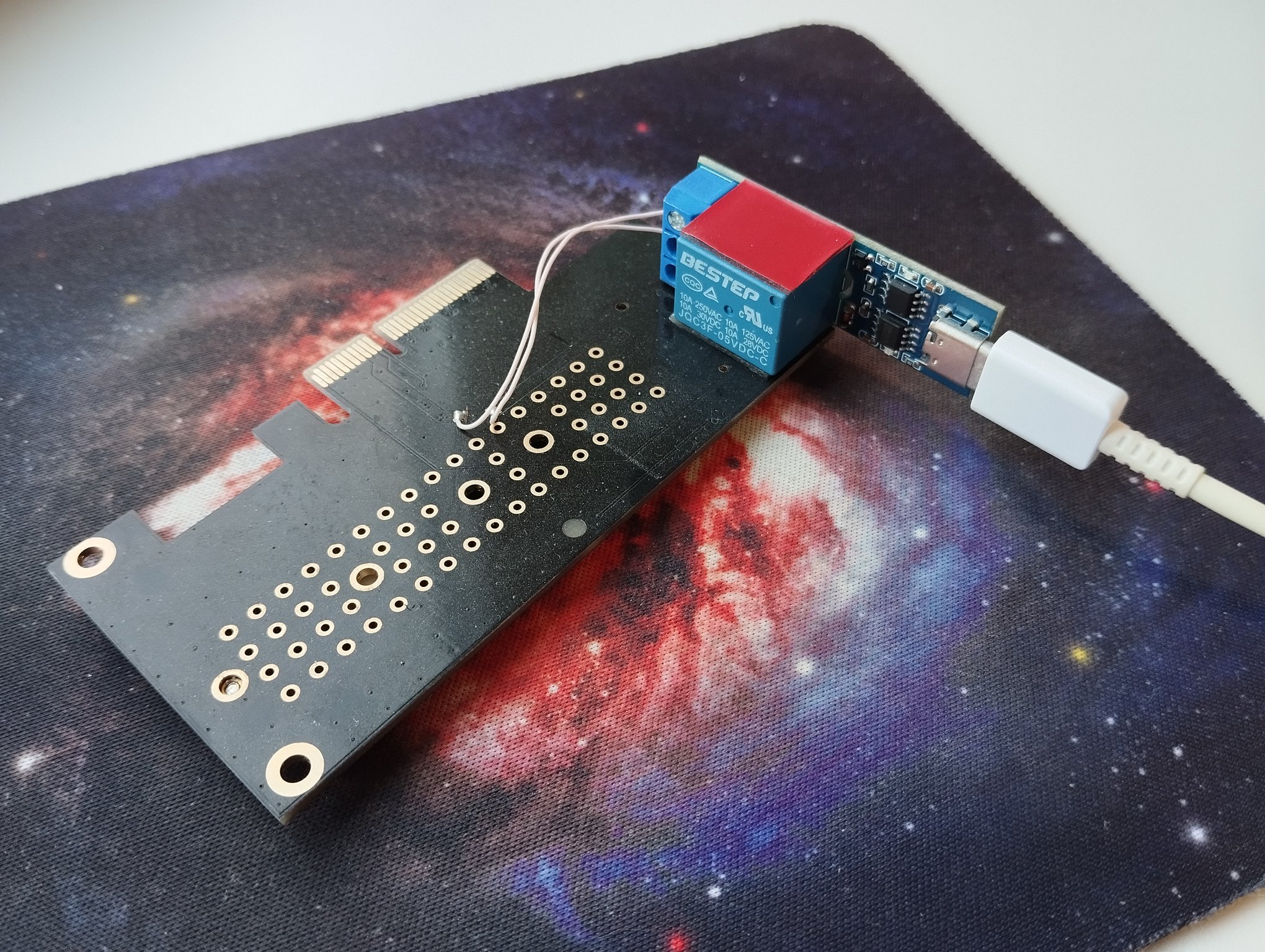

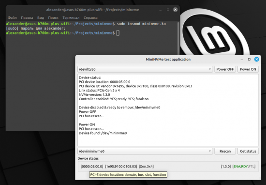

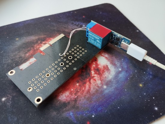

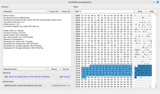

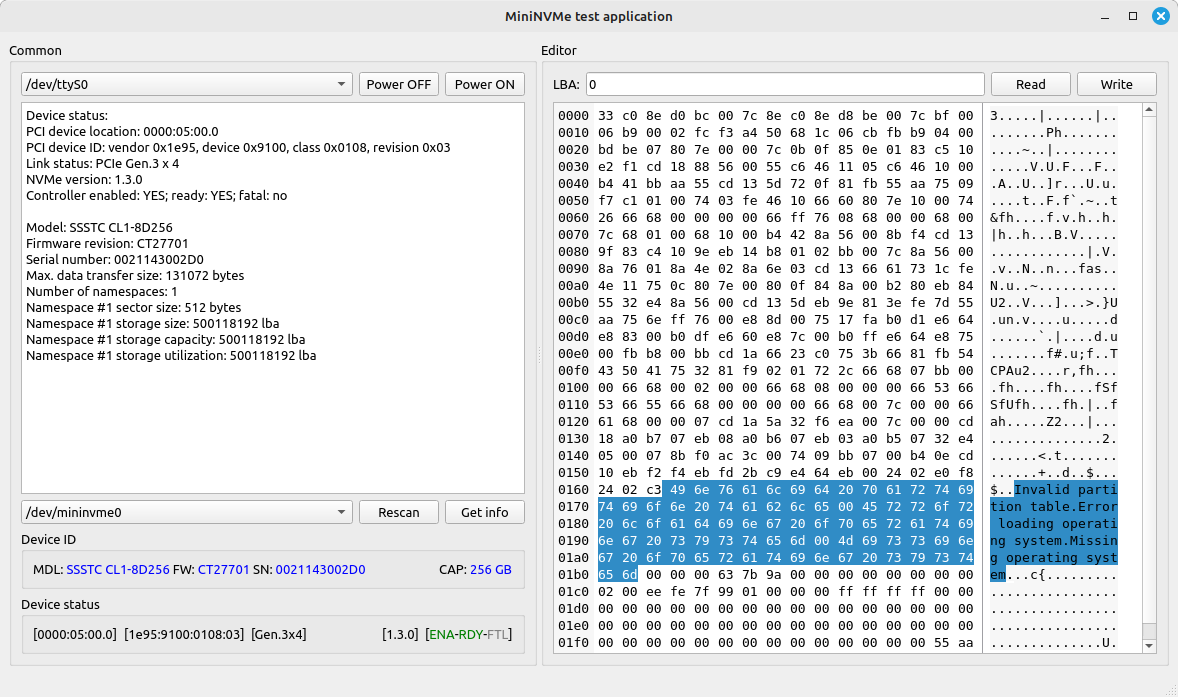

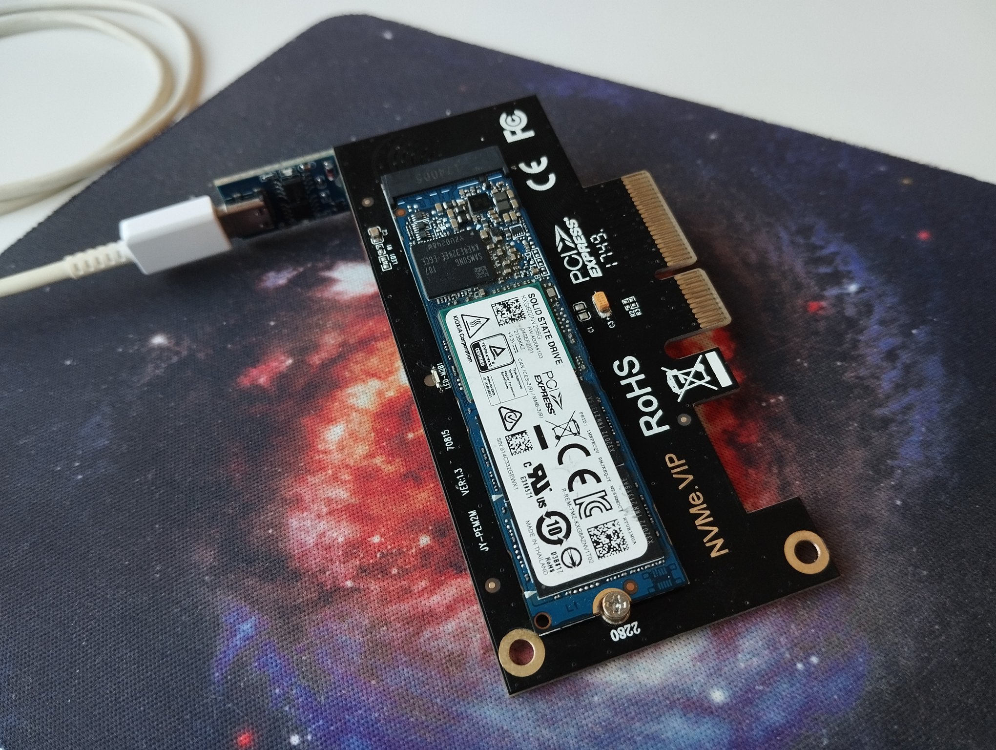

Hi. Last months I working on interesting project, actually it's a simple disk clone software under the Linux operating system. The main idea is replacing standard NVMe/AHCI drivers to my custom drivers: MiniNVMe and MiniAHCI. As result attached devices will be isolated from the operating system: no mount attempt, no SMART status reading etc. The only way to get access to device is my application. In simple terms - like PC-3000 works.
Whats is I have at this moment? MiniNVMe driver reads some PCI-E (NVMe) device info: PCI id's, link speed, NVMe subsystem version etc. Also PCI-E hot plug supported. Yes, it's not a joke. As you know maybe, PCI-E hot plug supported by the Linux kernel, but to get it work this feature must be also supported by chipset hardware. Not all of the modern PC motherboards support PCI-E hot plug. To control the device's power supply I use a simple CH340 USB relay.
How it looks now?
From time to time I plan to post some news about the project. Not too often I guess. So stay tuned and please share your thoughts below.

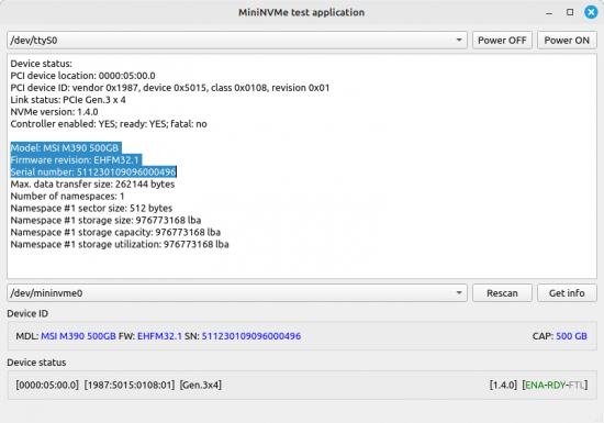

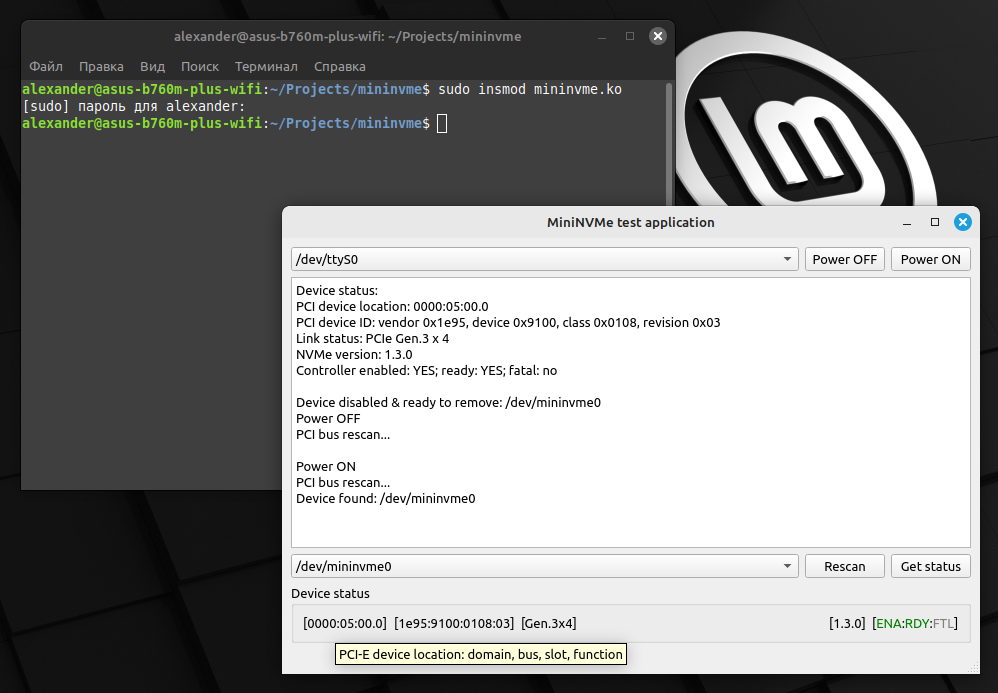

Now MiniNVMe driver is able to receive device identification data: model name, firmware revision, serial number, capacity etc. The next step is sectors reading and writing.

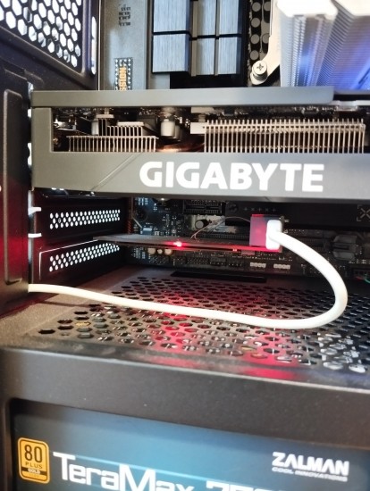

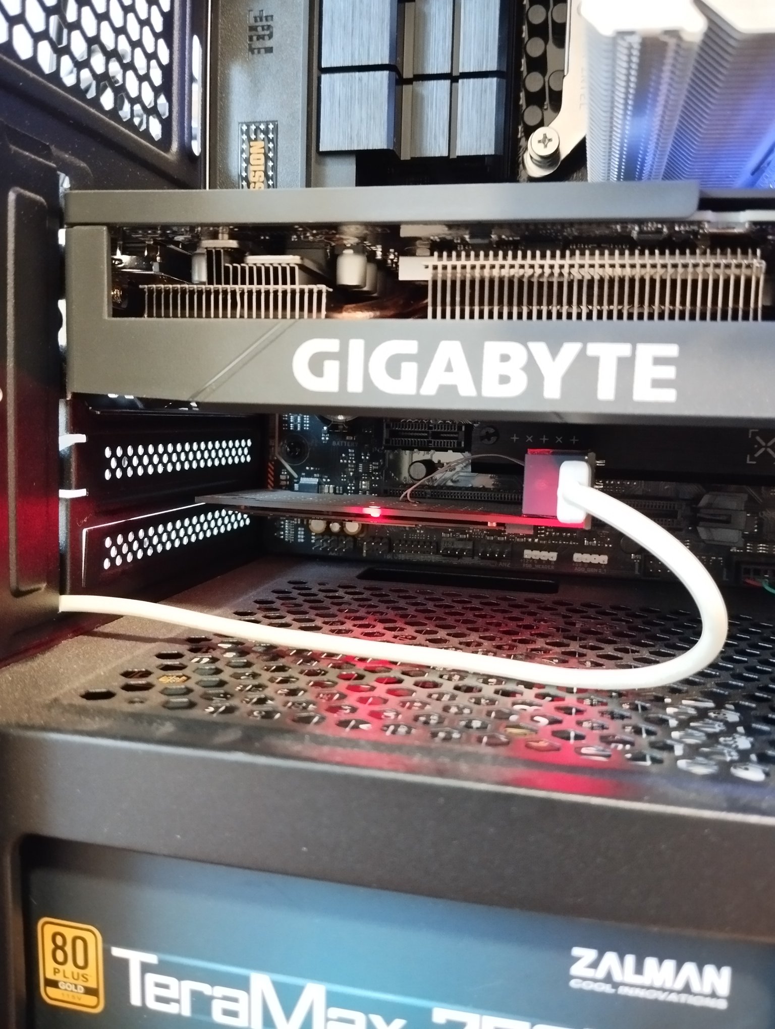

Data transfer is working: read & write.
At this moment my driver does not support software reset sequence. If a patient device does not response (slow responding, firmware background activity, bad block occurred, etc.) the only way to reset it is power replug. I guess in case when mainboard supports PCI-E hot plug it's more than enough.

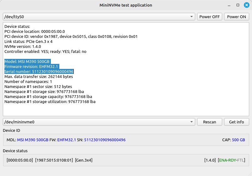

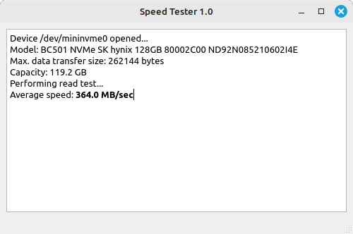

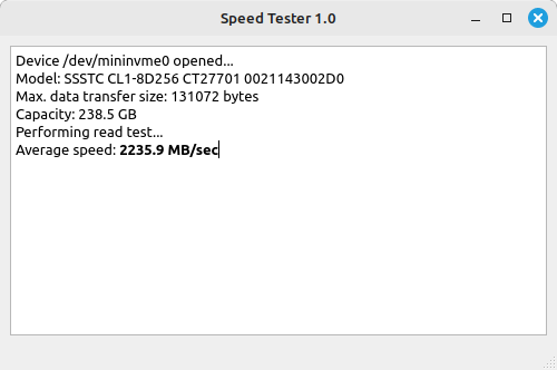

I got a couple of interesting digits: an average read speed from two different devices.
    1. Totally trimmed drive (no real data, returns zeroes only) - 2235.9 MB/ses
    2. Formatted drive, some files dropped - 364.0 MB/sec
Not bad I guess. Especially for self written NVMe device driver for Linux. What do you think?

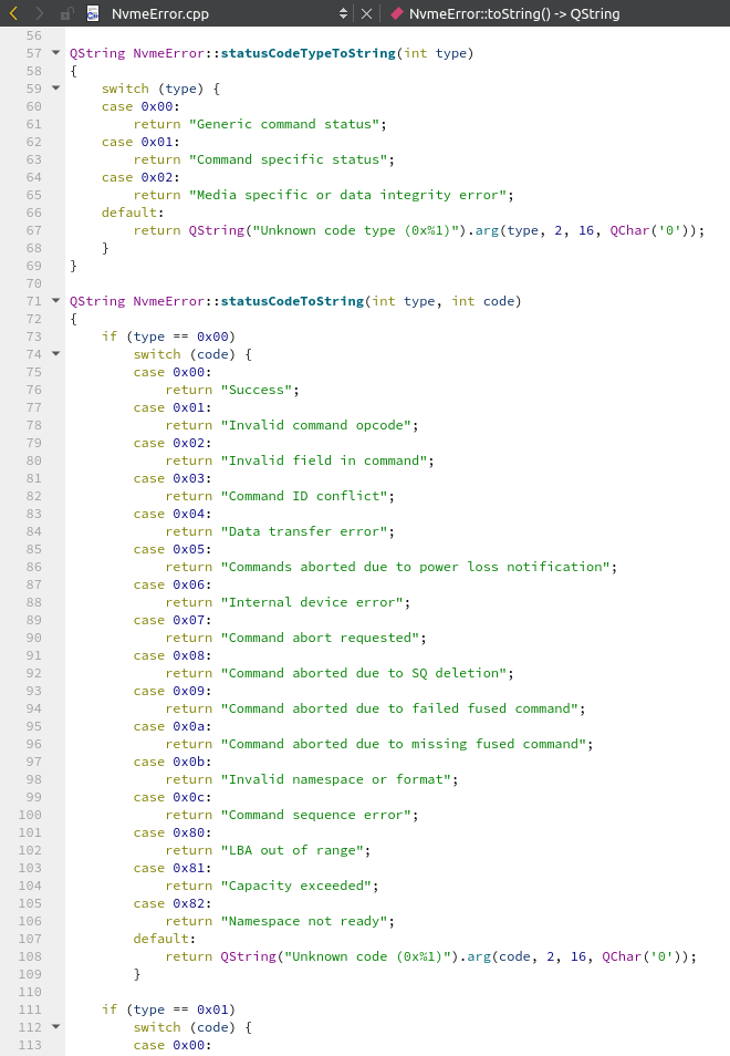

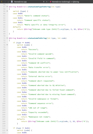

NVMe error codes description in process...
 Post subject: Re: Another useless data recovery toy?
PostPosted: October 24th, 2024, 8:44
Joined: May 13th, 2019, 7:50
Posts: 1215
Location: Nederland
Those errors do ring a bell ;)
https://www.disktuna.com/decoding-statu ... mart-logs/

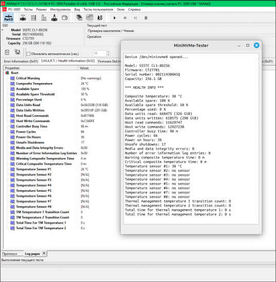

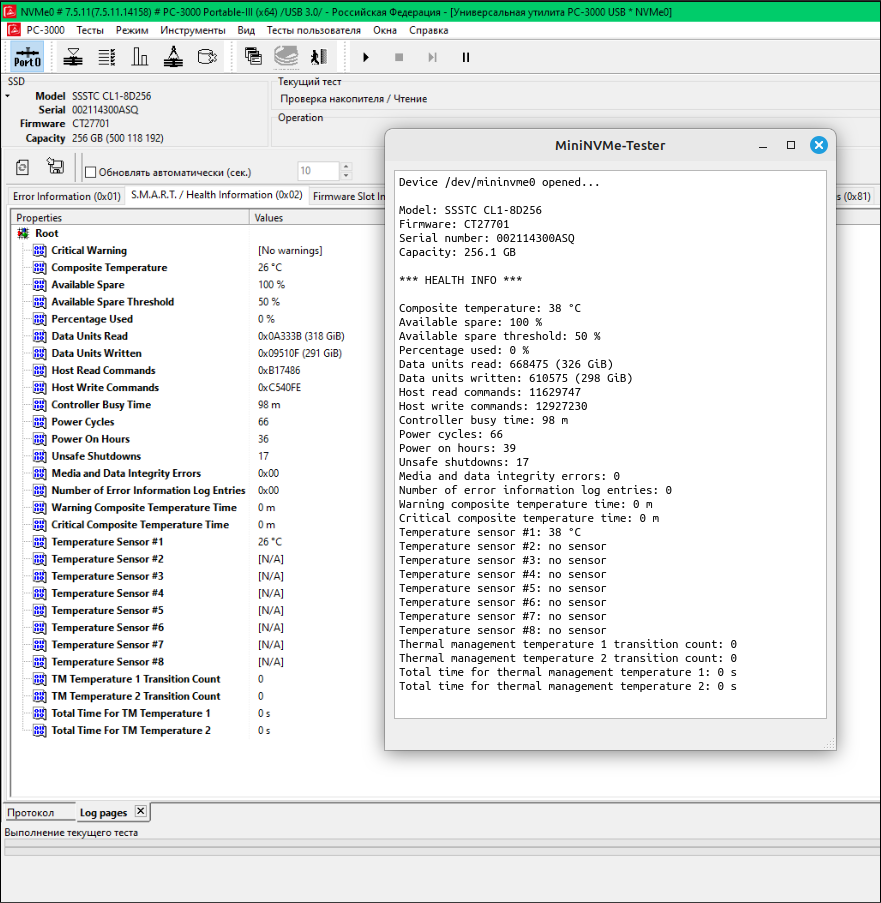

Now health info looks like you know what... Ehe-he-he... 8)

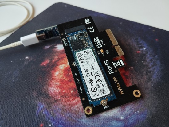

PostPosted: November 21st, 2024, 7:13
Posts: 1323
Looking good so far.
Would love to see the drive itself on a fly lead outside the case though and positioned so we can get at both sides whilst it's running.
PostPosted: November 21st, 2024, 15:06
Posts: 17333
Where is the health.criticalWarning attribute?
This is wrong:
    ui->plainTextEdit->appendPlainText(QString("Data units read: %1 (%2 GiB)")
                                       .arg(health.dataUnitsRead()).arg(health.dataUnitsRead() * 512 / (1024 * 1024)));
    ui->plainTextEdit->appendPlainText(QString("Data units written: %1 (%2 GiB)")
                                       .arg(health.dataUnitsWritten()).arg(health.dataUnitsWritten() * 512 / (1024 * 1024)));
It should be ...
                                       .arg(health.dataUnitsRead()).arg(health.dataUnitsRead() * 512 * 1000 / (1024 * 1024 * 1024)));
                                       .arg(health.dataUnitsWritten()).arg(health.dataUnitsWritten() * 512 * 1000 / (1024 * 1024 * 1024)));
Data Units Read: Contains the number of 512 byte data units the host has read from the controller; this value does not include metadata. This value is reported in thousands (i.e., a value of 1 corresponds to 1,000 units of 512 bytes read) and is rounded up (e.g., one indicates the that number of 512 byte data units read is from 1 to 1,000, three indicates that the number of 512 byte data units read is from 2,001 to 3,000). When the LBA size is a value other than 512 bytes, the controller shall convert the amount of data read to 512 byte units.
Something like this?
https://forum.hddguru.com/viewtopic.php?p=264481#p264481
Oops, forgot to add...
This is wrong
Yes, I know. I was just curious why the PC-3000 also shows these attributes incorrectly. Obviously this is a mistake.
PostPosted: November 22nd, 2024, 1:18
Posts: 17333
aekhv wrote:
This is wrong
PC3000 is correct. You are wrong.
https://www.google.com/search?q=0x0a333b+x+512+x+1000+bytes+in+GiB
    0x0a333b x 512 x 1000 bytes = 318.753719 gibibytes
https://www.google.com/search?q=0x09510f+x+512+x+1000+bytes+in+GiB
    0x09510f x 512 x 1000 bytes = 291.144848 gibibytes
PostPosted: November 22nd, 2024, 4:29
Joined: September 11th, 2024, 10:21
Posts: 64
Location: Russia
Yeah, it's true. Thanks a lot!
PostPosted: November 22nd, 2024, 5:40
Posts: 1323
More like this https://www.aliexpress.com/item/1005006584734868.html but with the rest of the m2 mounting pcb snapped right back or the the m2 mounted vertically.
We need something that has the drive pcb clear so we can get to both sides and that we can put on an external heater or cooler.
