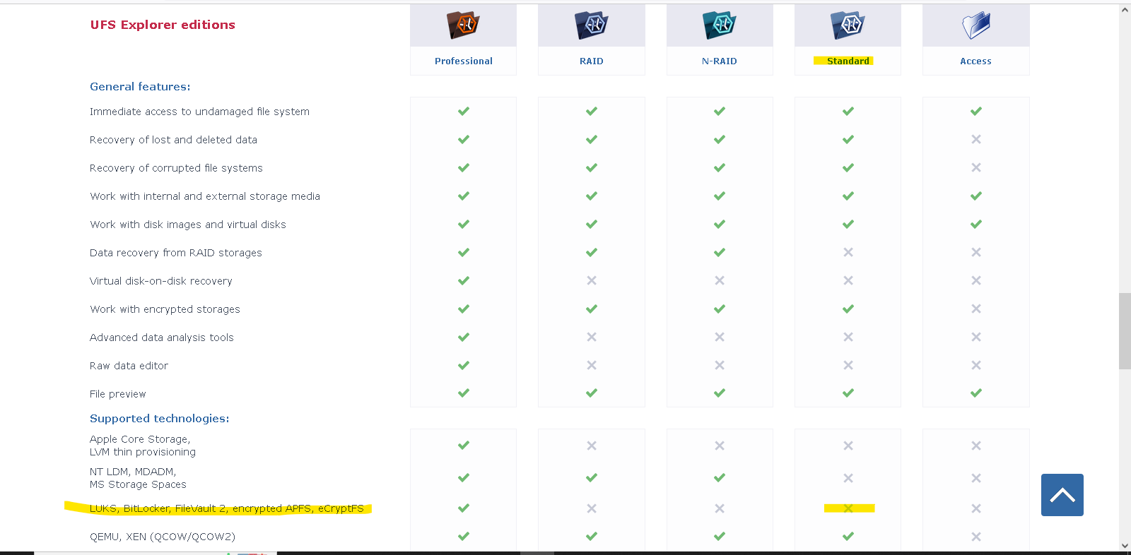

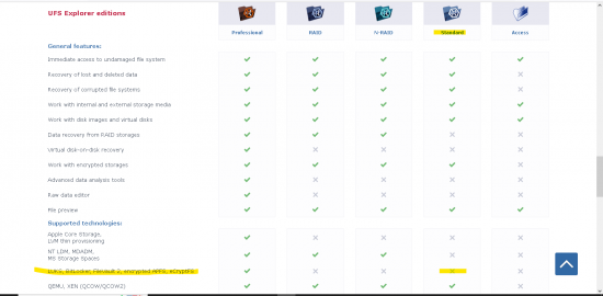

Standard edition states it can work with encrypted storages, but it seems only the pro version can handle LUKS, BitLocker, FileVault 2, encrypted APFS, eCryptFS, can you clarify that? Thanks.

grevan, Standard Recovery edition supports BitLocker and encrypted APFS. Please see the specifications on the product page.

Thanks, I saw that description on the compare products table chart, thanks for clarifying.

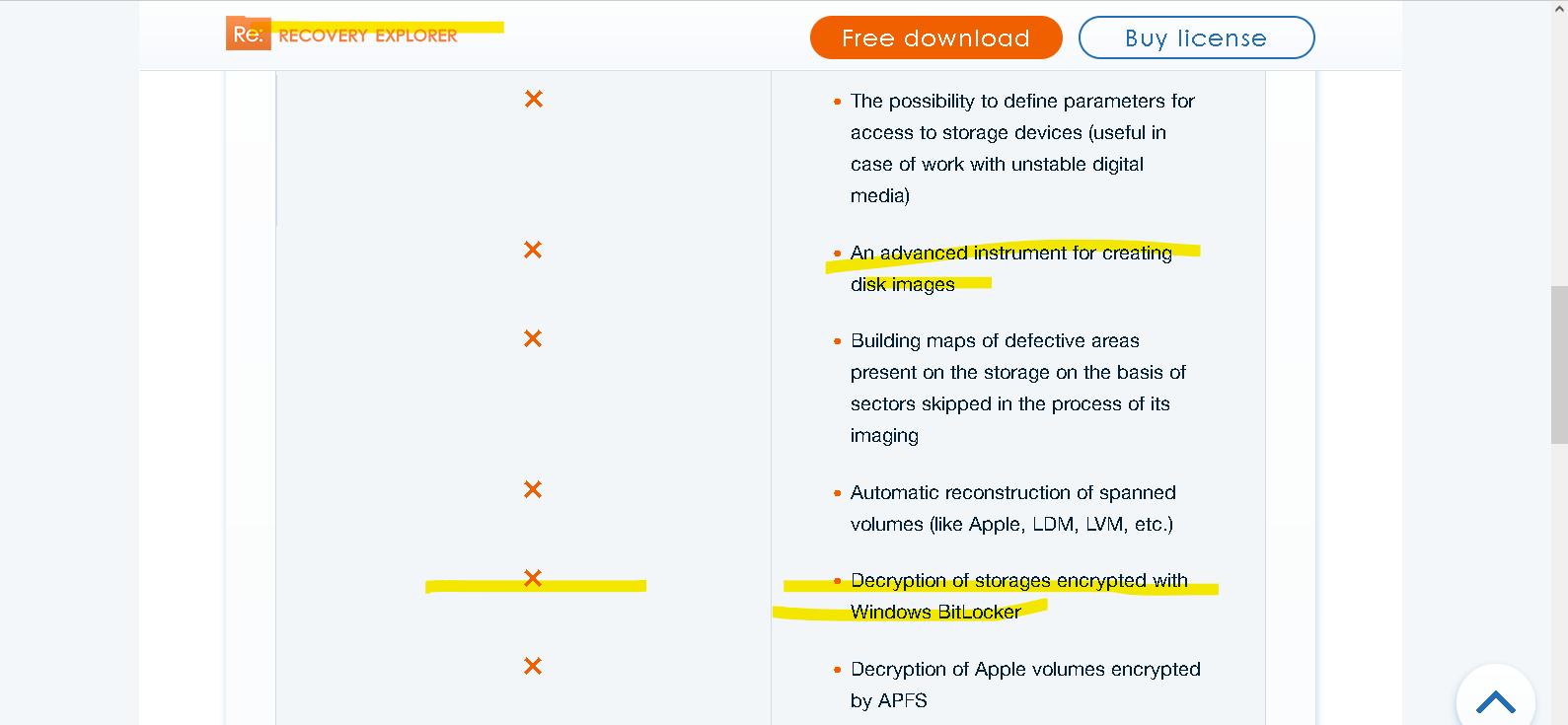

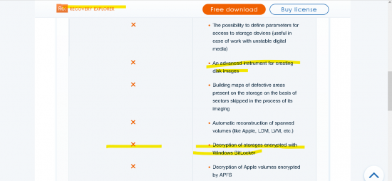

Hi Iurii
As suggested by Dr-Kiev for a bitlocker + Mcafee decryption case I am planning to purchase UFS explorer standard version ( pro is very much costly and I will not be able to afford) (https://forum.hddguru.com/viewtopic.php?f=1&t=42528)
I want to image M.2 SSD 512 Gb on 1TB 2.5" SSD ( vhdx) and perform bitlocker decryption. (Due to multiple encryption windows is not booting up)
after successful decryption I want to mount it as vm.
Does standard version supports all this functions ( advanced imaging and bitlocker decryption).
In UFS explorer standard page it says it supports decryption ,but in product compare page its mentioned as non supported.
Also most of the features are available for version 9.X but on product purchase page version shown is 8 .
Can you pls. help for clarification.

Maybe Recovery Explorer is an alternative? https://www.r-explorer.com/recovery-exp ... fessional/
Thanks Arch.
Yes you are right pro version of r-explorer is for $199 . Since it is from same developer maybe imaging and other functions are same.
I have read that image created using UFS Explorer is most accurate for decryption purpose.

Actually R-explorer does not support Bitlocker decryption and advanced imaging functions so its of no use.

It's hard to choose a product when there are so many comparison tables. It's even worse when every product has a technical specification. And it's just terrible when there is a list of releases with updates. It's even harder when there is a license agreement that specifies that only a commercial license can be used for commercial purposes.

I am looking for software for particularly Bitlocker decryption cases. I already have R-Image license , winhex license alongwith many other licenses.
But I want image compatible with many forensic decryption softwares and moutntable format type (VHDX etc)
