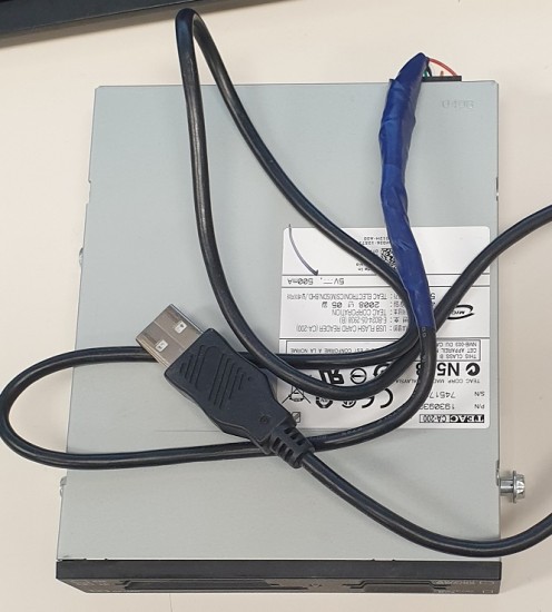

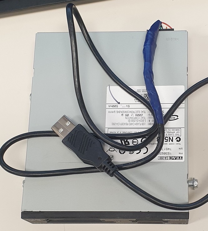

I believe the card readers are connected to the Motherboard via USB, if a slotted in one, and those connectors are USB. I wired a USB plug directly on the card reader and it plugged in to USB and works fine. The card reader cable has 2x sets of USB wires to suit pinout if the mobo pins.
Yeah, you are right, It was late, I was tired and looking for excuses. I was so happy earlier in the day when I had figured something out to make it work, only to find a mixed bag of crap when testing on different computers. Direct USB communication is a bitch, there is a whole lot to it, from the amount of communication for a single command to the number of possible variables. And there is no road map on how to do it. Maybe I will look into it further in the future, when I have the urge to get a big headache :?
