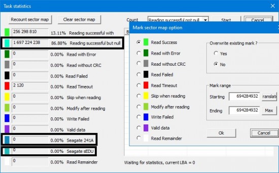

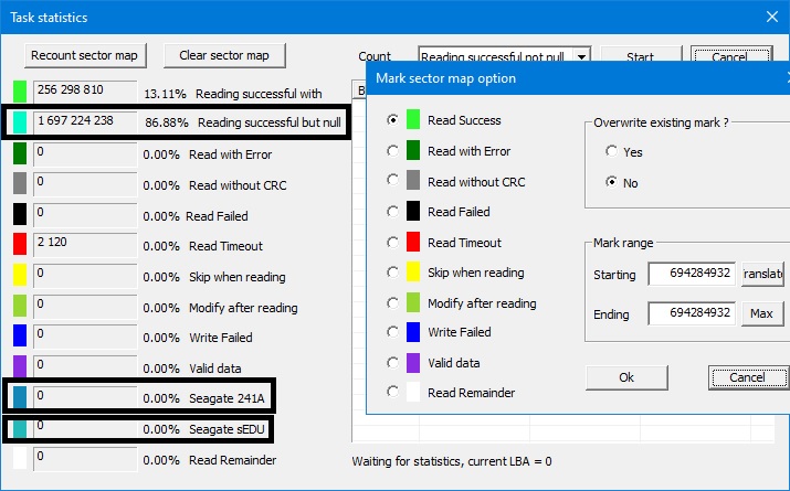

 Post subject: Re: New version of UFS Explorer
PostPosted: October 28th, 2025, 6:27
Posts: 1768
Location: Verona, Italy
in binary mode would be easy to insert (Reading successfull but null), (Seagate 241A) and (sEDU) by just working on binary file in a hex editor.
You just have to assigne this values, example:
On HEAD 0
AZZURRE (Reading successfull but NULL) --------------> [HEX 0A]
CYAN (Seagate 241A) --------------> [HEX 0B]
TURQUESE BLUE (sEDU) --------------> [HEX 0C]
On HEAD 1
AZZURRE (Reading successfull but NULL) --------------> [HEX 1A]
CYAN (Seagate 241A) --------------> [HEX 1B]
TURQUESE BLUE (sEDU) --------------> [HEX 1C]

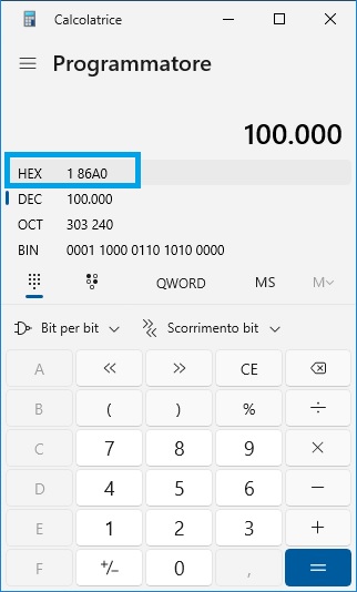

The offset you need to change in hex editor are simple to find in binary mode, example if you have to modify the map from green (Reading successfull) to CYAN (Seagate 241A) at LBA 100.000 (which in head map could be on head 1), you just need to go on offset 186A0 and modify byte "11" in "1B"... at least in old mrt version, but in last version would not hard to modify that.
The question is how to manually modify in hex "list of reanges" map?
Or, can MRT implement the function to mark map with (Reading successfull but null), (Seagate 241A) and (sEDU) ?
