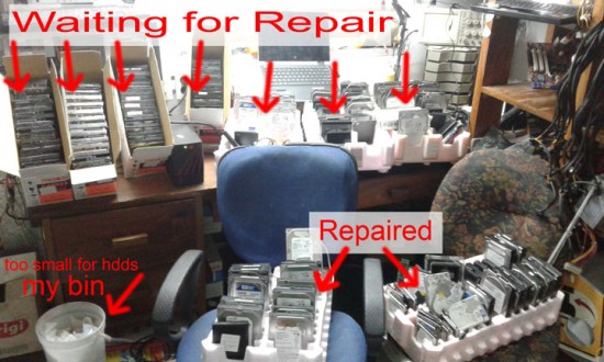

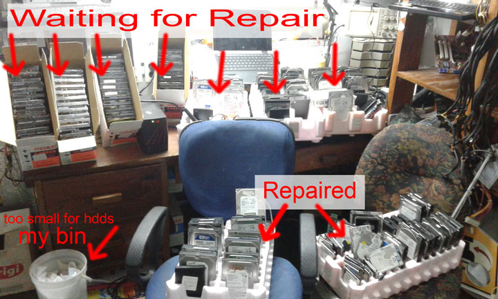

Data-Medics wrote:
I suspect the OP is talking about much older drives he's refurbishing than what most of us are accustomed to recovering data from.
May be this can ilustrate better.
 Post subject: Re: What is the Most Powerfull tool for Seagate Refurbishing
PostPosted: June 30th, 2017, 16:23
Joined: September 20th, 2013, 10:50
Posts: 70
Location: Cuba
Data-Medics wrote:
"I'm sure if he spends some time dealing with ST3000DM001 nightmares he'll come around to our way of looking at refurbished Seagate drives."
There is a popular jokes here that says: "Time is the only thing not missing in Cuba"
Now seriously. ST3000DM001 it is not the only F3 arch hdd we working with, f3 hdds from Pharaop, Wyatt and Hepburn families can be succesfully repaired with Sediv, until today no one has returned to me.
By other way, here major of cases are for hdd repair and not for datarecovery. Generally data is not important by some reasons i don't go to explain now.
Thousands (and not hundreds) of old 775 motherboards with DDR1 and DDR2 memory modules using IDE or SATA 80, 160 and 250GB hdds are still working here for kids gaming or watch cartoons, movies, Series, Sports, Novels...
Buy a 1TB hdd that cost USD $75-$80 is generally too expensive for normal people, who get by work about $20, 30 or $40 per month, so repair 1TB for $10-$15 with 1-3 months guaranteed it is a very good option.
It is a tradition here even if you has a 1 or 2 TB hdd, using as windows system disk and old 80gb sata or ide hdd. There is substantial difference between quality of older drives and the actuals, even from differents manufacturers, not only Seagate.
By other hand, an old 80GB hdd is about $20-$25, thats why it is a good choice even to repair or refurbish a 1TB hdd downgrading to 80-160GB for $10. As you see, there is a lot of posibilities.
