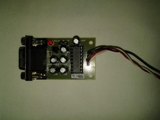

I have a TTL, pls see the picture. Max232N (8CA39NK). I will give it a try.

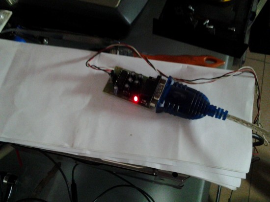

I run a test with the TTL and USB adapter but the terminal screen didn't show anything (blank screen). It was working because the loopback was ok. And this test was performed through my laptop because I haven't found a newer motherboard to my desktop and I won't buy a new one just to do that. I used the Hyper Terminal Private Edition.
 Post subject: Re: Seagate expansion USB desktop 3TB Unknown device, not in
PostPosted: February 27th, 2018, 14:28
Posts: 713
Location: Brazil
That adapter you posted up ther ( the Max232 one ) probably would not work. Just from memory, the levels in the max232 would be about +-5V, and in your hdd you need something able to understand lesse then 3.3V probably. Even a MAX3232 one could have problems.
Also, your adapter gets power from where ? Some get it from the serial port through some creative means, but others need the connected board to provide it ( like modems, routers, etc that have a +3.3V pin in its uart ) .
You will need some adapter like those mentioned by Spildit, or at least some of those people build with old cell phone cables. One based in the CP2104 chip would be easier, as it should support all voltages from 1.8V and up.

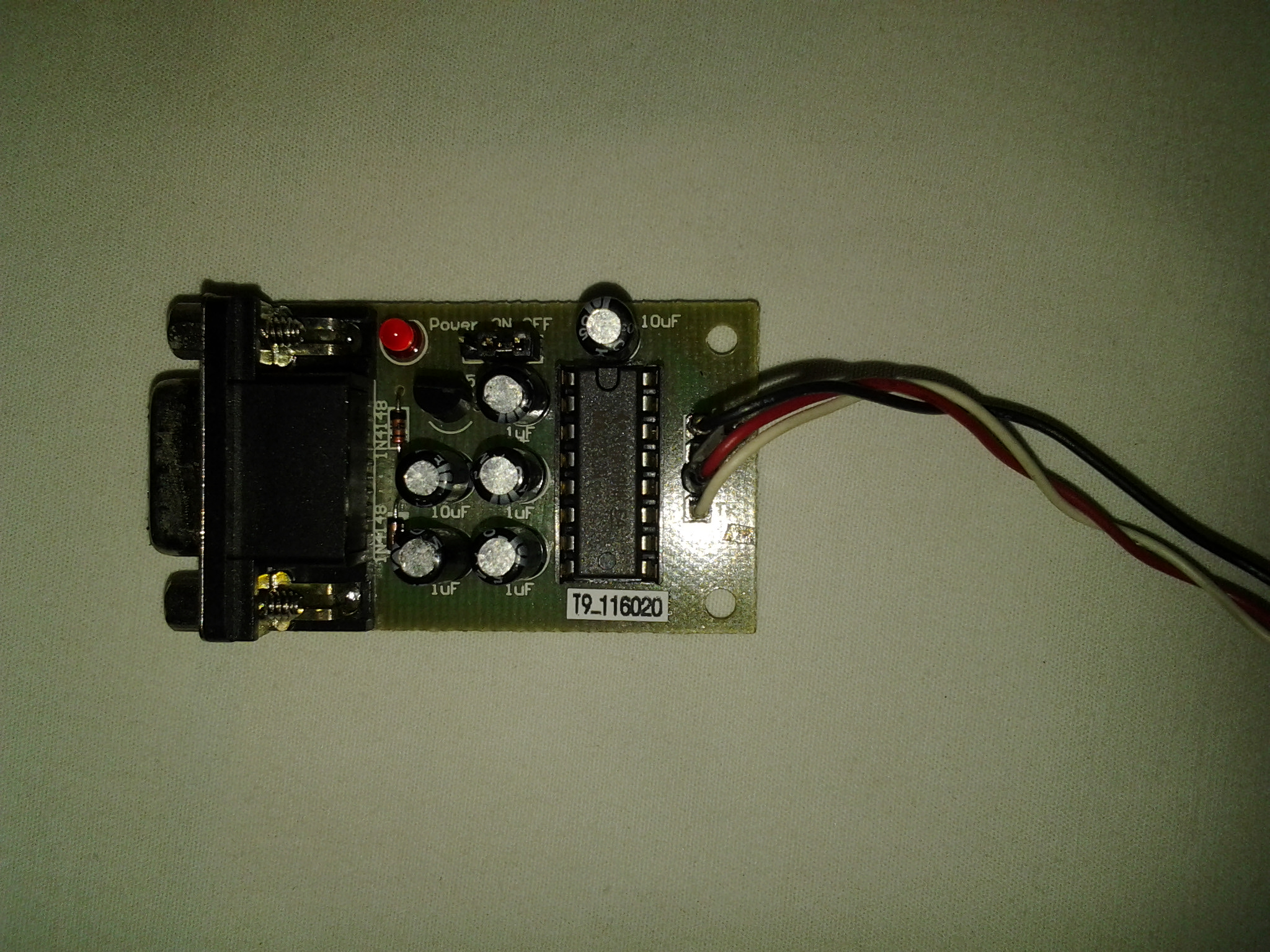

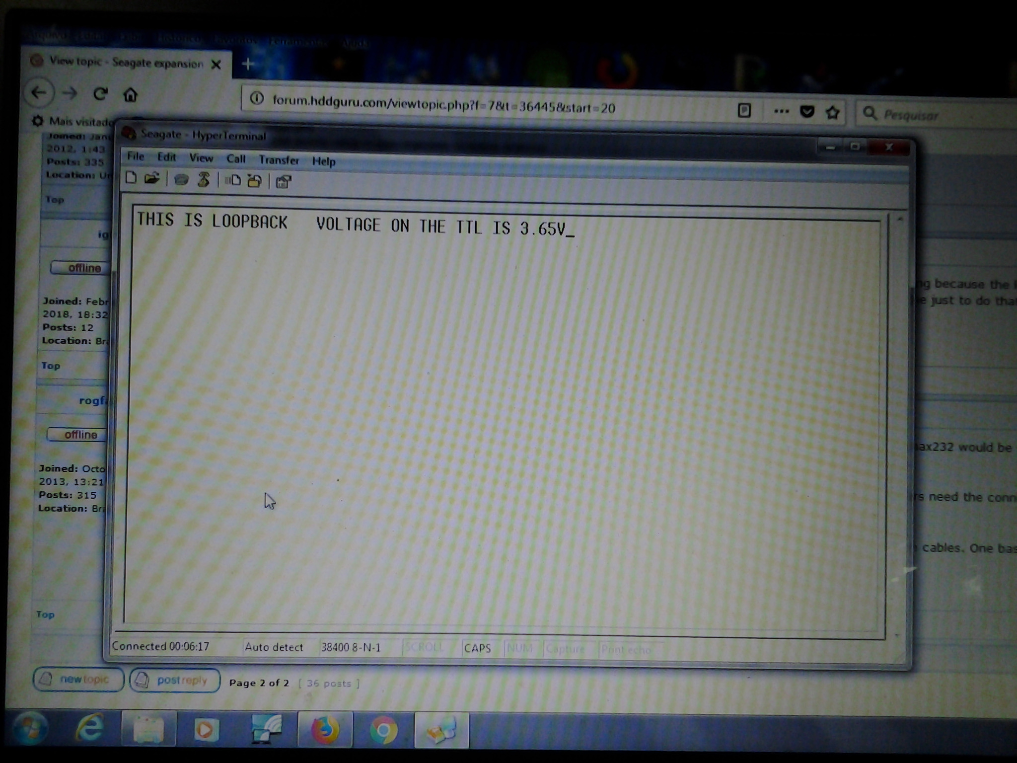

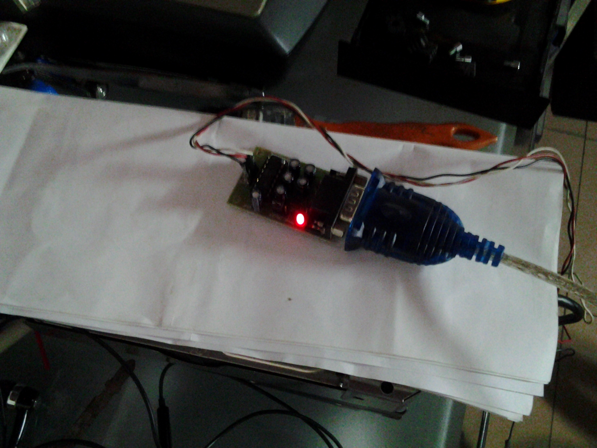

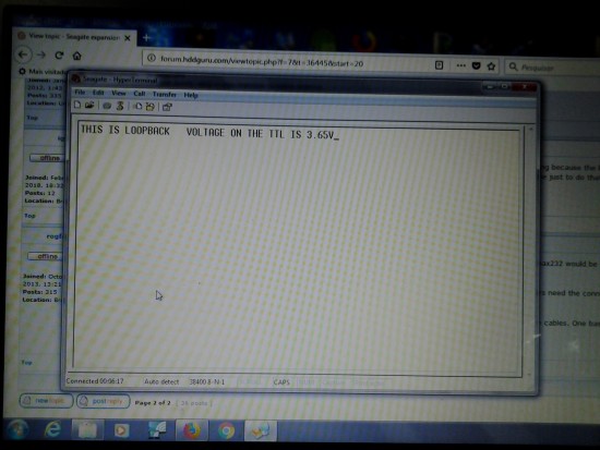

@rogfanther
The TTL gets power from USB port. I use a USB/Serial converter. The TTL board has a jump to turn power on/off as you can see from the picture. If you want power from usb, then you set position off. The voltage was measured from ground and vcc pins on the board when it was on.

So, TTL gets power from USB port and HDD is powered up through my desktop. I worked on a 500gb seagate drive with this TTL a long time ago and it worked fine. It also should work with this 3tb drive.
PostPosted: February 28th, 2018, 18:39
Posts: 713
Location: Brazil
Just to register the correct situation, the ttl adapter ( the max232 circuit ) gets its power either from the rs232 port it is connected to, or from the circuit ( when you connect it to a router, for example ) .
As for working before and now, not necessarily, because that old 500gb drive was probably 2.5 or 3.3V, and this 3TB one can be 1.8V where your adapter may or may not work. If you do not have another working hard disk to establish the adapter condition, start with measuring the voltage levels in the serial port pins of the hard disk. I think @fzakbar explains how to do it in one of his threads.

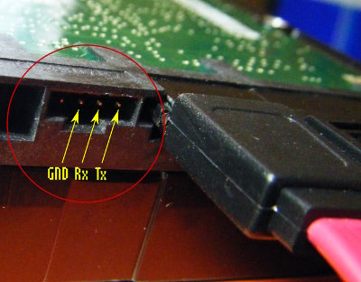

So, does all seagate drive has the same connector pinout as posted before?
PostPosted: March 1st, 2018, 18:47
Posts: 713
Location: Brazil
Yes, it should be. Depending on the terminology used, the picture could mean RX from the drive point of view, or RX from the computer point of view. So, if it doesn´t work at first, swap the rx and tx wires and try again.

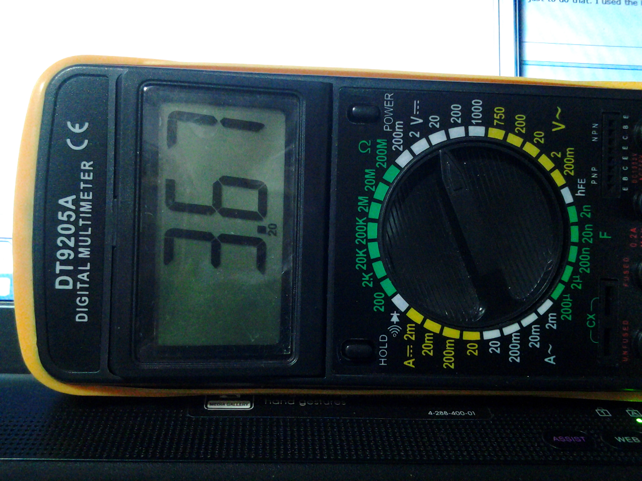

Ok, took the voltage measure from TTL and this 3TB drive as follows:
TTL
gnd/tx = 3.77v
gnd/rx = 2.05v
HDD 3TB
gnd - tx/rx = 1.82v
So, do you think that I need to get other TTL adapter as mentioned before?
