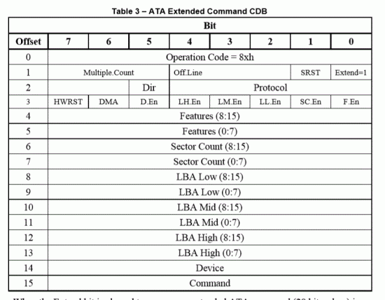

These two documents have conflicting information, probably because the standard was still under discussion:
http://t10.org/ftp/t10/document.04/04-262r1.pdf
http://ftp.t10.org/ftp/t10/document.04/04-262r8.pdf
However, it would appear that one should be able to send software (SRST) and hardware (HWRST) resets via ATA Command Pass-Through.
When the HWRST bit is set to one, the SCSI device ignores all other fields with the exception of Off.Line. The host controller shall issue a hard reset to the device. For PATA this is a Pin 1 reset, for SATA this is a COMRESET.
When the SRST bit is set to one, the bridge ignores all other fields with the exception of HWRST and Off.Line. The ATA device shall execute a soft reset (SRST) as defined in ATA/ATAPI-7 unless the HWRST but is also set to one. If the HWRST bit is set to one, SRST is not performed.
First, I have not been able to get that to work in Linux, the passthrough always responds with invalid command. Trust me, I have tried.
Second, those resets can only be done at the hardware level of the driver, you can't just pass them through USB via SCSI commands.
There is a part if me that wants to call BS on the soft and hard reset capability that is claimed. But they MUST have some form of resets that do something at the USB level that could be considered similar in some way to a soft and hard reset, to be able to make that claim. But they make it sound the same as a hard drive soft and hard reset. Smoke and mirrors I say...

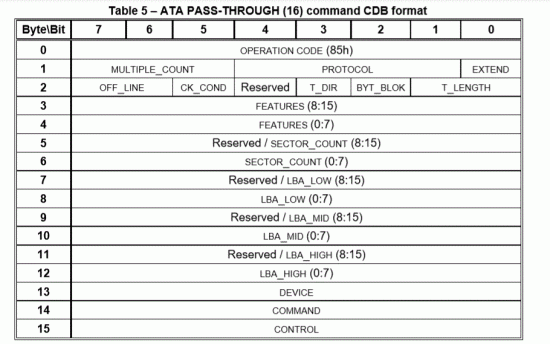

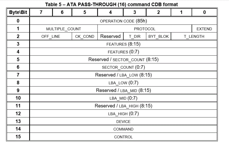

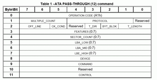

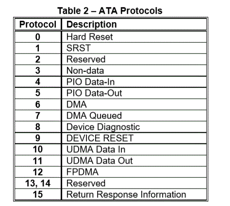

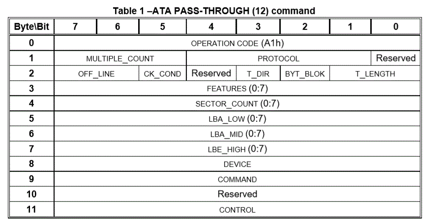

I'm not sure I understand. If DeepSpar intercepts the USB connection between the host and device, why should it not be able to independently implement the SRST and HWRST features in the pass-through standard?
As for Linux's rejection of your attempts to implement SRST and HWRST, which words in the pass-through command packet can the user control? If some words/bytes are under your control, then why not all of them?
To perform soft or hard resets on a SATA drive requires directly manipulating bits in the AHCI IO memory. How could you possibly do that through USB? There are no commands for that. The IO part of the passthrough is controlled by the OS at the driver level.
http://www.hddsuperclone.com
Home of HDDSuperClone
 Post subject: Re: New DeepSpar USB Stabilizer
PostPosted: March 23rd, 2019, 20:13
Posts: 991
To answer what I have control of in Linux for the passthrough, the answer is I can set all fields.

To further answer about the lack of support of the passthrough resets, I asked myself why it was not supported like it should be in Linux. And after really thinking about it, along with my experiments, a possible answer became somewhat clear. Performing some sort of reset using the passthrough could possibly interrupt the normal operations of the OS, and cause a system crash. That is the best reason I could come up with for the resets not being supported.

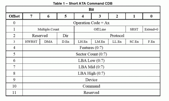

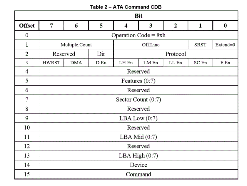

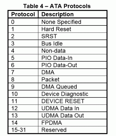

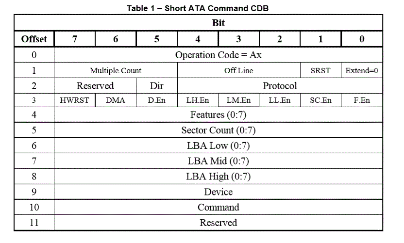

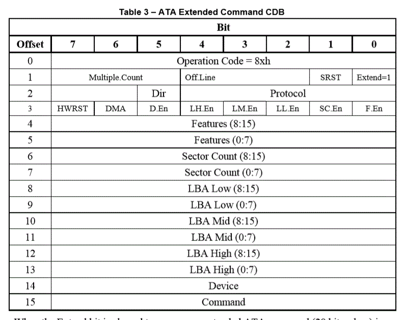

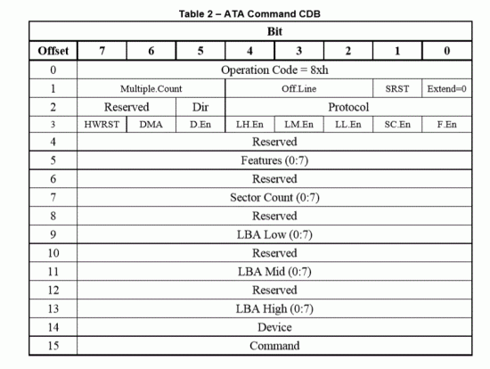

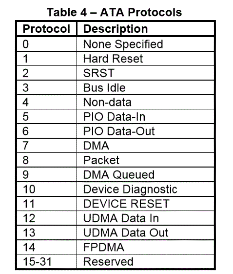

I wonder if the developers/programmers were at all confused by the docs:

AIUI, CDBs transmitted via ATA pass-through are transparent to the OS. That is, the packet is delivered to the target without its contents being inspected by the host. I could be misreading the standard, though.
Let's say that the OS retries a standard Read command (via SCSI-ATA translation) up to 15 times. If that same unreadable sector is accessed via an ATA Read Sector command encapsulated within a CDB packet, I would think that the OS would be unaware that the drive is processing a read. Is it possible that pass-through errors are processed in a different, less aggressive manner?
