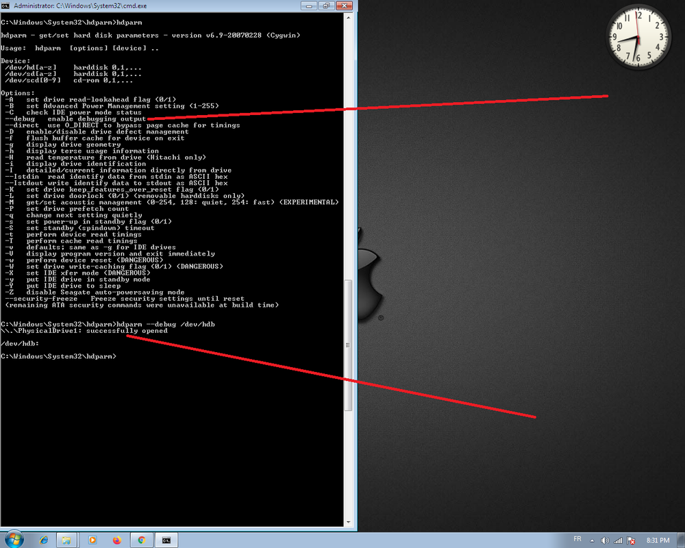

 Post subject: Re: Help Me To Repair This Hard Dick Please !! ♥
PostPosted: May 27th, 2020, 16:44
Joined: May 18th, 2020, 13:28
Posts: 22
Location: casablanca
I'm Try This Option ( --security-freeze ) But It's Failed
And I Try This Option ( --debug ) ... It Was Successfully :D
What Did Means This Option ( --debug ) ???? :?: :?: :?:
PostPosted: May 27th, 2020, 18:43
Posts: 4848
This Method Just For Hard Disk SSD !!! :cry: :cry:
that page only said the method only works on SATA and PATA HDD and SSD.
So you have nothing to worry about.
I have no experience with hdparm, can't help with that, but it should be straightforward.
you don't have to set freeze lock, it is already locked, start erasing it using the default master pwd.
Btw, from ata specs:
The security level is set to High or Maximum with the SECURITY SET PASSWORD command. The security
level determines device behavior when the Master password is used to unlock the device. When the security
level is set to High the device requires the SECURITY UNLOCK command and the Master password to
unlock. When the security level is set to Maximum the device requires a SECURITY ERASE PREPARE
command and a SECURITY ERASE UNIT command with the master password to unlock. Execution of the
SECURITY ERASE UNIT command erases all user data on the device.
The SECURITY FREEZE LOCK command prevents changes to passwords until a following power cycle. The
purpose of the SECURITY FREEZE LOCK command is to prevent password setting attacks on the security
system.
It says if the security level is high you can unlock it with the master pwd.
Identify sector word 92 gives you the Master Password Revision Code, which should be FFFE if the Master pwd was not changed, ie it is the default string i sent above.
Identify sector word 128:
15-9 Reserved
8 Security level 0 = High, 1 = Maximum
7-6 Reserved
5 1 = Enhanced security erase supported
4 1 = Security count expired
3 1 = Security frozen
2 1 = Security locked
1 1 = Security enabled
0 1 = Security supported
so if bit 8 is 0, you have Security Level set to high, so it is possible to use the master pwd to open the device without erasing it. So open and disable pwd should be working.
if it is 1, you need to send Security Erase Prepare (0xF3) command followed by Security Erase Unit (0xF4) command with an 512byte data block containing 01 00 53 65 61 47 61 74 65 2E 2E 2E 2E 2E 2E 2E 2E 2E 2E 2E 2E 2E 2E 2E 2E 2E 2E 2E 2E 2E 2E 2E 2E 2E
and the rest should be 00.
that hdparm says a note about 'the remaining ATA security commands were unavailable during build time', which probably means it is not implemented.
So you need some different way of opening it.

Thank You Sir Very Very Much For All Information That You Gave Me ♥♥♥ .... So What I can Do Now ?? :?: :?: :?:
PostPosted: May 28th, 2020, 4:54
Posts: 4848
To be honest i am not quite familiar with free tools, i only know mhdd can send those commands, check the docs here:
https://hddguru.com/software/2005.10.02-MHDD/mhdd_manual.en.html#id
there is also Magic boot disk available for download with MHDD 4.6 included, because you will have to boot to DOS.
