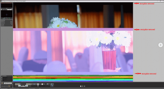

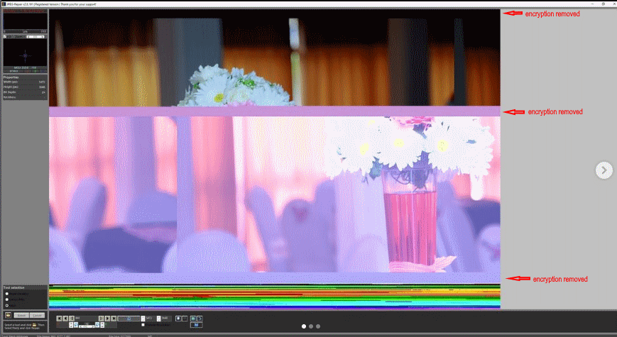

Arch Stanton wrote:
einstein9 wrote:
@ StylishJedi
@ Arch Stanton
The VM is encrypted there is no way on earth to read whats inside it without decrypting

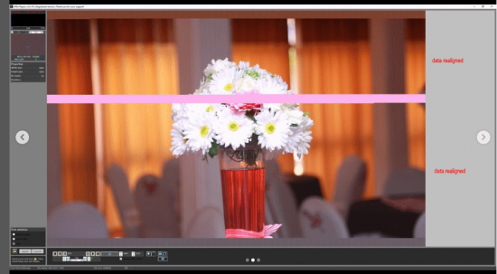

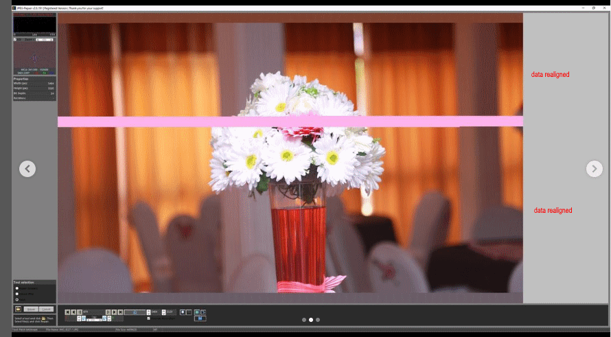

Yes! But as I mentioned earlier and showed using the JPEG example the ransomware does not encrypt every byte of the file. It encrypts 'bands' so to speak. What I do not know is the percentage that actually gets encrypted. So this is what I'd be examining and try determine if larger files have a chance of surviving. So, interval and number of bytes that's encrypted. And see if UFS for example can handle the missing portions and treat it as if it were file system damage/corruption.
So, I tried to see if I could find how much per file gets encrypted, but I do not have these files anymore and I didn't document how many bytes I removed from the JPEG I repaired, it was just proof of concept. But it's evident that majority of data inside the encrypted file remains untouched.
But this (https://www.malwarebytes.com/blog/news/ ... ransomware) analysis of one particular variant suggests that only 3 chunks of 262144 bytes are encrypted. So peanuts compared to GB's worth of VHD. But we already knew only partial encryption takes place simply by looking at result of the Kernel tool scan. So again, perhaps UFS will do better, and if not it may be possible to realign data inside the VHDX file just like I do with the JPEGs.
