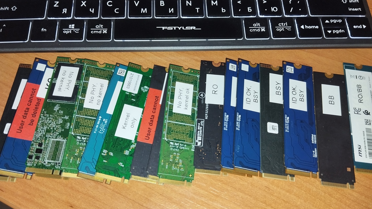

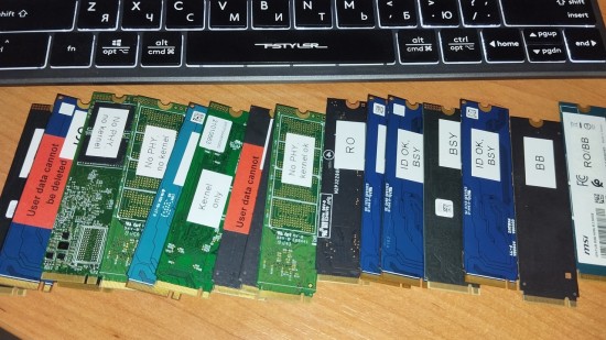

maximus wrote:
I also didn’t have any failing NVMe drives to work with, so it would have been difficult to test for real world results.
I bought a few... 8)

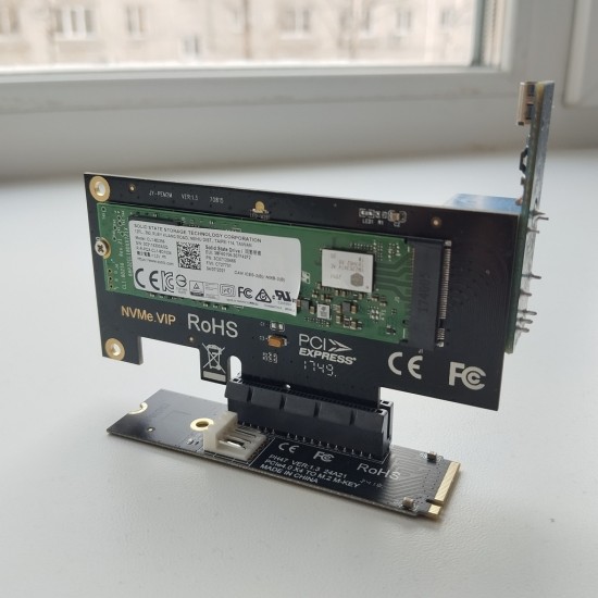

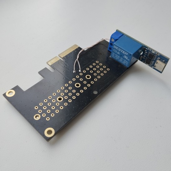

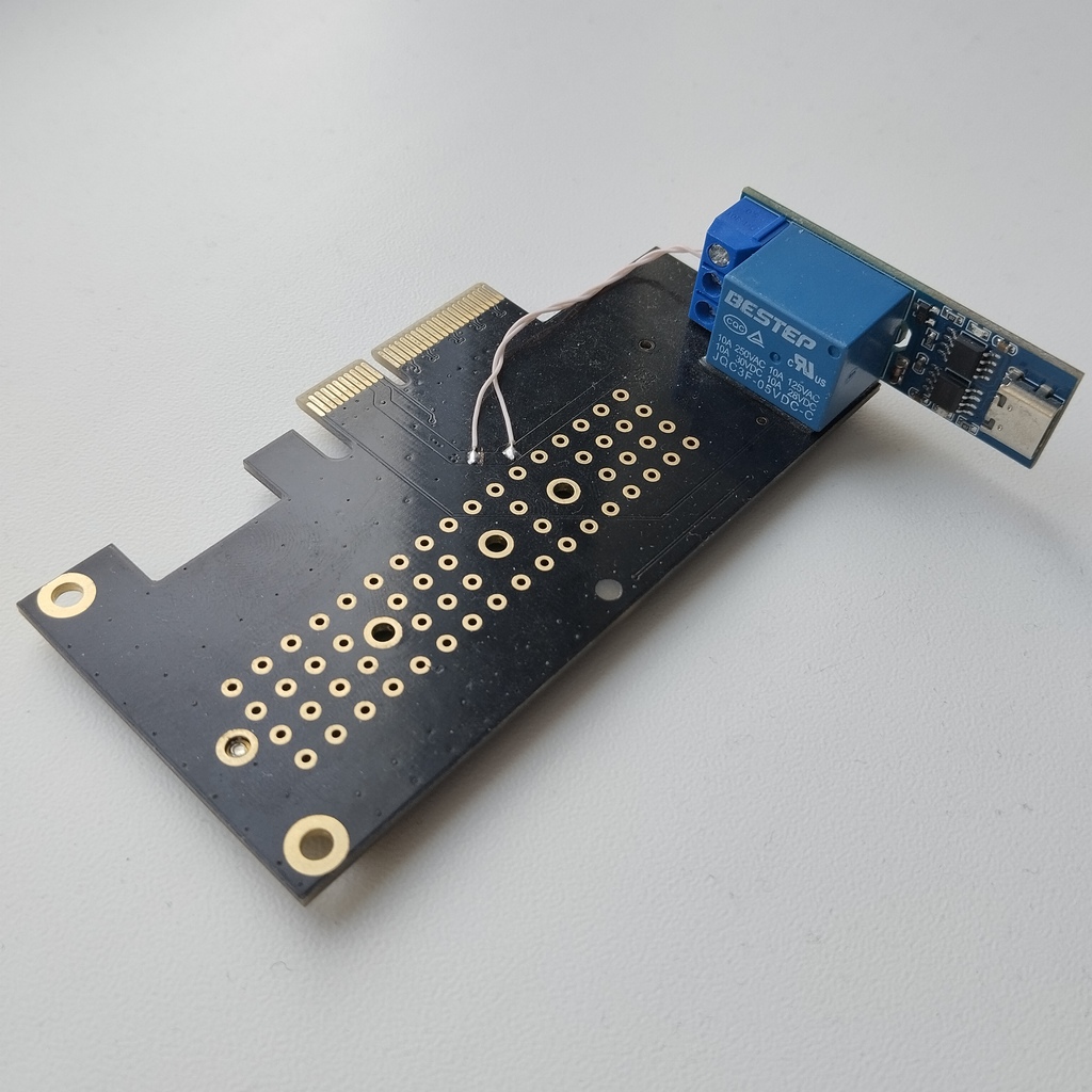

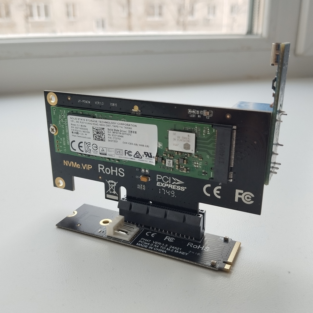

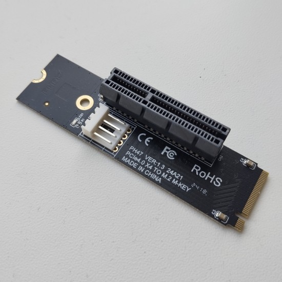

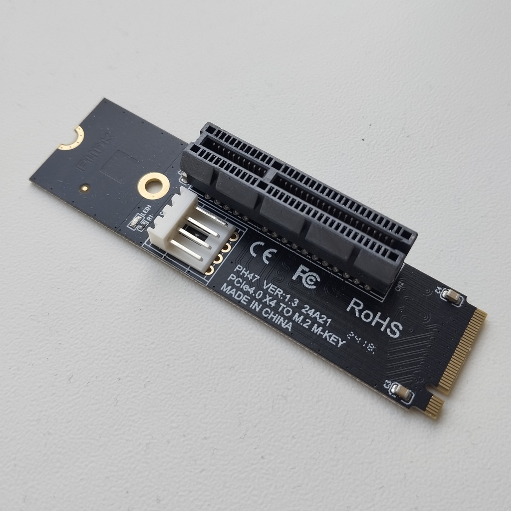

New toy arrived. I bought this to check how PCIe hot-plug works in M.2 slot. Actually there is no difference, works well as in regular PCIe slot. The only condition: a mainboard chipset must to support hot-plug capability.
alexander@asus-b760m-plus-wifi:~$ sudo lspci -vv | grep -e "PCI bridge" -e "HotPlug+"
00:1a.0 PCI bridge: Intel Corporation Device 7a48 (rev 11) (prog-if 00 [Normal decode])
SltCap:   AttnBtn- PwrCtrl- MRL- AttnInd- PwrInd- HotPlug+ Surprise+
00:1d.0 PCI bridge: Intel Corporation Device 7a36 (rev 11) (prog-if 00 [Normal decode])
 Post subject: Re: Another useless data recovery toy?
PostPosted: December 26th, 2024, 7:40
Posts: 1312
It's looking increasing more useful as recovery / diagnosis tool.

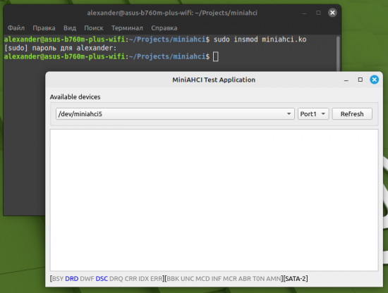

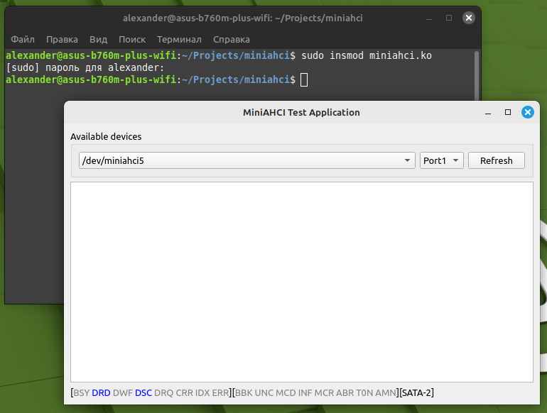

MiniAHCI kernel module basic test: ATA status and error registers are received. Current link speed detection also works fine. Tested with JMicron JMB362 PCI-e SATA AHCI controller.
In DRD+DCS we trust! He-he-he. 8)
