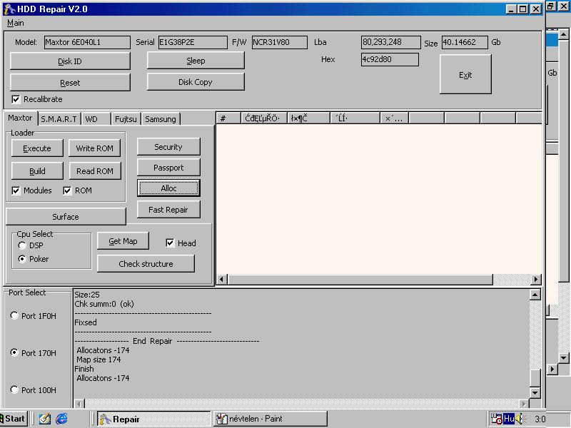

Screenshot after the Alloc function.

ALLOC could probably be merge G>P but not looked deeper at this software

Iszerda wrote:
Hi all!
What is the function of the 'Alloc' botton of this software?
I tried to guess it, but I am not sure...
Alloc button shows the G-list of a Maxtor drive. If the G-list is empty you'll see nothing... :D

It is almost impossible (till now) to decompile to Identical source code. So you cannot recompile it without doing extensive changes .but I extracted forms, objects, and assigned event addresses, propeties,this is meant to answer The question about Aloc bottom only , you may load the project find the form containing Aloc bottom click it will show you the corresponding code. Study that part of code to find out what is trim not posting more detail since I don’t really have the knowledge and don’t know the down falls of doing this. Someone else might be able to do that in a safer way.
