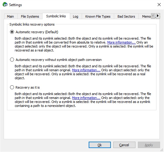

 Post subject: Re: New version of R-Studio
PostPosted: May 9th, 2016, 9:15
Alt(R-TT) wrote:
A new version of R-Studio: a new data recovery kernel that improves data recovery speed and results, symlink recovery options in the Technician version, extended attributes and journals for HFS+, Ext3/4fs, and UFS, compressed files for HFS+. Plus more improvements and bugfixes.
First off, why are USERS, ProgramData, Documents, Desktop, Music, Pictures and Videos folder tagged as a symlink when they are not?
With version 8, which of the three options will just interpret a symlink as a shortcut file and just treat it as such? That is, the symlink for "Documents and Settings" should just copy the .lnk file as a .lnk file. Users is an actual folder, so it should copy the folder and its contents.

lcoughey wrote:
For me it does not work.
Non of the three options will just interpret a symlink as a shortcut file.
Symlinks are also still handled in Folder View, if you select a folder r-studio will still mark and select files in linked folder.
PostPosted: May 9th, 2016, 11:12
Yup, I think we'll continue to use UFSExplorer and am not sure I'll waste my money paying for another year of R-Studio updates...it hasn't worked since my last update.
