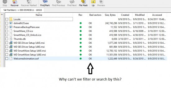

Does this take into consideration the DeepSpar map?

No, only R-Studio internal estimations.

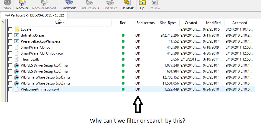

Dang. I really wish that your team would add it. It seems weird that I can see the files that have bad sectors, but have no way of filtering or sorting based on that information.

We'll do this soon. But no dates promised.

That would be awesome. I've been asking for it since the integration with DeepSpar, so a little more time won't hurt.

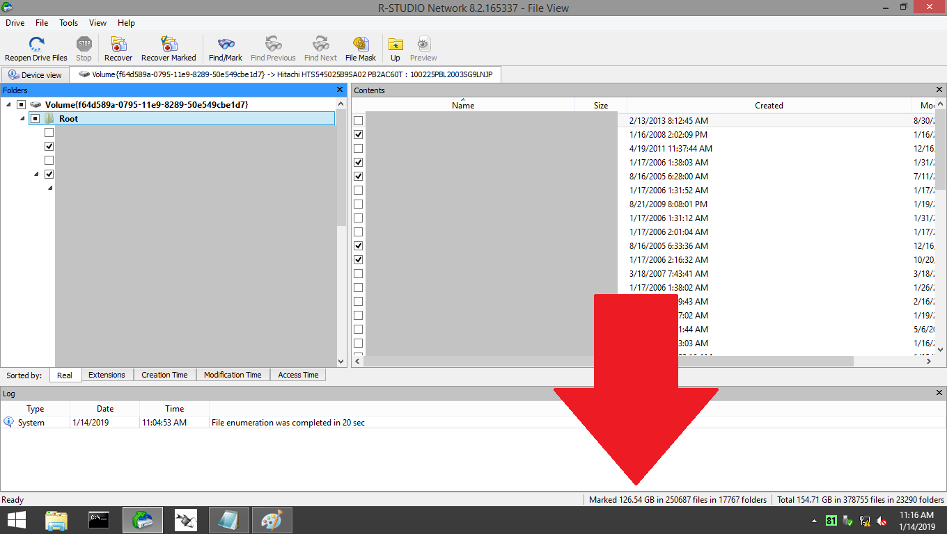

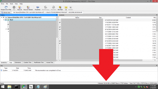

Hi its a great app, but where we can see size of recovered folders? is it possible? if not please add, thanks.

Select the folder and look at the volume that shows on the bottom of the window.

I don't see what you say, maybe you can show me with picture?

Thanks.

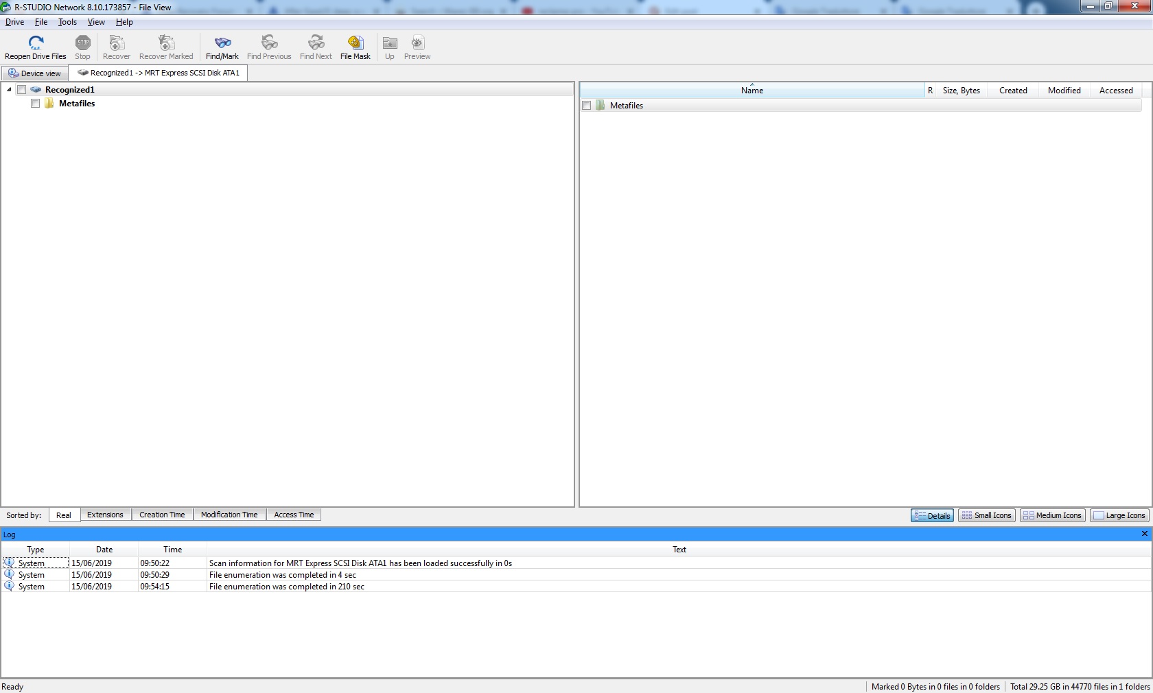

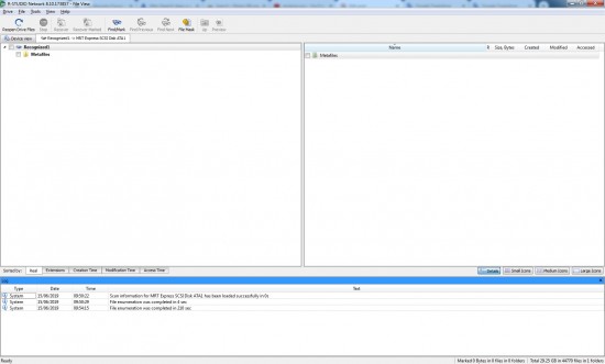

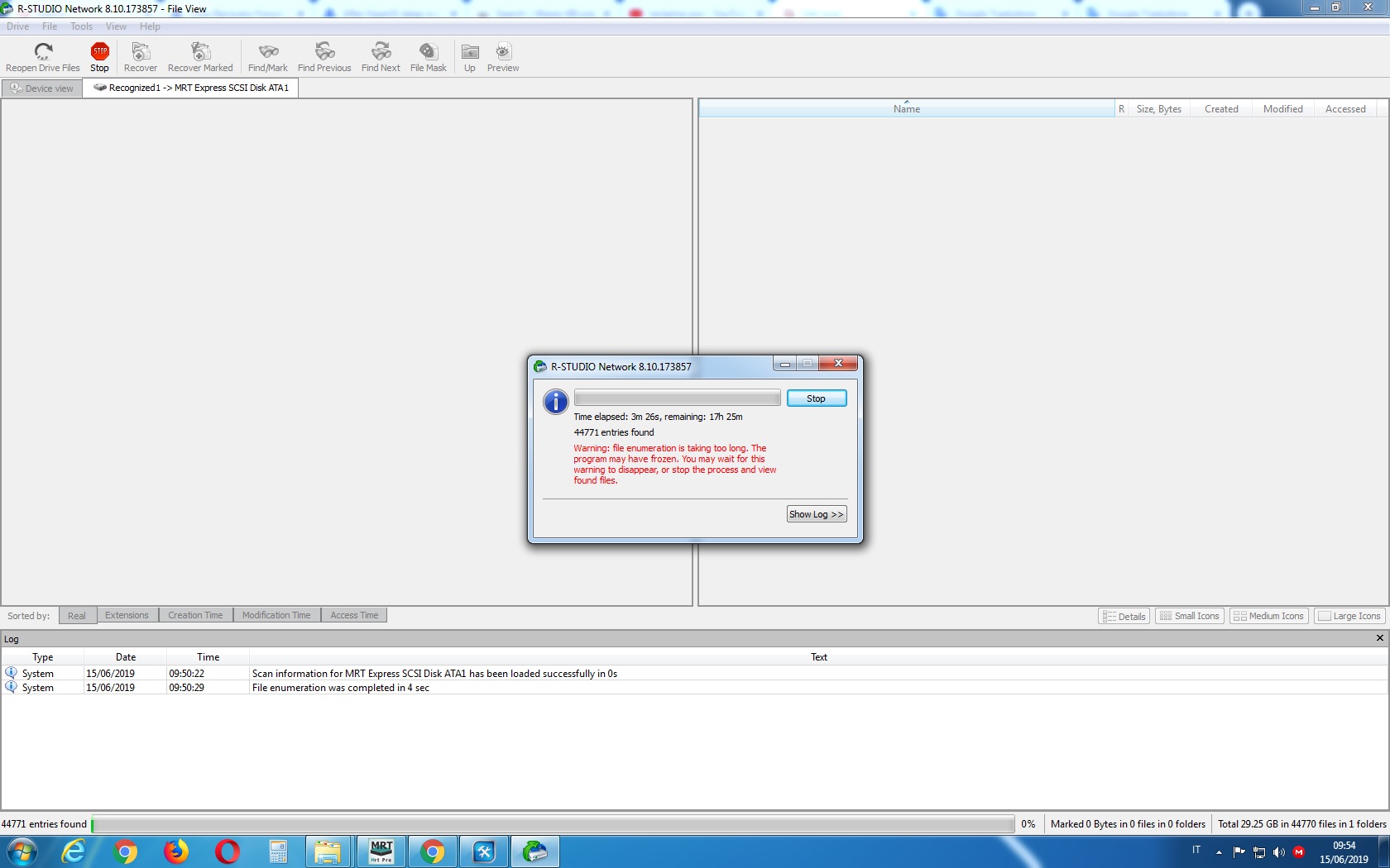

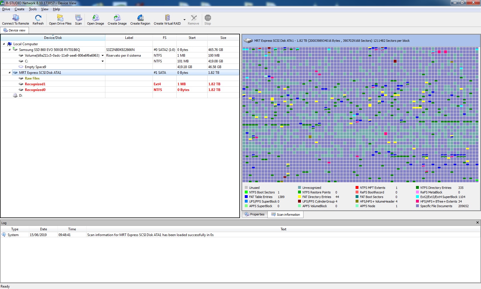

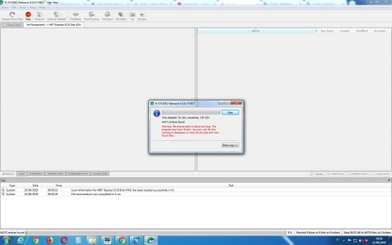

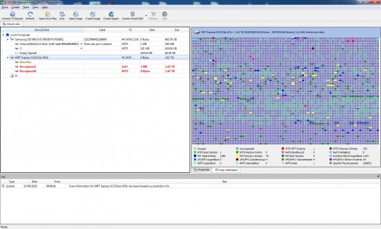

I've 2TB WD hdd which has 6 heads, one head is dead (head 0) so i cloned just those 5 readable surface.
This drive has EXT4 partition, customer needs to recover only few pics, so if he's lucky, i don't have to swap head assembly if i'm able to find residual of logical structure in the partition with a complete scan under R-Studio.
Because R-Studio can't detect the partition instantly due to missing information, i thought that hopefully i would find those pics after many hours of surface scan. Unfortunately it was just about a totally wast of time.
This is what R-Studio shows me after complete scan:
I can recover pics only in RAW, it would be a better recovery if i could rebuild a glimmer of logical structure.

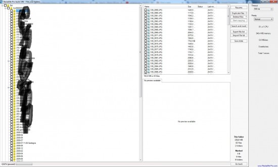

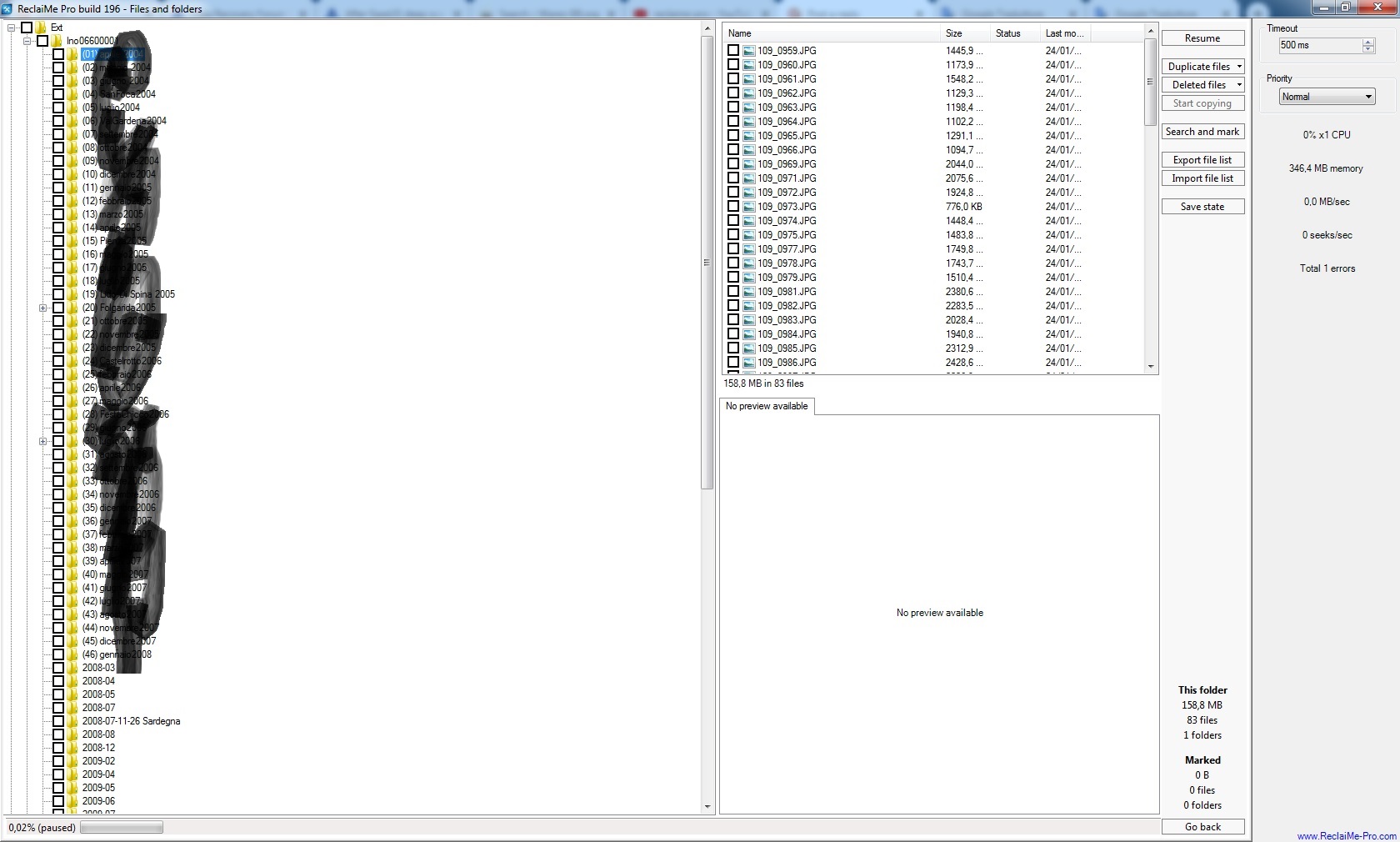

I tried ReclaiMe Pro and it was able to find partially logical structure without scanning all surface, in few minutes :D
