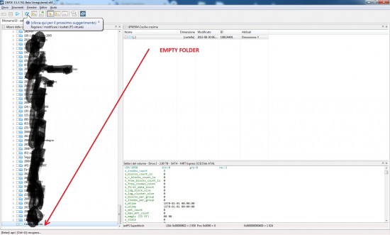

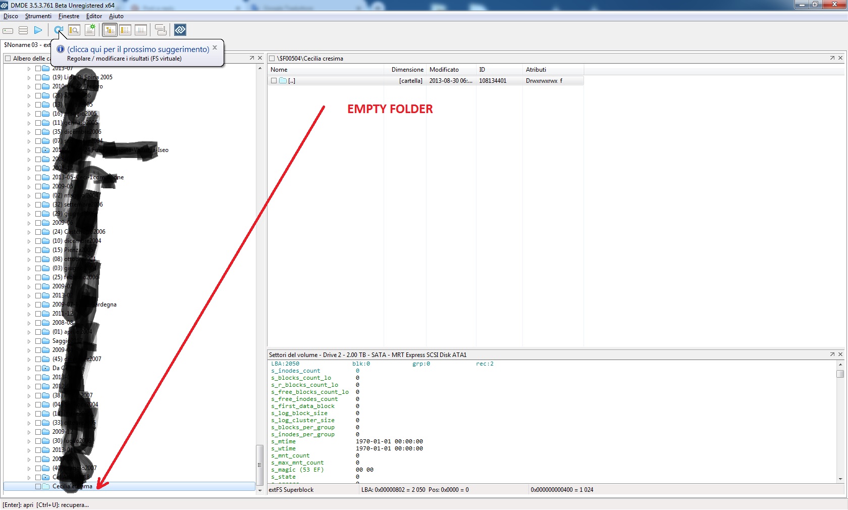

I did full scan surface this partially cloned drive with new DMDE 3.5.3.761 Beta version.

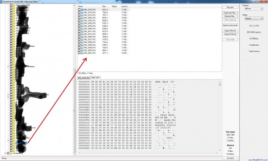

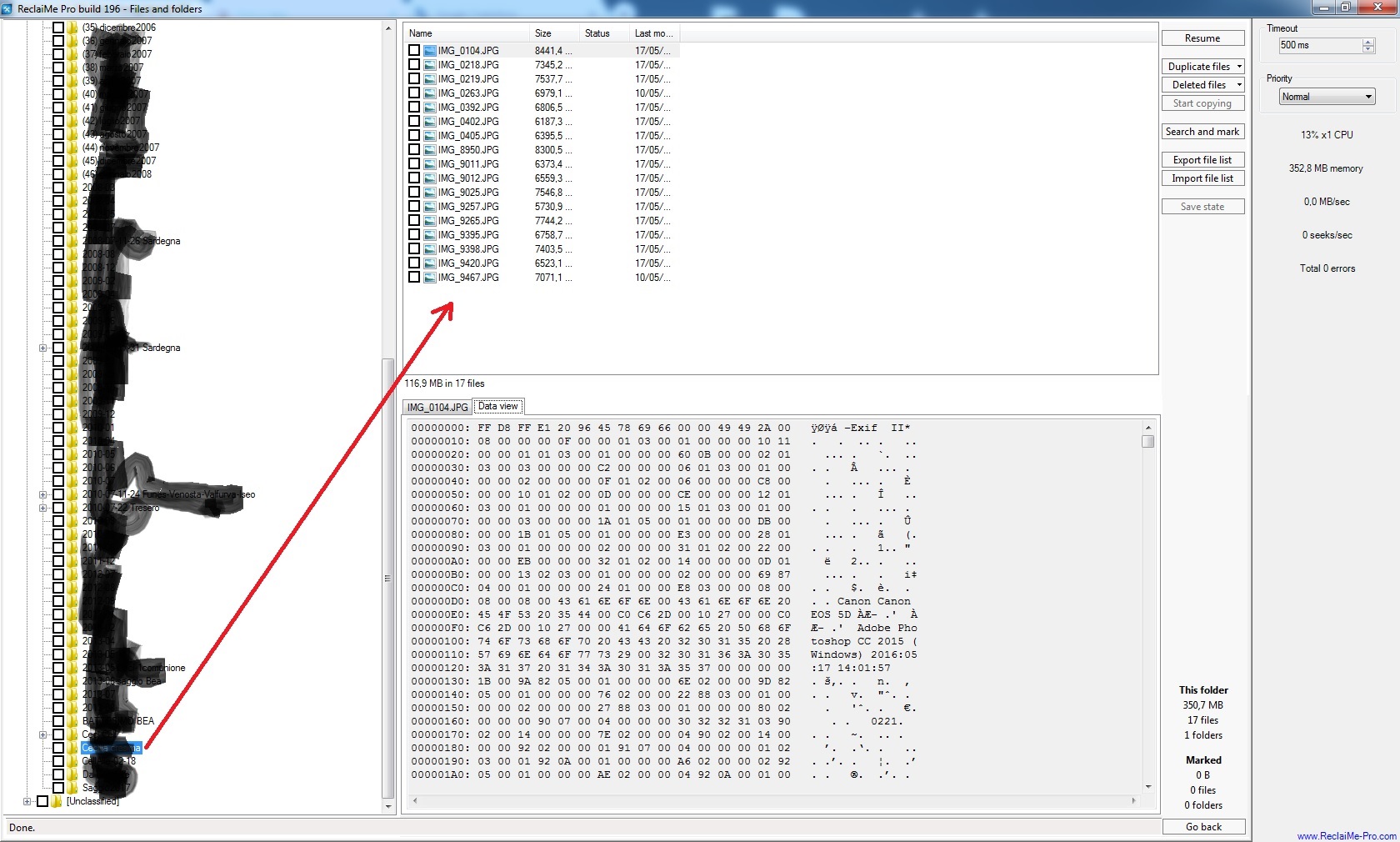

Result apparently seem to be pretty good but ReclaiMe Pro (build 196) gives better result (at least in this case).
DMDE last beta version has found same folders than ReclaiMe Pro (build 196), but one of those folder in dmde is empty instead ReclaiMe Pro shows 17 jpg in perfect conditions in that folder.
So i think Reclaime Pro build 196 is very good for recovering data from partially cloned drives (at least for EXT4 filesystems), i've to say that i also did complete scan of the cloned drive under Reclaime Pro build 1872 (which should be newer version than build 196) but it totally fail. :?
Build 1872 didn't find any good file by analyzing the filesystem, it found a lot of fragmented junk. Also it didn't found folder structure as quick as build 196 (and folders were much less), it found folders only when full scan was about 70% complete (if i remember well).
DMDE detected the filesystem very lately as ReclaiMe Pro Build 1872, but it was able to find just about all files as ReclaiMe Pro Build 196 (exept that folder which i mentioned above)
