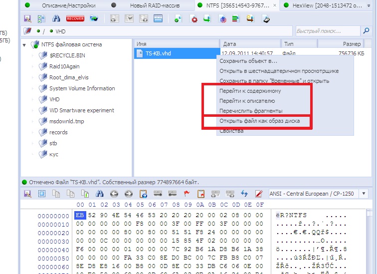

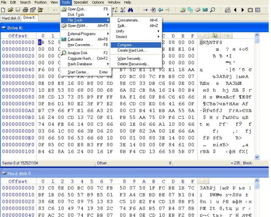

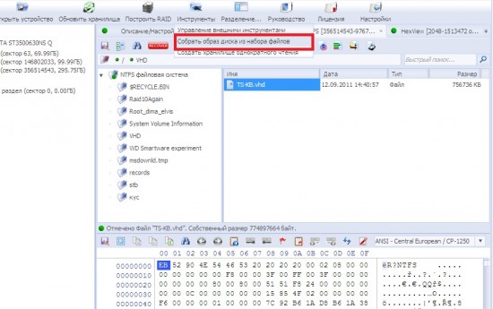

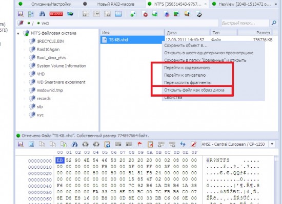

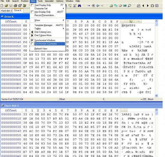

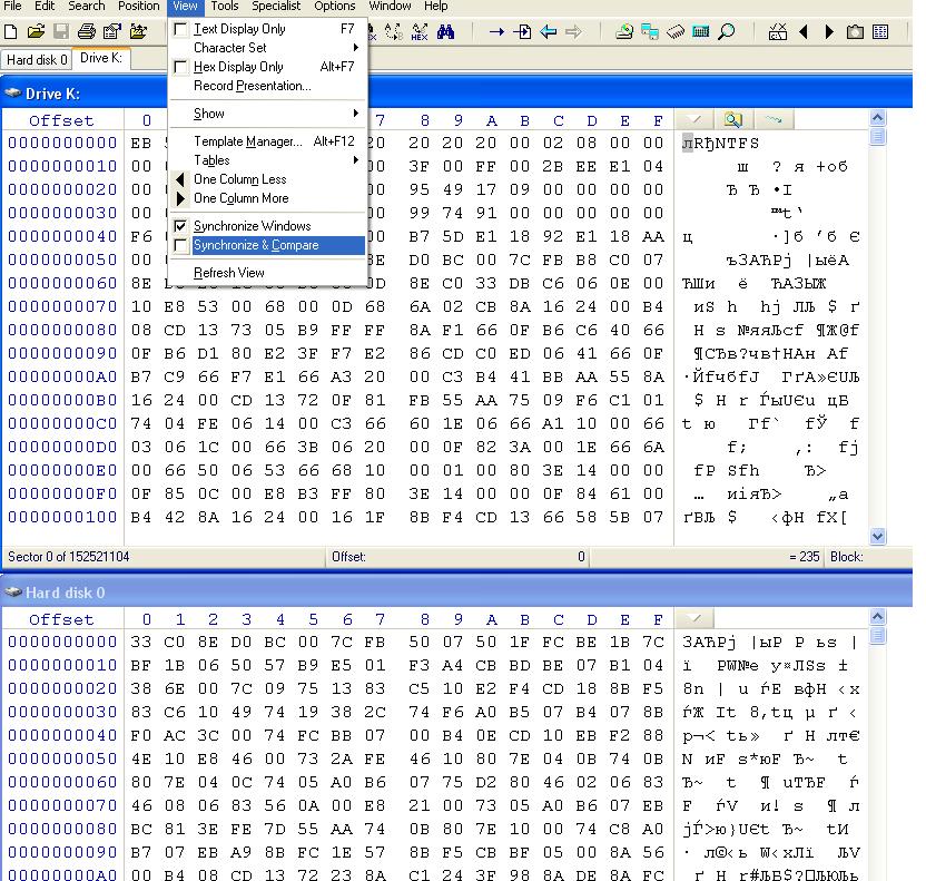

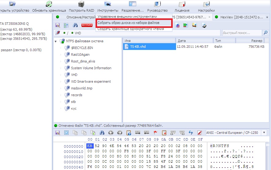

Alt(R-TT) wrote:
DR-Kiev wrote:
Can you name a few, except file systems?

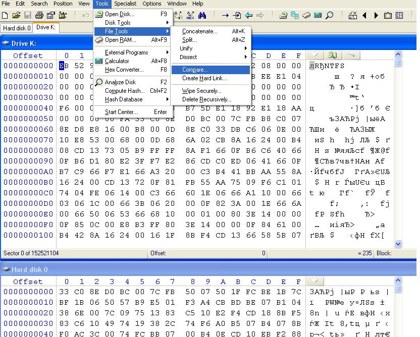

Too much to name.
Very small part of them:

The only thing I see is Files -> Synchronize & Compare.
RAIDs with parity is on the way, you already can open a file as a disk image. And I don't quite understand what "Assemble a disk from a set of files" means.
I think you are mistaken
R-Studio can open raw image files but it can't open VHD containers. R-Studio also doesn't support delayed parity (I think In Winhex it's called Compaq RAID)

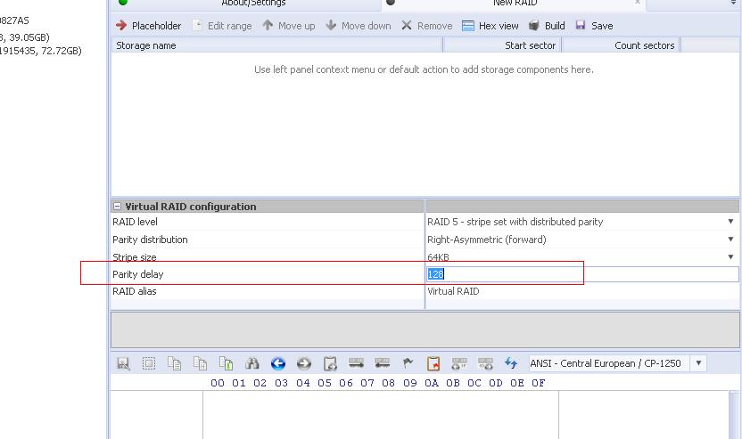

Yeah, I understand now.
RAIDs with delayed parity in on the way, though.

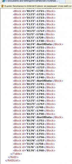

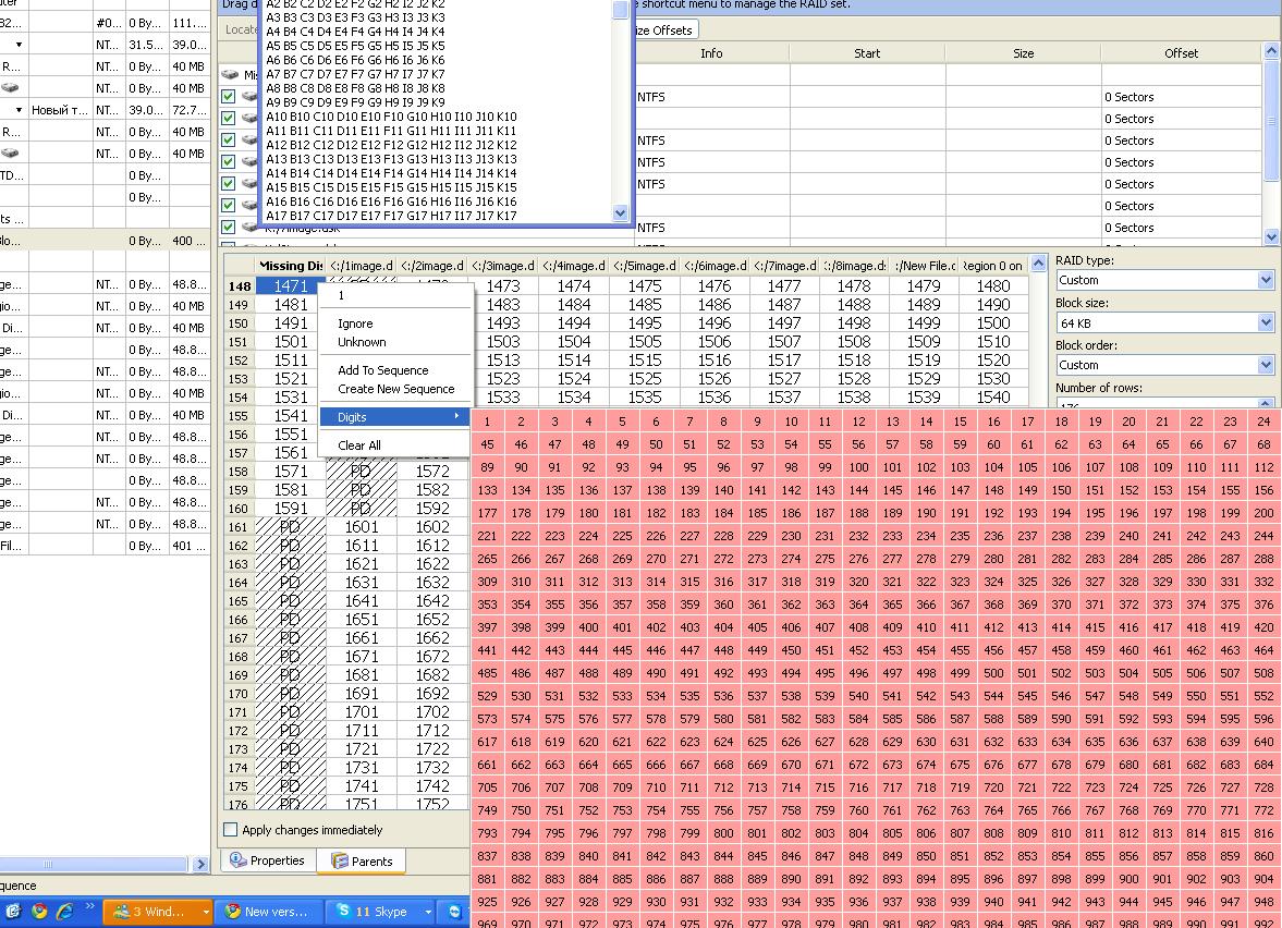

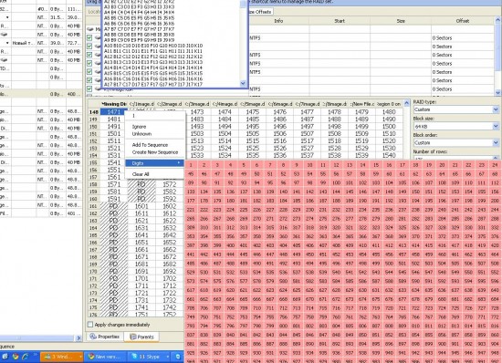

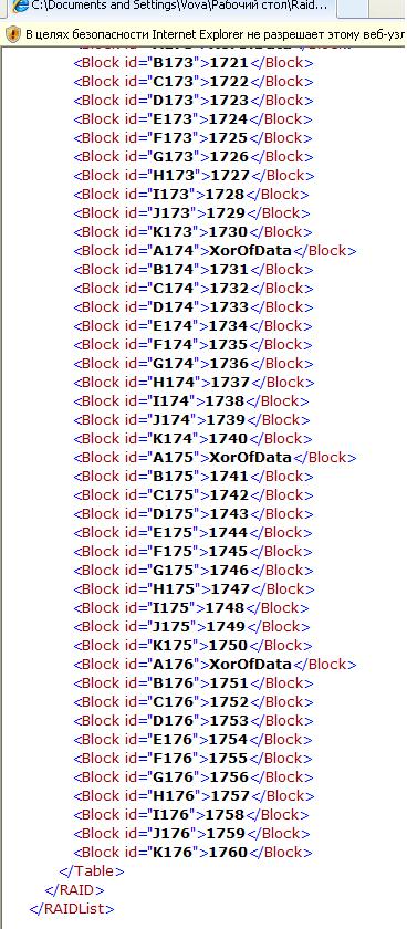

ReclaiMe wrote:
Doomer,
R-Studio does in fact support Delayed Parity, it is just sort of boring to enter. You need to draw your own block diagram each time.
Right , especialy when digits always somewhere in Cyberspace (out of screen) :mrgreen:

ReclaiMe wrote:
Doomer,
it's not support - it's PITA

Dr. Kiev, you'd be probably better off scripting the XML file, via Excel or something, with that number of drives, eh?

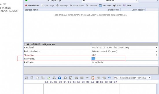

What have done many times. :mrgreen:
Now, i don't use r-studio quite often because of this.
In other Sw you can set 16 delays quite fast.
What about yours SW ? Any good capabilities in this way ?

Suppose not. Our software is for end-users, one-button, fire-and-forget, either it works or it does not. If you need fancy configurations, you're not going to like it.
