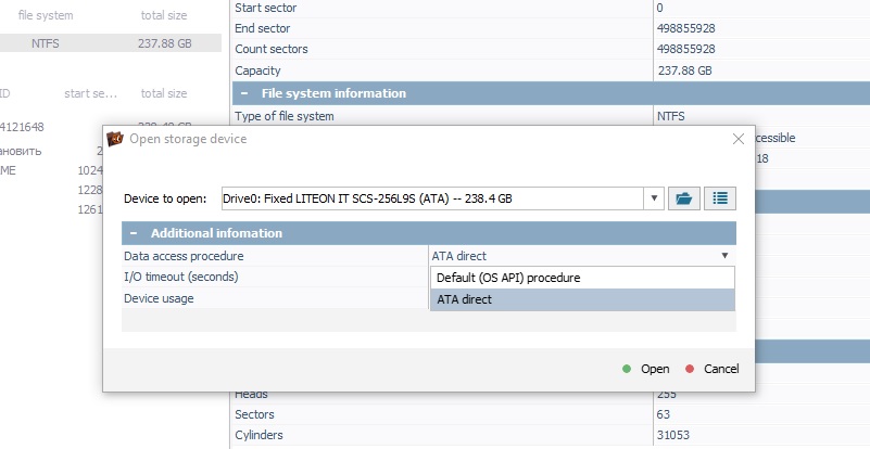

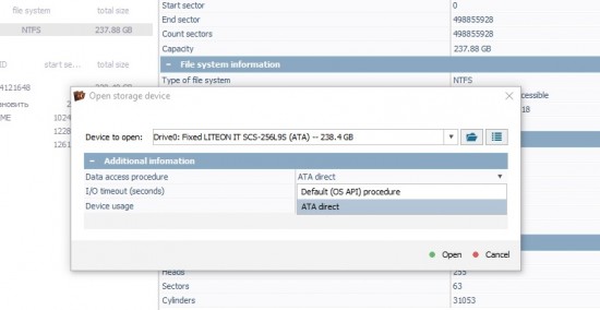

I dont have anything against HDDsuperClone but i have something against your knowlege about Ufs Pro . Yes it does, you can read/image drives not just simply using OS API procedure, but to chose different ways, like ATA direct or SCSI commands for SAS/SCSI drives, and other usefull features which you missed, probably, also.
