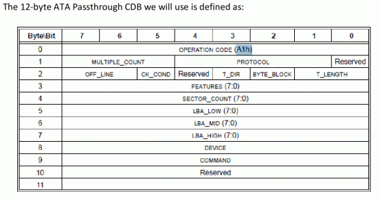

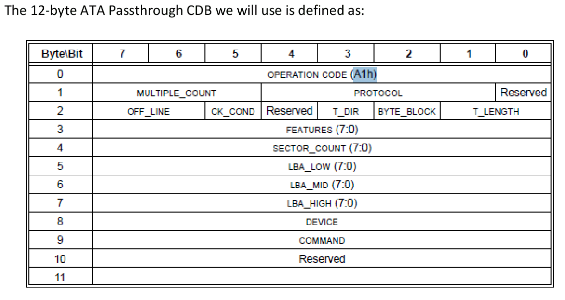

This document explains the structure of the 12-byte ATA Passthrough CDB:
Using SAT to access SATA drives:
http://www.scsitoolbox.com/Pdfs/UsingSAT.pdf
I'm still looking for the other bytes ...

Yes, I know about the ATA passthrough, hddsuperclone uses it. I want to know about the encapsulating USB part, which is part of the USB Mass Storage Class.

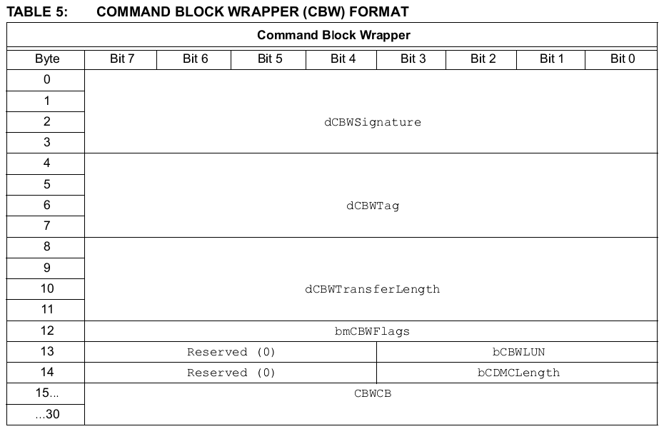

 Post subject: Re: New DeepSpar USB Stabilizer
PostPosted: March 25th, 2019, 17:19
Posts: 17323

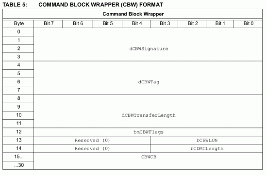

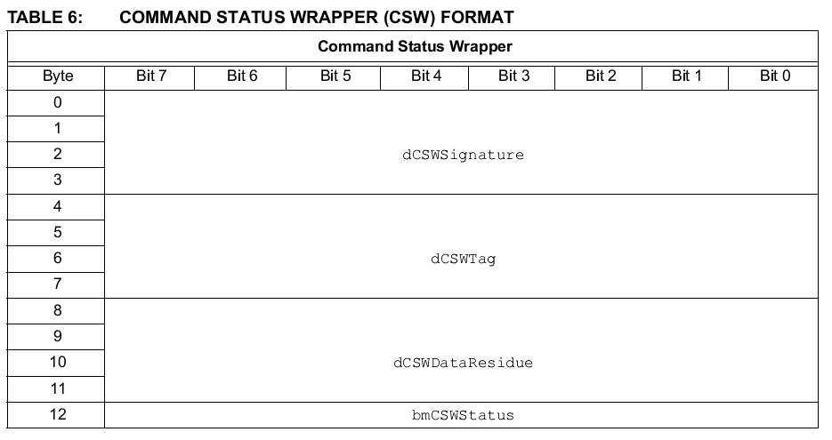

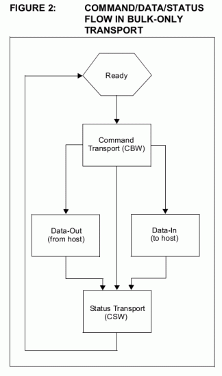

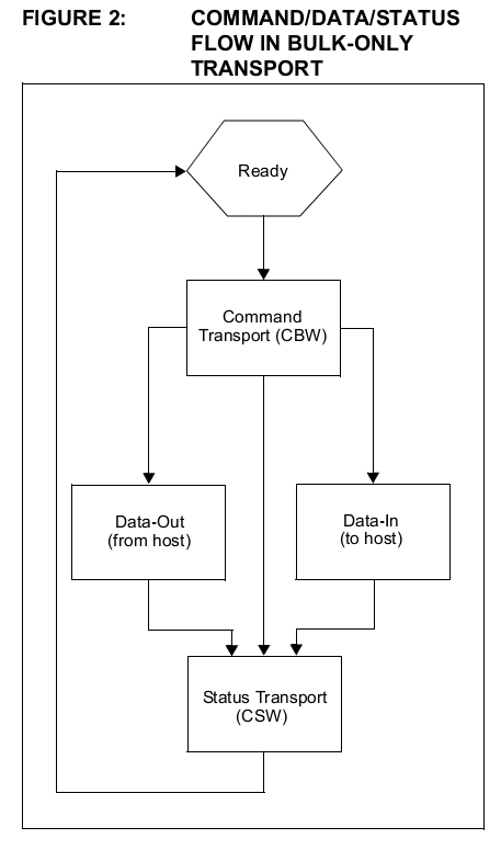

USB Mass Storage Class on an Embedded Device:
http://ww1.microchip.com/downloads/en/appnotes/01169a.pdf
Additional documents in attachments.
usbmassbulk_10.pdf [101.18 KiB]
Downloaded 1050 times
usb_msc_boot_1.0.pdf [77.36 KiB]
Downloaded 1008 times
PostPosted: March 25th, 2019, 17:53
Posts: 992
Sweet! @fzabkar, you are the best at searching and finding documentation. That is what I was looking for, and even if I need to know more, I now have the terminology for search criteria.
:D
