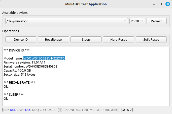

The work continues.

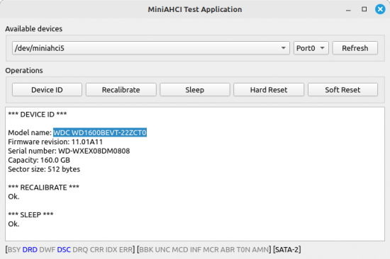

Device ID received. Data transfer (read and write), recalibrate, sleep - everything is working well. The last things are left - software and hardware reset. My test disk drive especially has few UNC sectors for testing that.
I think it makes no sense to implement SMART, there are a lot utilities for this.
It's better to have it all in one place though, especially if the eventual goal is for a stand alone imager rather than just an interface for other tools.

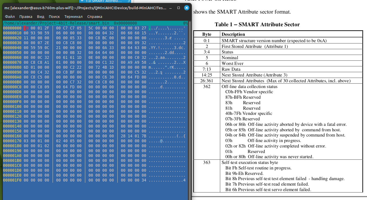

Guys, please point me where to find an actual SMART attributes description. I found the manual from Seagate (Seagate SMART Attribute Specification, March 10, 2011), according to it SMART structure version number must be 0x000A, but my test drive send me 0x0010.

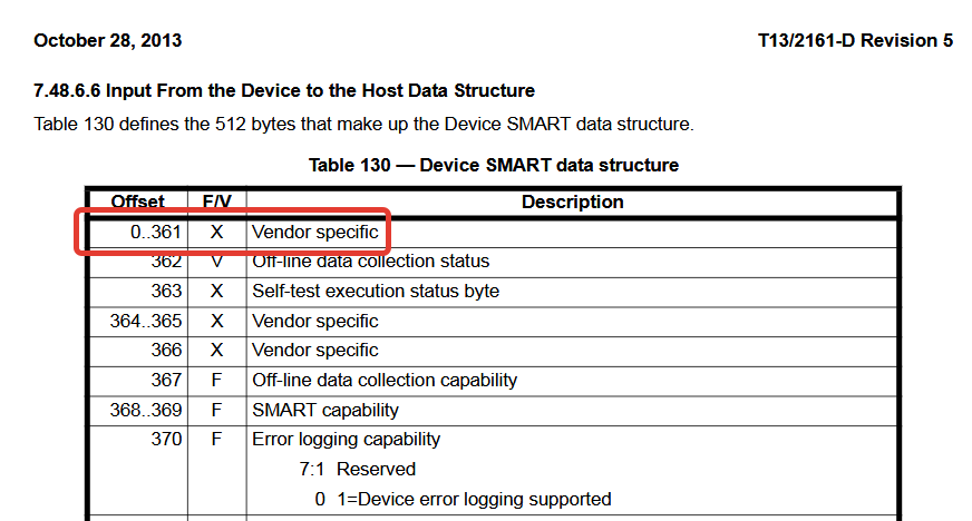

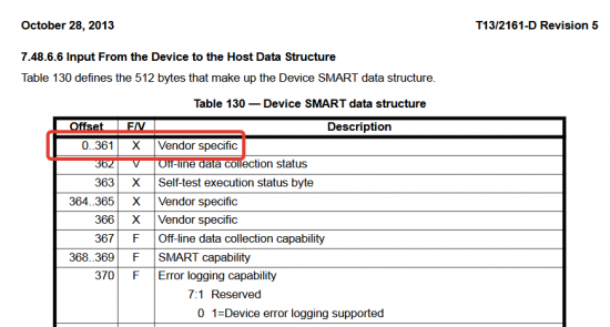

Are you looking at the ATA command spec?

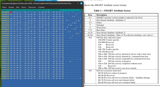

Nope, you din't understood. I have these docs already. Take a look on page 262 of ATA/ATAPI Command Set 3:
Bytes 0...361 are vendor specific, and these bytes are actually contain SMART atrributes. I need an actual SMART attributes description/specification. The Seagate manual that I have seems to be too old.

It appears that you already have this document:
https://t1.daumcdn.net/brunch/service/user/axm/file/zRYOdwPu3OMoKYmBOby1fEEQEbU.pdf
If you are asking for the definition of attribute #n, then there is no standard. Every vendor does it differently, and there is no consistency even between their own models. That why smartmontools has a large database. As for 0x10 versus 0x0A, I seem to recall that WD drives also report a version number of 0x10.

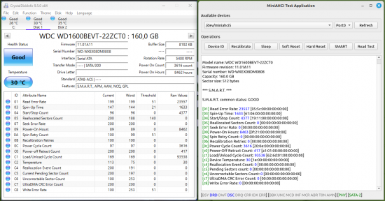

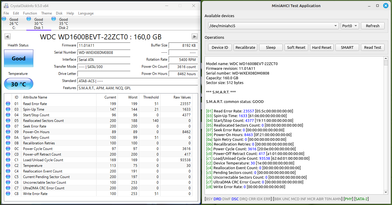

Hooray! S.M.A.R.T. status is implemented. Attributes values are the same as in CrystalDiskInfo.
From this moment MiniAHCI kernel module and QMiniAHCIDevice library are completed. Both placed to my GitHub: https://github.com/aekhv

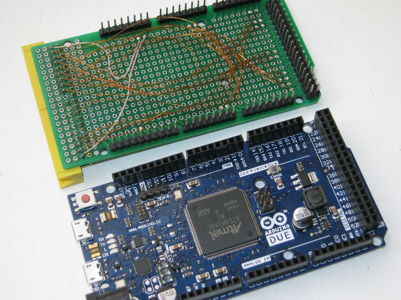

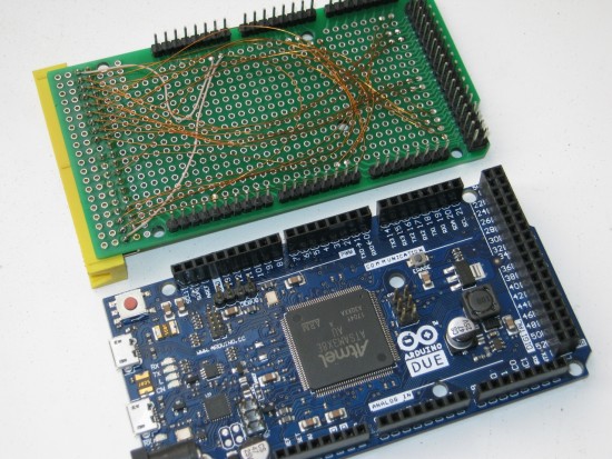

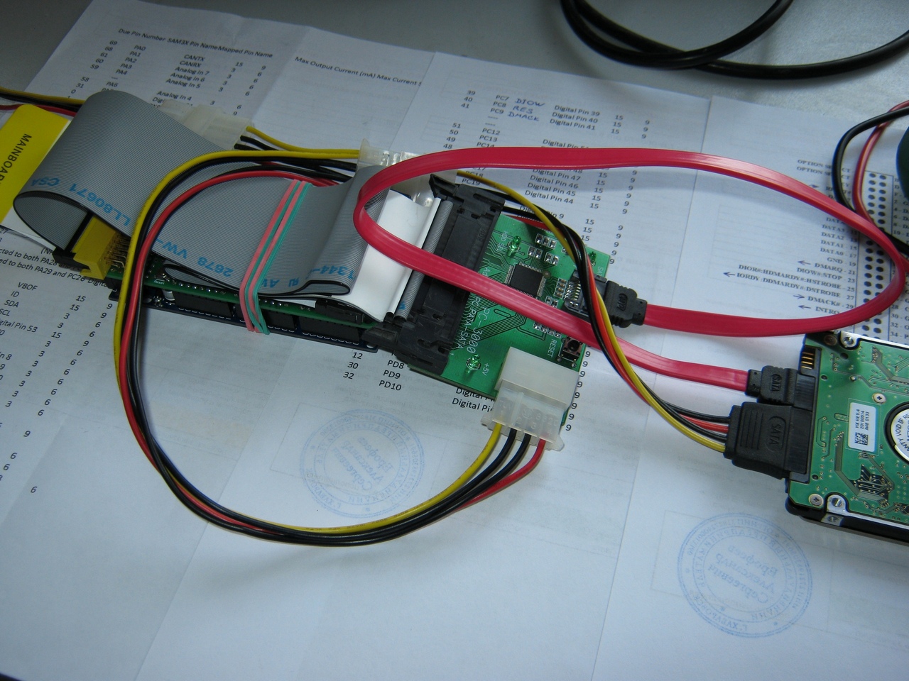

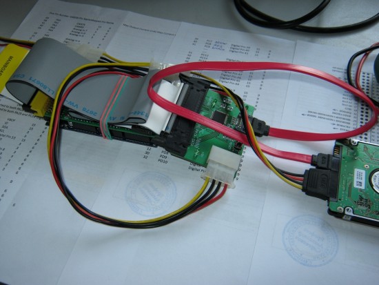

A little history lesson. Five years ago, in 2020, I already did a simple Parallel ATA reader with clone application. The reader device was based on Arduino DUE (Atmel SAM3X8E chip). Unfortunately it's not supports UltraDMA transfer mode, only PIO mode was available (3 MB/sec max).
The clone application was named Easy-Reader. And the video of course:

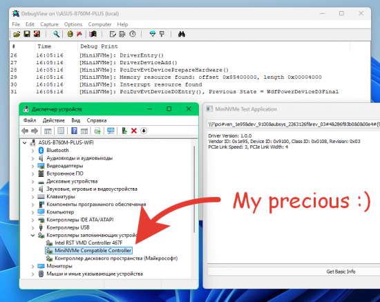

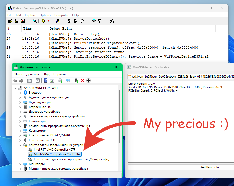

MiniNVMe driver for Windows? Hm... Actually why not? In progress... 8)
