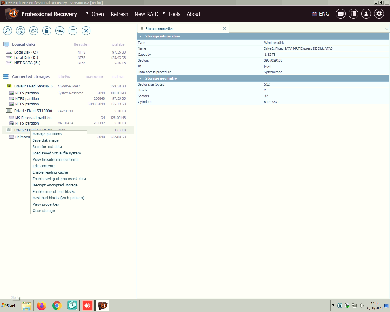

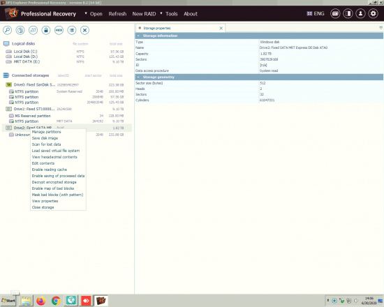

Iurii wrote:
What's new in version 8.2:
* Support of MRT DE Tasks:
Is this option supported on demo version of UFS professional or only if we buy it? I tried on demo and I can't see menu for "MRT DE Task"
www.datasave.ro
 Post subject: Re: New version of UFS Explorer
PostPosted: June 30th, 2020, 8:04
Joined: December 10th, 2018, 11:56
Posts: 169
Location: Ukraine
ccc wrote:
This functions is fully available in trial software mode and doesn't require activation.
Software relies on storage name format to recognize MRT DE mapped storage. There was no mapping for "Express" version. You may now re-download software from our web site once again and check.

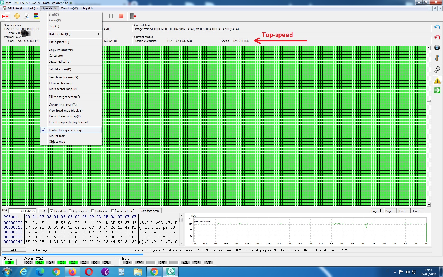

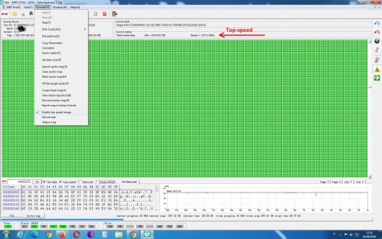

Posts: 1768
Location: Verona, Italy
When i clone directly with MRT DE i can reach 90 MB/s speed, but if i image by using UFS Explorer the speed remains below 65/ Mb/s.
MRT has "Top-speed" function, if you activate it you can reach speed of 120 Mb/s but if you image by using UFS it still stay under 65 Mb/s.
Is this a limitation of demo version or a technical limitation?
My firmware database:
PostPosted: August 5th, 2020, 12:34
I imagine it is partly due to limitations of UFS working with MRT via a mounted task. If you are going for a straight clone of the drive, it doesn't make sense to use UFS. UFS explorer makes sense when MRT doesn't support the file system and you wish to target some or all the files and not the entire drive.
