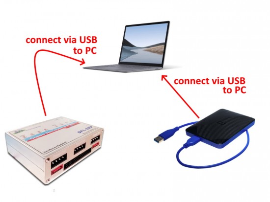

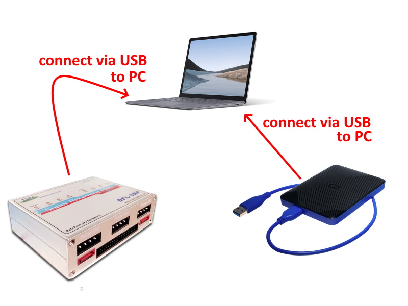

LarrySabo wrote:
I just completed a review of the DeepSpar USB Stabilizer from a DFL-user's point of view. You can read it here.
Hi Larry. I'm quite confused understanding the posting in your website. I don't see any USB port in the SRP, but in the post it said that you're connecting USB drive connected to Windows then to DFL SRP t. Does it works like in this picture?

@bedaone, I just answered your question here, in your duplicate post.
@bledaone, the message you replied to is 4 years old! However, yes, SRP can work on USB drives connected to a PC that SRP is also connected to -- if the USB drive is detected and doesn't cause Windows to freeze. If it is unstable, it would be best to transfer the USB drive's ROM to a compatible SATA PCB and fix firmware issues and clone the drive. The clone will likely be encrypted but the SRP can usually decrypt it directly.
