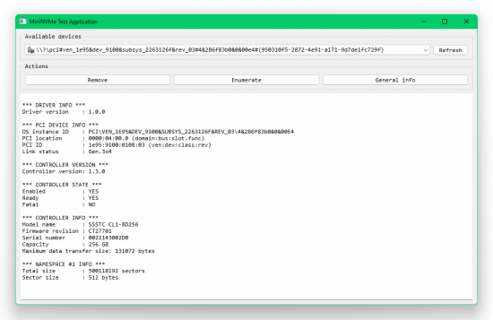

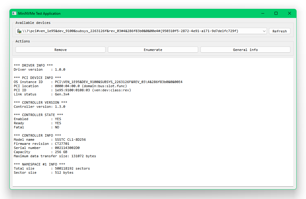

MiniNVMe driver for Windows is almost completed.

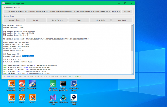

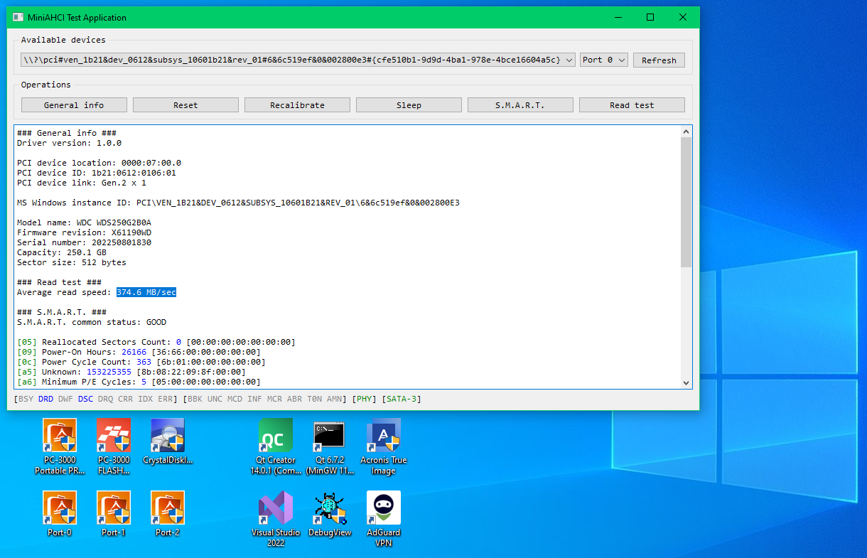

And MiniAHCI driver for Windows is completed too. The read speed of my test WDC Blue SSD attached to SATA-III PCIe controller is something about 370 MB/sec. Not bad!

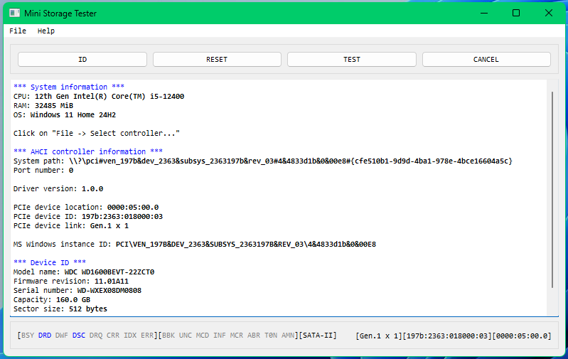

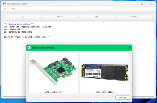

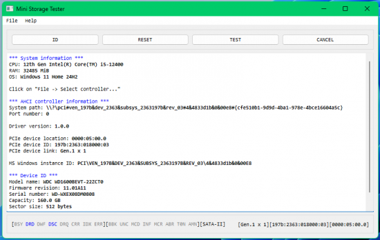

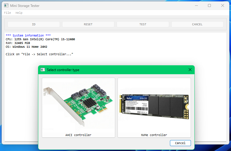

A new project has begun... It will be a cross between MHDD, Victoria and PC-3000 universal utility. For Windows and Linux. Maybe even open source, but I didn't decide yet.
Some planned features:
- ATA security (set passoword, unlock by known password etc);
- ATA host protected area (limit capacity, restore capacity);
- NVMe namespace manager (add/remove/format namespace);
- Standard reading and writing (erasing) with speed display on a graph;
