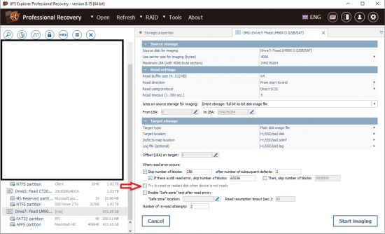

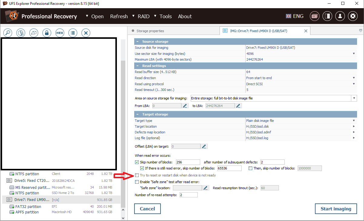

Hello
I come to buy UFS, I sent 2 emails on ufsexplorer.com to ask how to activate the option Try to reset or restart disk when device is not ready, when we copy image
I do not have the answer
Thank you
