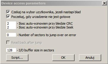

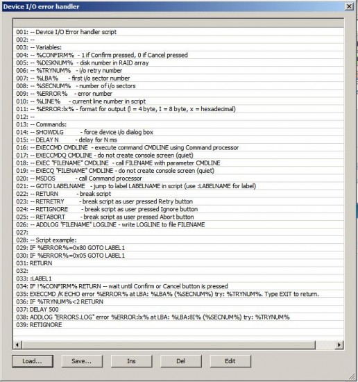

Version 2.1.0 beta
customizable device i/o errors handlers
DMA read/write under DOS
"MultiFile" feature (compile file by $MFT records)
support compressed files when cluster size is less than 4Kb
They carried out construction work on reading maps, which will allow for identification and place of reading errors on the disk (on log).
Are carried out maintenance work on power control of management snap-in so that you can control the power drive while reading - cloning (enable, disable, read parameters, set parameters, current, voltage)
Ability to set scripts read the disk. Images attached.
Where did all these opportunities to connect, I think that it would be a pretty good tool.
