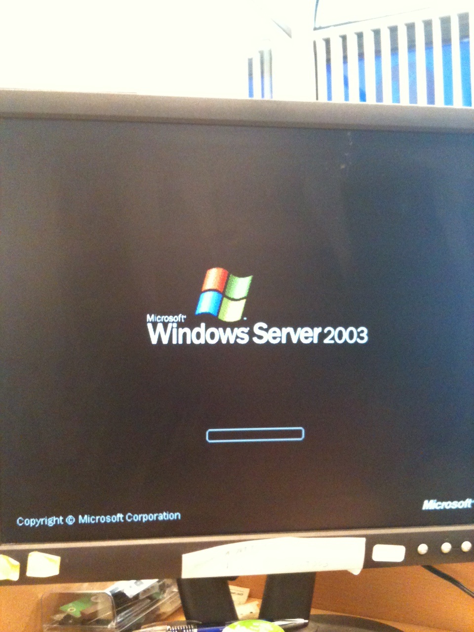

Clients I.T has requested an image of the complete install to try and boot the server install as It had SQL services running when it failed and some corruption may or may not have occurred.
I have a good DSK from the toplevel and I have a romantic notion that it may work.
Using r-Image to lay it back down to a single drive but it doesn't seem to let me for some reason. (greyed out)
Question, alternative to R-Image that will allow imaging back to disk from .DSK ?
Hope that made sense
thanks
andy

Winhex

R-Studio's built-in Copy module.
Big fan of r-studio, could you point me to this feature, I did not know it could do that

Object Copy.
Open the image in R-Studio and copy it to the disk.

R-studio Did its thing :)
Nice trick cheers !
