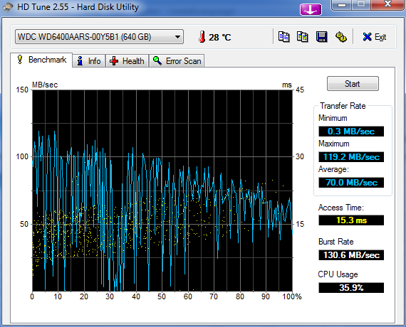

Sometimes my computer runs very slowly and I starded to accuse my hard disk for this situation.
O.K., here is my configuration: MB GIGABYTE MA770T-UD3, AMD Athlon X3 at 2.7 GHz, 2GB DDR2, AMD Radeon 5750 1GB, PSU Chieftec GPS-550.
I used HDTune 2.55 for testing. I also attached a graph where you can see some amazing performance fluctuations.
I wonder if somebody can come to a conclusion just from looking at this graph.
Thanks to everybody taking the time to enlight me a bit. :)

With just one graph and no other data, there are several possible causes (including, but not only, the possibility that the disk is at fault). I suggest that extra info to consider includes:
- What's the history? Any previous benchmark graphs on that system & disk, available for comparison? Anything unusual happened before your computer started running slowly?
- If you now repeat that benchmark a few times, is the shape of the graph always the same?
- What does the full, raw SMART data for that disk show?

Run MHDD and try to make a full scan, you will get more info than the pretty graph of HDDTune.
As Vulcan said SMART Data would be very helpful to point out if HD is healty or not.
You may also use HDDTune in a live windows environment so other software would not
interfere with the disk benchmark.

This looks to be your boot drive?
Windows polls drives often for updates to pagefile, etc. This is what you are seeing, slave it to a system and you will see better results, or as mentioned; use MHDD as it will not poll the drive unless you ask it to with a command.

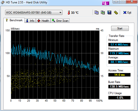

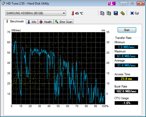

First I thought that the partitions are not properly aligned, and it was true. Afterwards I aligned the drive with Acronis WD Align, but the harddisk is still very slow. So, I wanted to test it in another computer. And what a surprise it was to see the drive working properly, as you can see also from the graph attached here. I also tested another of my drives in the first computer and the graph shows the same performance fluctuations also for this drive.(graph also attached)
Well, I guess that the problem has to be related to some unappropriate bios settings or bad windows drivers.
I will try MHDD, but it seems that the problem is somewhere else here. Btw what options should I use when testing with MHDD? Because i really dont want to destroy the data on the drives I want to test.
Great! That proves the "slowness" is not a disk problem. If you need more help, remember this is not a PC repair or support forum.

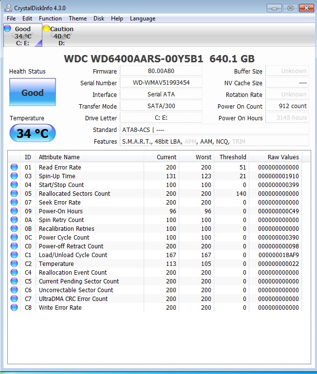

- As for the full raw SMART data, I used CrystalDiskInfo to get that raw smart data and you can see it from the pictures at the bottom of this post.

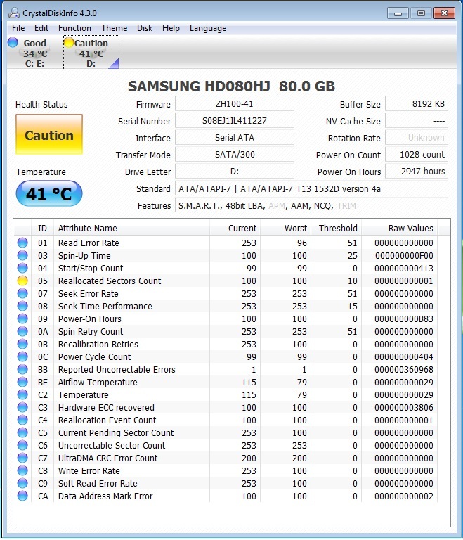

In the meantime I found out that my other drive has some problems, as you can see from the picture below.

Thanks. I see no problems reported for the WD drive, and slight signs of concerns with the Samsung. In order to prevent you being misled by any possible Samsung drive misbehaviour also causing throughput "spikes", I would not use it for troubleshooting your current system problem, if I was working on this. It is like fault-finding using a faulty oscilloscope - it can be difficult to know whether your test equipment, or the system, is causing any problem that you think you are measuring.
