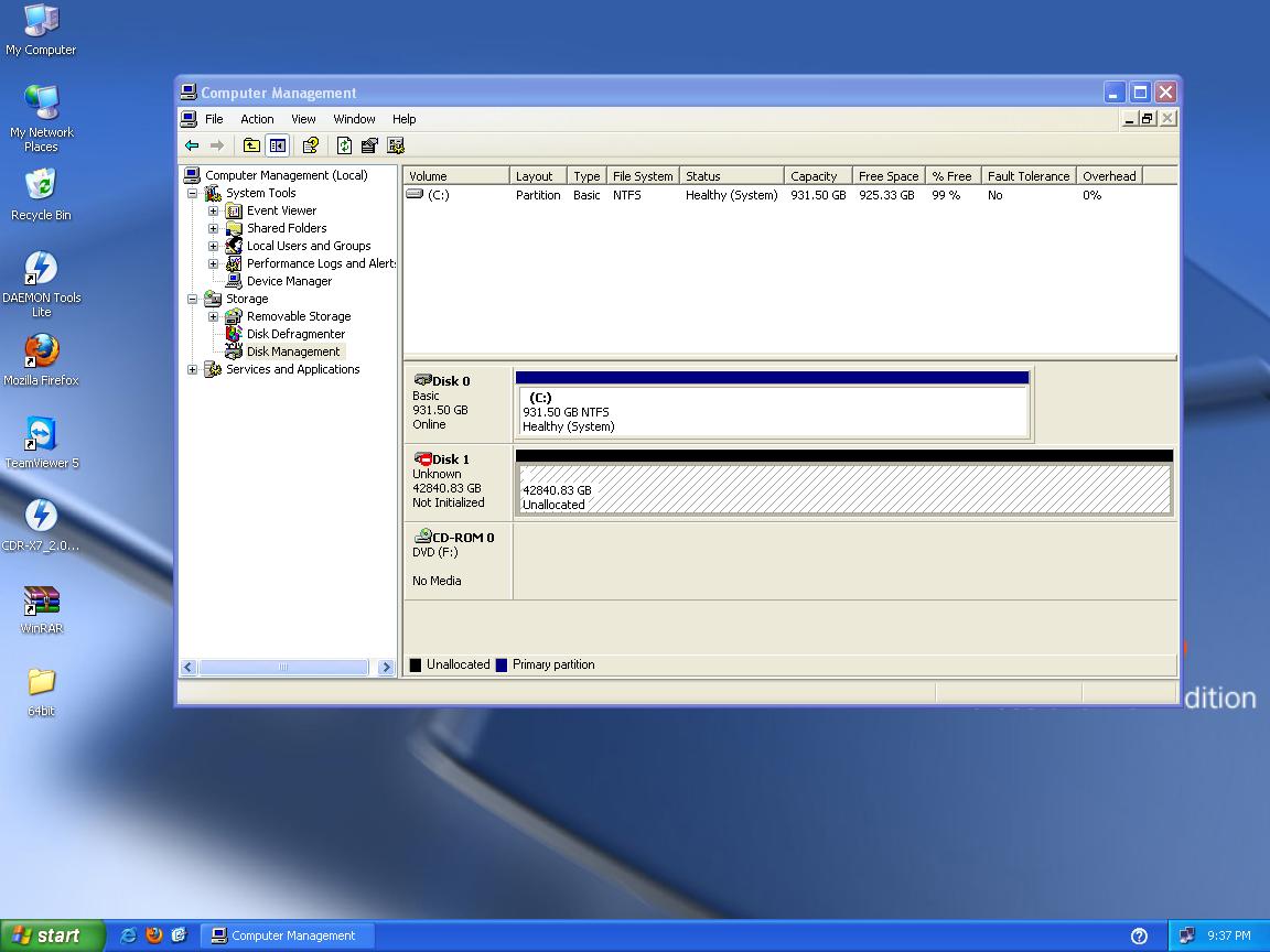

UFS tried by the team, it is not working.
presently it is mounted on 1 TB Windows XP(64).
seems Partition is damaged...similar instance is simulated on OTHER NAS result is same.
Solution either to rebuild the Partition or FILE level Recovery will solve the issue...
Thanks for the Reply.

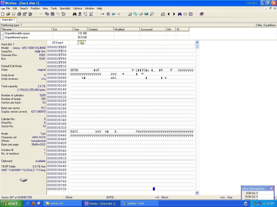

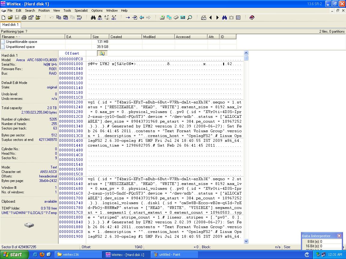

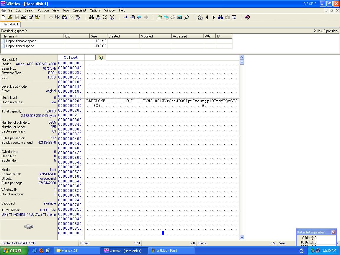

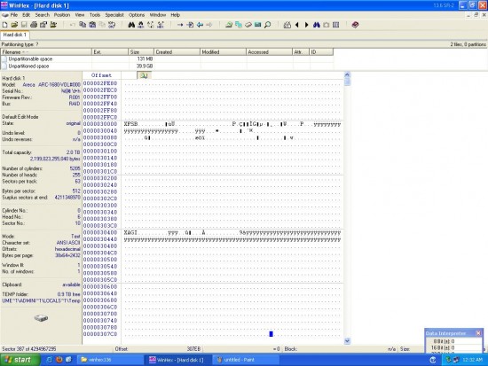

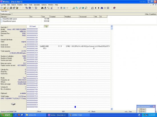

Hi
Problem is simplified attach is Screen in JPG file.
need the help on how to access the same...
Thanks in advance.
File comment: Sector Details
File comment: Sector details
File comment: This contain all the details.
 Post subject: Re: How to Access the 48 TB NAS Linux / XFS system
PostPosted: July 18th, 2012, 3:03
Posts: 2857
I guess there is an Option here, but i tried it long time back.
Use Bootable R-Studio Agent from the machine where drives are connected, and access it remotely
i guess you may start from here
good luck
