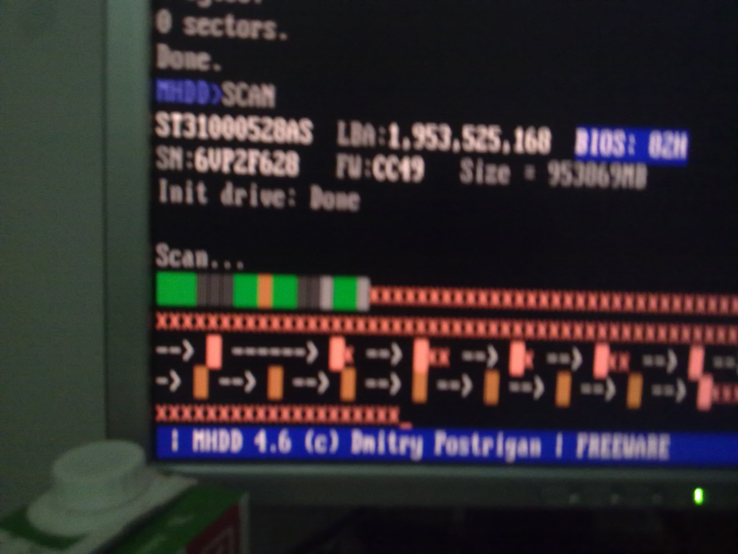

Hi Gurus,
I have just done some tests on a Barracuda 7200.12 drive ST31000528AS which is not accessible in XP/7/Linux.
I have posted below the result of a SCAN using MHDD in DOS. The bad blocks begin almost immediately (before the scan has even reached 0.1 %) After a while I started skipping through.
Could anyone speculate on what that might mean (head crash/firmware/PCB error)?
The only click that can be heard is on powering up the drive one relatively loud clunk / click can be heard. After that it stays spun up but silent. Firmware has been automatically updated. THe drive has also been through a BSY fix as it was initially invisible.
I have another drive, a 7200.11 instead of 7200.12 like the above drive. They have the same model number (ST31000528AS ). If the problem is the PCB, would a PCB change and ROM chip transplant be possible between these two drives?
Thanks for any help.

Sorry answers will not change here. You got the answers on your other post. A DR company with proper tools and understanding of this HDD can clone it to a new one and get off your data. There is no 100% guarantee that all your data can be gotten off and used again. But they can get off as much good data as they can on this drive. They have ways of reading and working with these sectors that you can not do on your own.

Even if I - or someone else - give a technical explanation, will it change anything or get data out ? Remember that BSY is most often a consequence and/or symptom of something else !

You PCB Board will not help you out in fixing a drive with bad sectors. Bad sectors are on the platter of the drive.
The only time a PCB will help is in cases when the other PCB will not spin up the drive. That is it.
You problems needs special cloning tools that are made to handle these problems. There is nothing you can do with out these tools. If you want to fix your drive you can purchase one of the following tools and clone it to get off your data. But remember these tools will cost you a lot more than this will from a DR company who has them and knows how to use them. Sorry

I stopped short of assuming it was caused by bad sectors as in the FAQs for MHDD it says:
"If there is more than 20% of surface is covered with bad blocks, then it is a head crash. If your hard drive is 100% filled by bad blocks — then it is either a head crash, pcb damage or firmware issue."
As my scan revealed 99.99% bad sectors I didnt know which was the cause. Thanks for the diagnosis of the bad platters.
