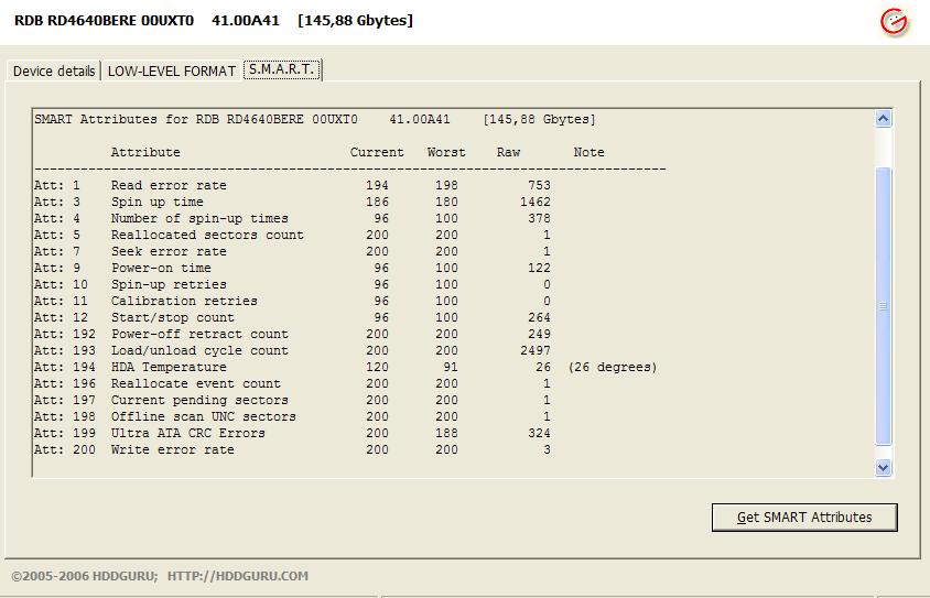

After having connected the drive to a desktop (as IDE Master) , Windows reveals it as 'UNFORMATTED' : the name is wrong and it's impossible formatting it, while, in an USB interface, the disk is right again .
The only thing successfully was the restoring of its original capacity of 160Gb, instead of 130, by means of the suitable command of MHHD. RHPA
Here I enclose the smart report (regarding the drive connected as master ide in desktop)
Donald :D

Hardisk wrote:
I think the Vulcan's hypothesis is right!
My second hypothesis (interface problem), perhaps yes, the behaviour seems to fit that so far. It would be interesting if the interface signals are invalid or marginal (either voltage levels or rise/fall times) when the drive is transferring data to the PC via IDE. Personally, I would be checking those signals individually with an oscilloscope, if the diagnosis was worth that investment in time.
All that behaviour is expected with an interface problem e.g. the filesystem metadata cannot be read correctly directly using the IDE interface (in your case).
I can think of a couple of possible causes, but all are related to different interface problems.
Thanks for that info. Unfortunately, since you used the IDE interface to collect the SMART data, and you can see the interface problem was occurring (the drive make/model is wrong), then:
(a) the SMART data cannot be trusted (it is transferred using the same interface :) ); and
(b) the SMART data does not make sense, for some of those attributes - probably due to corruption caused by the interface problem, when the PC read the values from the drive.
If your external USB enclosure supports the passing of the commands for gathering SMART data (some old enclosures don't support that), you could try gathering the SMART data again with the drive in the USB enclosure. However with everything pointing towards an electrical interface problem IMHO, I don't now see collecting the SMART data as the next useful step. Perhaps pad15 still wants to see that...
Personally, if I accepted the risks of this action, I would carefully remove the PCB from the drive (observing ESD precautions at all times, of course), look at the PCB, and see if there is anything which appears unusual.
As I see it, your options (if you decide to go ahead, and if you accept the associated risks) include:
- just use the drive in an external USB enclosure from now onwards (but don't trust it!); or

Hi Thanks again
This drive is not at all important for me. There are no data to save, but I'm only curious, therefore my post is only a testimoniance that I've appreciated your help and your effort to explain me the cause of this trouble and no more. So I ,m not waiting for any reply to this post! :D
I'll try with another usb interface, able to support Smart attributes.
Donald

Sorry for replying late, very busy week!
My interest in smart data was just a curiosity, I just wanted to see
if the drive was somehow degraded and so becoming slow to come ready.
Some of the data (ultra ATA CRC errors) points to a problem with ide interface,
as Vulcan suggested, and the wrong ID recognized by the BIOS could confirm this
supposition.
I suggest you to closely inspect for broken or bent pin in the ide interface
and to make a scan with MHDD and look for the actual read speed of the disk.

Thanks for explaining your thoughts, and I agree that the SMART data may have been interesting (before it became more likely that there was an interface problem).
pad15 wrote:
Some of the data (ultra ATA CRC errors) points to a problem with ide interface, as Vulcan suggested, and the wrong ID recognized by the BIOS could confirm this supposition.
The problem is that IMHO we cannot trust that SMART data (as it was also read over the same (defective?) IDE interface as the wrong ID!), so we do not know whether the drive is actually reporting any Ultra ATA CRC Errors or not.
Just as an example, for attribute #9 (power-on time), the "cooked" (normalised) current value says 96, and the worst says 100. That is invalid, since for that attribute (and many others which are counters) the worst value should be the lowest value ever reached, and therefore should be reporting 96 or lower, not 100. Therefore I was asking myself: So what is wrong - is the value "96" wrong? Or the value "100"? Or both? With invalid (corrupted?) "cooked" data, then can the "raw" values be trusted either? :shock:
How many of the other SMART values are invalid, due to corruption as they were transferred across the interface? Is that raw value for Ultra ATA CRC Errors actually what the drive sent, or is that also due to corruption? Again, since that attribute is also a counter, I would not expect its "current" value to be higher than its "worst" value - but that is what is shown. Therefore personally, I cannot trust the SMART values shown for Ultra ATA CRC Errors (attribute #199) either.
As you say, checking the IDE pins (that's part of what I meant, when I suggested earlier to check the PCB) is one sensible step. I tried doing a quick comparison between the correct ASCII expected for the drive make/model (allowing for the ATA byte-swapping in strings), and what is actually reported by the host (i.e. received from the drive), and I didn't find consistent bits to be in error. However I haven't spent much time on that (so perhaps I missed something in the data) since, as we agree, a visual inspection would be a good place to start. :)
