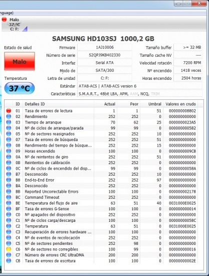

Hi, I would like to know what's wrong with this hard drive BIOS warned me this make a backup and replace the hard drive left aca capture SMART records, which is what I do. The disc remains stable now (Please note that English management) Thanks!

Although I don't agree with everything it says, for starters read this Wikipedia article:
https://en.wikipedia.org/wiki/S.M.A.R.T.
You can see that the main concern for your drive is SMART attribute 0x01 (explained in that article). The non-zero value of attribute 0xC6 may also be giving you a hint about genuine problems, as some sectors are currently unreadable
If you have backed-up your data (which seems to be what you are saying), then now you don't need to care whether the disk deteriorates some more, or not.

Thank Vulcan attention, I have a backup disk, I want to know what I should do with it, the disk is stable at least in normal use copy and paste files, I recommend spending some use to check the status of it? Thank you again!

Unfortunately I don't understand exactly what you are now asking. :( No-one can predict exactly when a disk will fail, and not all disk problems result in immediate & complete failure - for example, poor performance may cause someone to decide to stop using a disk, even before there are unrecoverable read errors.
If you want to use this (likely failing) disk until it's symptoms become more obvious, then you can do that - it's your risk and your choice. :) But beware that you might get zero warning of further (perhaps catastrophic) problems - SMART is already telling you that the disk firmware believes the disk is not operating normally.
That's the best reply I can give, for the questions I think you are asking.
