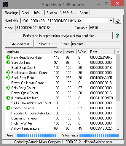

I have received a Seagate Hard Disk of Model ST2000DM001-9YN164 with firmware version HP16. The firmware version code seems odd for the Seagate drive; there may be a custom firmware loaded onto the drive.
I have attached a SpeedFan 4.48 beta 6 window image capture showing the drive Model and firmware code.
The disk seems to work but sometimes make clunking noises that are alarming. I thought that this problem could be resolved with a firmware update and proceeded to download the ISO distribution of the CC4H firmware update at: http://knowledge.seagate.com/articles/e ... Q/223651en
After invoking the firmware update DOS software, the hard disk model is successfully matched, but the update is aborted after a failure to match firmware. I believe the tool was expecting CC46, CC47, CC49, CC4C, or CC4G.
Is there more information regarding the HP16 firmware?
Should all that should be necessary to alter to successfully flash the drive is add the ST2000DM001-9YN164 drive with the HP16 to the flash tools model list?
File comment: SppedFan 4.48 beta 6 window image capture for Seagate ST2000DM001-9YN164, firmware HP16

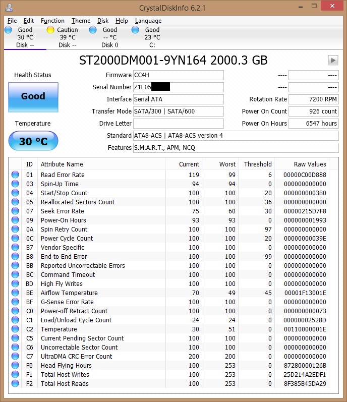

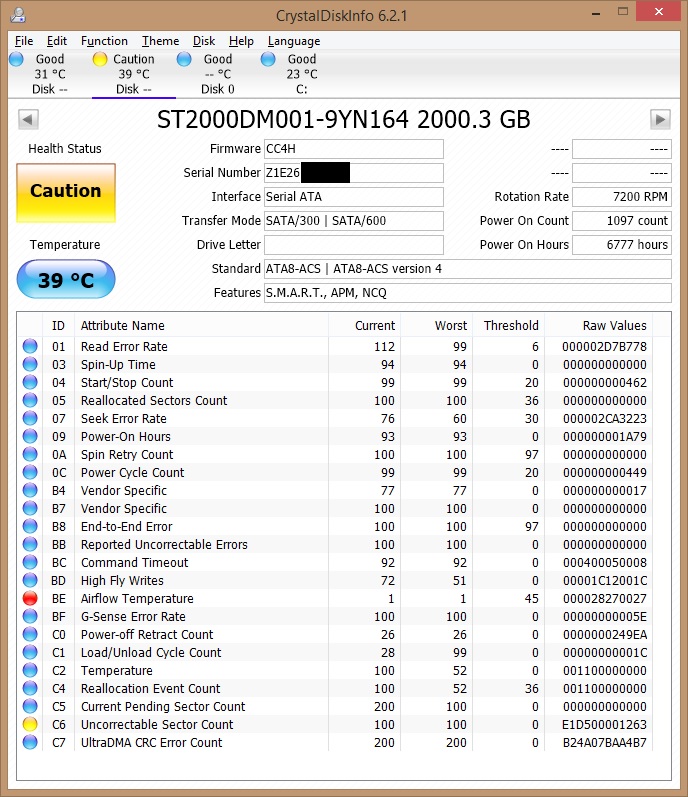

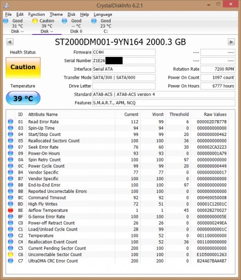

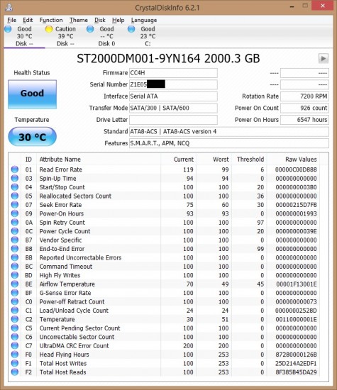

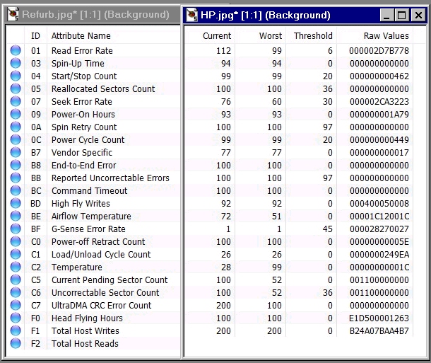

The two drives I have running CC4H are still working. Only one of them had the HP16 firmware. The other was a refurbished unit I got off of eBay and was upgraded to CC4H at the factory.
CrystalDisk does show some issues with the drive I upgraded to CC4H from HP16. I'm not sure if this is related to the forced firmware upgrade.
 Post subject: Re: Seagate ST2000DM001-9YN164 Firmware Update
PostPosted: November 24th, 2014, 15:48
Posts: 17217

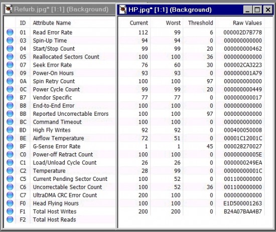

As I suspected, your OEM and retail firmware are incompatible. It may be that normal operation of the drive is OK, but clearly the HP16 SMART module is incompatible with CC4H. :-(
For example, notice that the numbers for the HP16 Command Timeout attribute (BC) actually belong to the following High Fly Writes attribute (BD), and the numbers for the High Fly Writes attribute belong to the Airflow Temperature attribute. That's because the additional B4 attribute has shifted everything down by one.
Similarly, the Load/Unload Cycle Count is actually the Temperature attribute, the Uncorrectable Sector Count is actually Head Flying Hours, and UDMA CRC Error Count is actually Total Host Writes.
PostPosted: November 26th, 2014, 16:01
Posts: 17217
This hybrid screenshot suggests that the drive is correctly updating its SMART parameters internally, but is incorrectly reporting them to the host.
