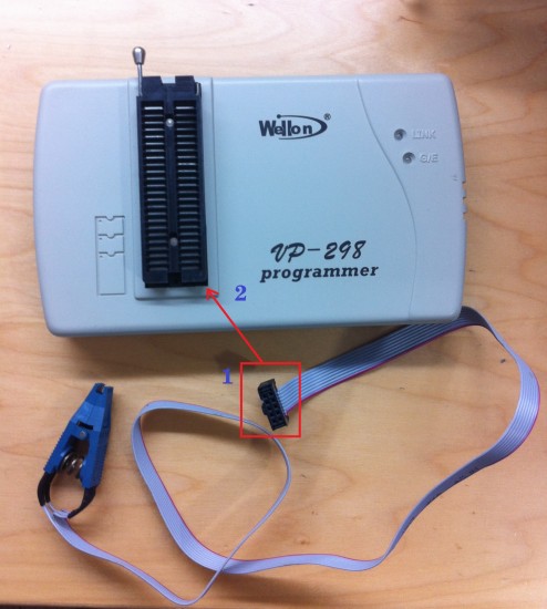

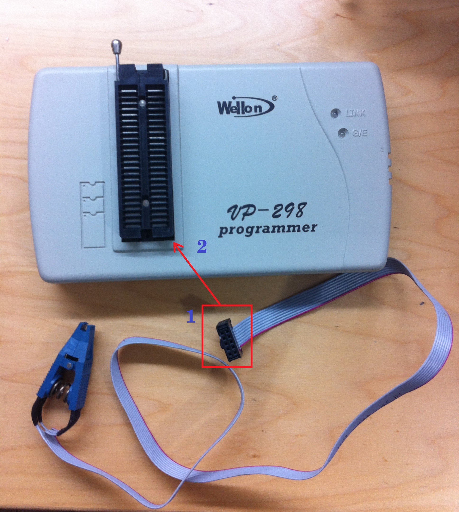

Hii all,
In order to save the need to solder in and out rom chips I bought the following new programmer and it's cable.
I can't figure out how do I connect between the programmer and the attached cable.
Please cheack the attached picture.
The picture tell everything.
* In the picture I numbered the cable by number 1 and the programmer by number 2.
How do I connect number 1 to number 2?
Best Regards,

I guess it's related to DR, so on topic here. Did you not get a jumper board like the one in this picture:
http://goo.gl/hghaa
It plugs into the programmer and you push the connector onto the upward-facing pins.

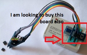

MCUMall sells just about everything programmer related. They have what you need: a 8 pin inline DIP M-to-M header: http://goo.gl/GPLfB
They are in Vancouver, BC.

You could easily make one of these from Radio shack / tandy / jaycar /dick smith or whatever your favourite electronics store is.
just follow the pinout of the chip to where it is supposed to be in the programmer
